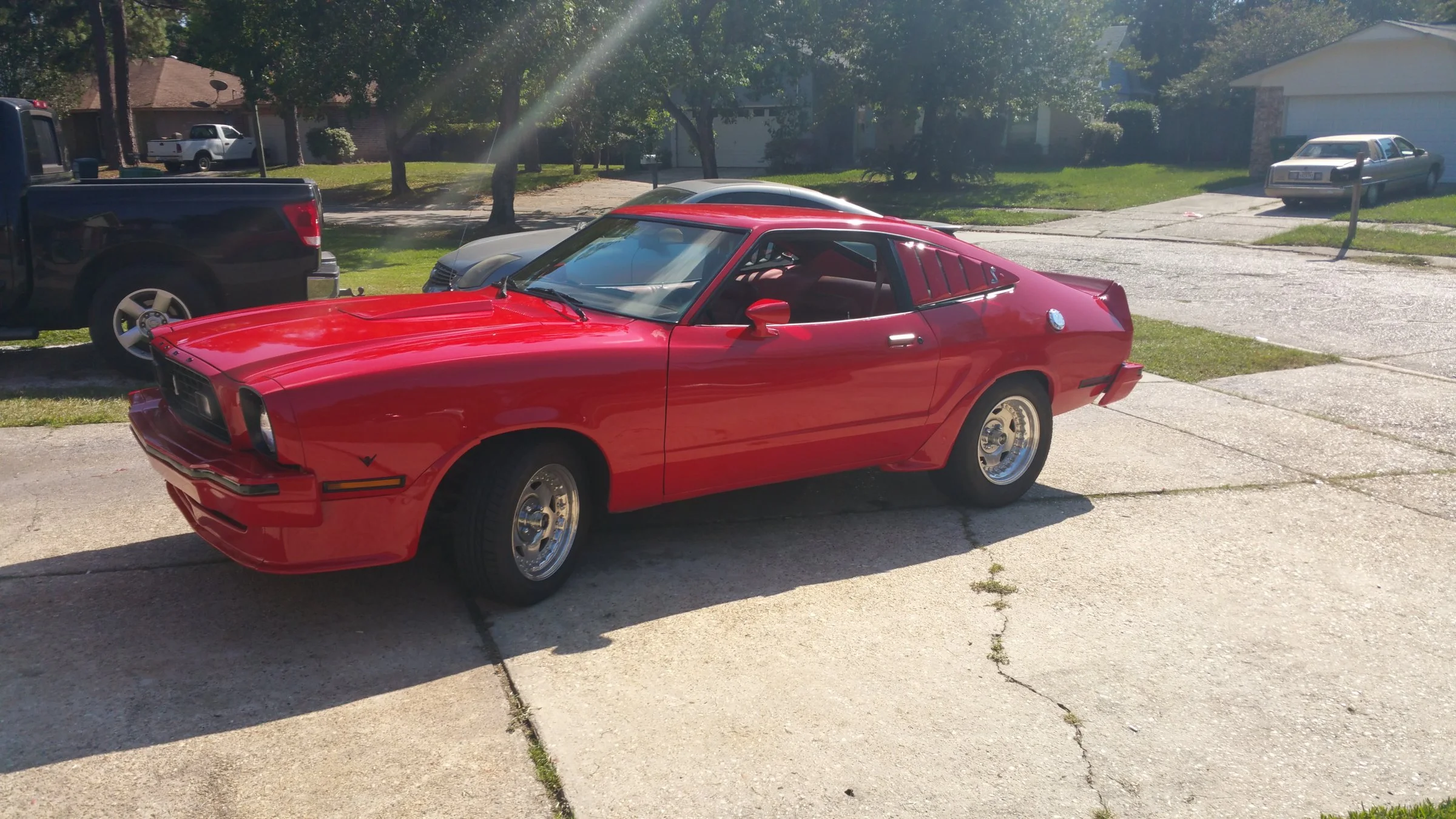

Sharp car!

@lLILCBRA Thank you. I love the black and gold combo on yours.
