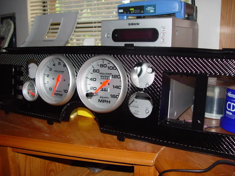

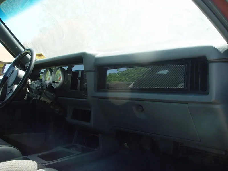

I'm doing the Autometer swap as well, but I'm using the 5" tach and speedo. Using these means the other gauges have to moved out, so I glued a piece of carbon fiber over the factory bezel (mine was pretty bad anyways). The rest of my gauges should be here aound Tues. or so. I had a little carbon fiber left over so I made an overlay for the passenger side and I'm working on one for where the information center used to be. I'll be mounting my boost controller and wideband there. I'll need a pillar pod for my boost gauge, and my fuel pessure is going in my cowl hood. I'm making a tube that the gauge will fit in, and I'm going to epoxy it in the back of the cowl induction area and paint it along with the hood. Here's a couple of pics of what I have so far:
I followed the same overlay idea as above, but used a brushed aluminum finish instead of CF (which looks great, btw).
Hoping to get some installed shots soon; the car is away getting some more work done to it.
Yours looks good too, I was going to make one out of aluminum but since I have the Ultra Lite gauges I figured it would look kind of bland.
Hissing Cobra I paid around $50 for the piece of carbon fiber, but I bought a big piece in case I messed up. You might get by cheaper than that.
N8miller I don't think I could do them in a timely manner, working full time and painting cars on the side kinda keeps me busy! So I'll tell you how:
Take a piece of paper that is large enough to cover your gauge cluster, and use a pencil or crayon to color over the paper. You want to kind of press down because you are trying to get the image of the cluster to transfer to the paper. Once that's done you can lay out your new gauge holes on your pattern using a different colors so you'll know what to cut out. Then you can transfer your pattern to whatever material you want to use and cut it out. I didn't cut the new holes in the cluster until I had epoxied the overlay on, but I guess you could do it however you want.
You could use any material you want, the carbon fiber is going to have a checkered pattern. You could do it with aluminum or sheet plastic, or whatever you want. You could even paint it body color if you want. Like I said initially I was going to go with aluminum and then engine turn it (like older Trans Ams) but w/aluminum gauges I didn't think it would look good, but it's all up to you.
