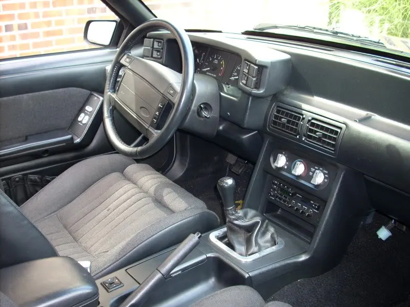

-dash board making noise, those stupid mounting tabs for the gauge pod, have made replacements, doesn't hold dash board tight.

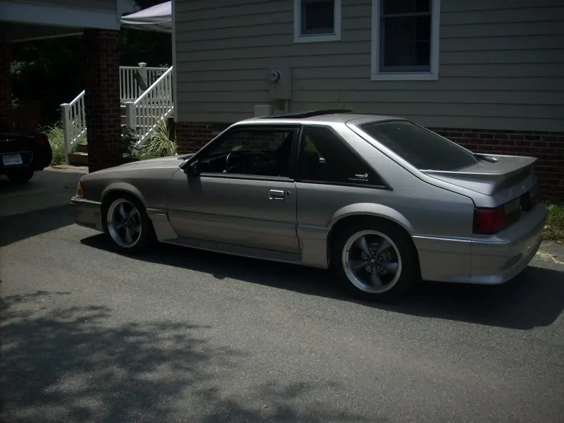

-really bad fox body lean. typically a quarter inch lower driver side in front and at least a half inch lower driver side in the rear, and that's with the adjustable control arms about a half inch higher on the driver side
-i rear ended someone a while back, need front bumper painted, and finessed in there to fit right. might need new header pannel, ect

i am/was in the same boat. i did my interior, engine runs good, i have actually just been driving and enjoying my car. i put myself through hell a few times that nearly cost me the car, it was doing unnecessary stuff too. i got a wild hair up my ass to do cobra brakes, it was a nightmare.

We always want what we don't have. It seems like we only appreciate what we have for a while and then it fades somewhere and then we need some other reason to be happy about our rides or anything really. Your mustang is so clean in comparison to many i have seen yet to you, you mainly recognize what it lacks. What is bugging you the most, you only know, and I say to rectify the thing that bugs you the most, sounds like the front clip. There's nothing stopping you from driving it across the US as it sits right now unless you know something about it I don't. To me a fox is one of the most reliable cars on the road...
