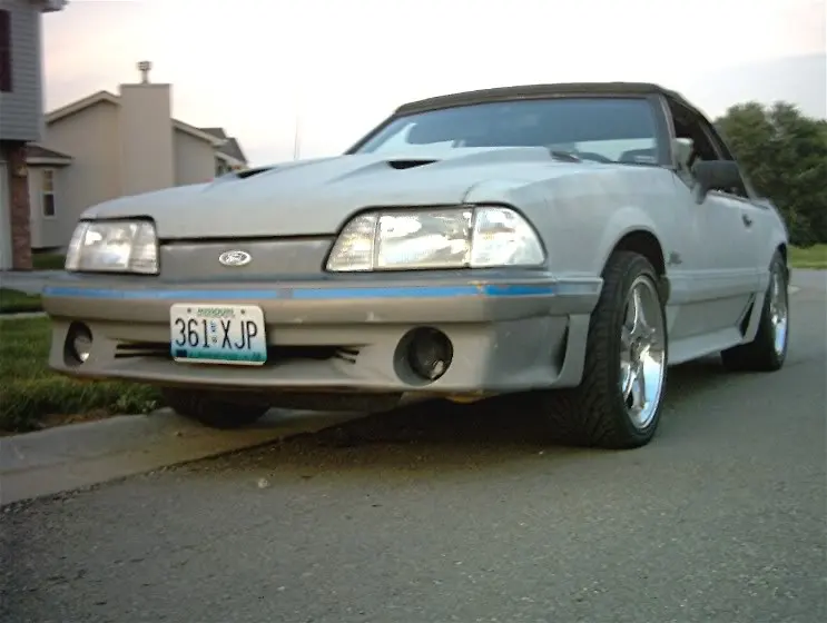

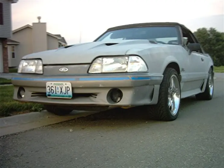

I need to get a picture from the back to show the tire width, but here's the best pic I have for this...The wheels look much wider in the back on a LX (no ground effects). I had them on my old 89 lx 5.0 hatchback...and they looked beefy from behind. I wish I could get 17x10" in the back with no other mods that would be awsome :flag:
