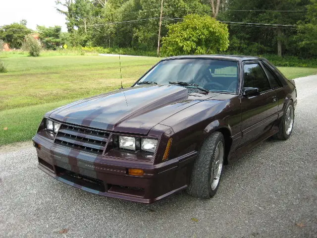

I have built an 82 gt with a Cobra IRS, I am trying to find out what e-brake cables will work with the 82 ebrake assembly and the 2001 IRS. I have purchased a few different sets and none seem to work,
you guy's know anything that will work...thanks, ron
