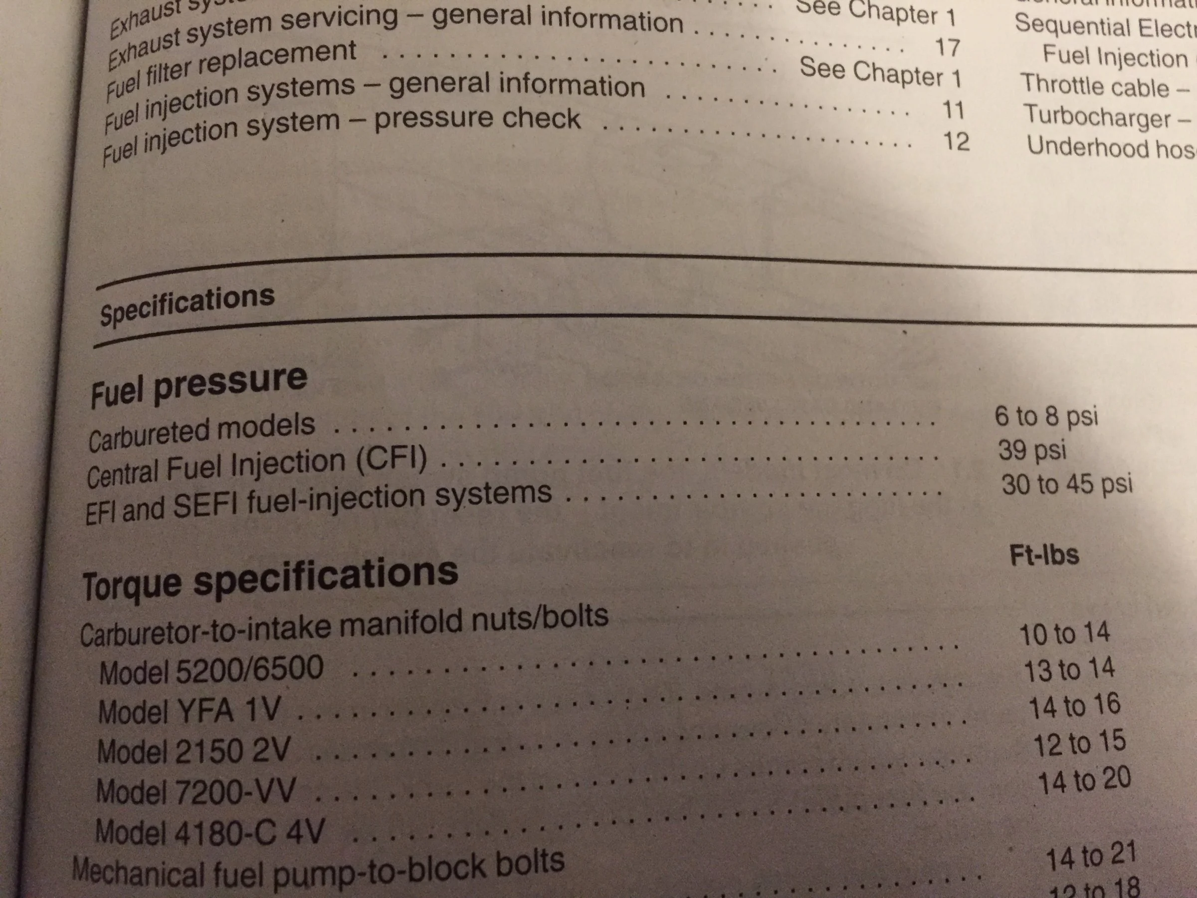

J junkyardjeff Member Aug 17, 2016 28 6 13 Mar 22, 2017 #1 Mar 22, 2017 #1 Trying to find out the fuel pressure for a 84 3.8 TBI,its at 45 with the motor running and wondering if its too high since my code scanner brought up a code for being too rich.

Mustang5L5 That is…until I whipped out my Bissell Mod Dude Feb 18, 2001 43,249 17,934 224 Massachusetts Mar 23, 2017 #3 Mar 23, 2017 #3 If if the fuel pressure was two high, the two injectors in the Throttle body should limit the duty cycle of the injector to lean out the mix. What was the exact code number?

J junkyardjeff Member Aug 17, 2016 28 6 13 Mar 23, 2017 #5 Mar 23, 2017 #5 It has a few codes and 86 for being rich and also has 31 32 33 34 and 44 but most of them are for a inop thermactor and EGR systems

Mustang5L5 That is…until I whipped out my Bissell Mod Dude Feb 18, 2001 43,249 17,934 224 Massachusetts Mar 23, 2017 #6 Mar 23, 2017 #6 So the 3.8 liter is officially referred to as "CFI". Spec would be 39 psi Code 86 means "adaptive limit reached:RICH" So I think you are on the right track that you might be a bit rich
