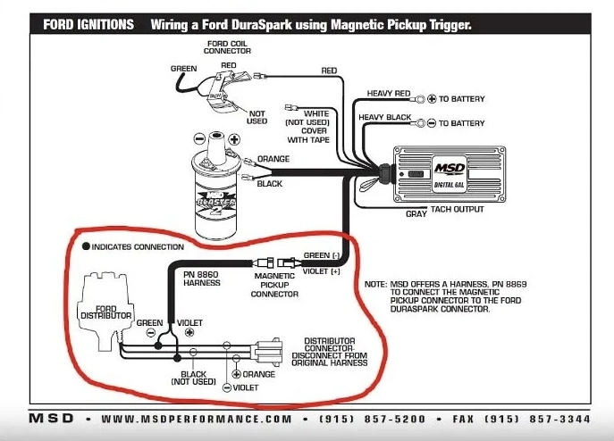

DienstXIV said:
I'll get one of those vacuum pumps at Harbor Freight tonight. You got any idea what the 2 or 3 wires going into the side of the distributor do? I really think it's more of an electrical issue with something and it's something that's happening that I don't know about. I unplugged the vacuum line and revved the engine up to 2000rpm and then did the same thing with the vacuum line plugged in and the advance was much more with the vacuum line plugged in.
The “two or three wires” are for the magnetic pickup. They plug into the Ford Duraspark ignition box or an aftermarket ignition box like this:
