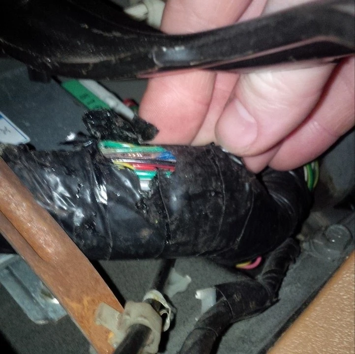

Well you have some issues there.
go thru and fix all of the exposed wiring.

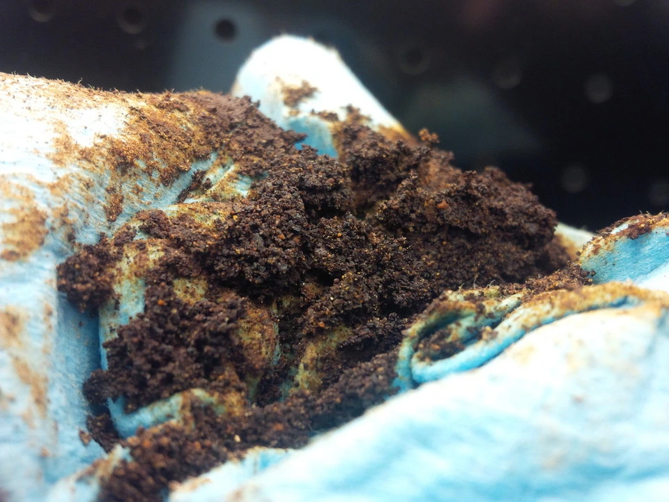

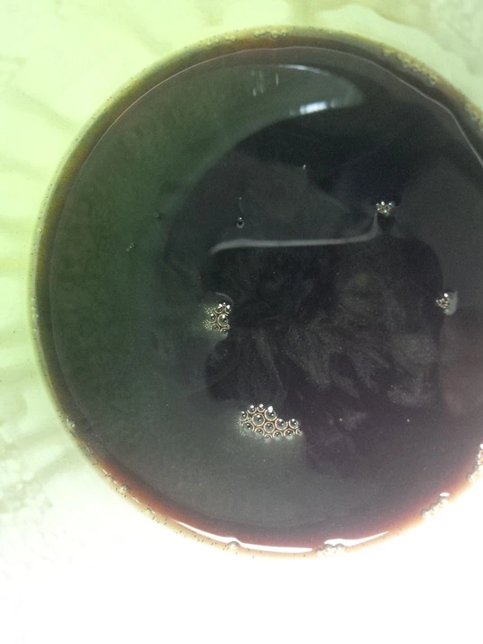

There is an autocross Saturday I'm hoping to make. So I changed my power steering pump. Turns out it is a 2002 Ford Explorer V6 pump. Haven't started it yet to see if it works. Here is the old fluid

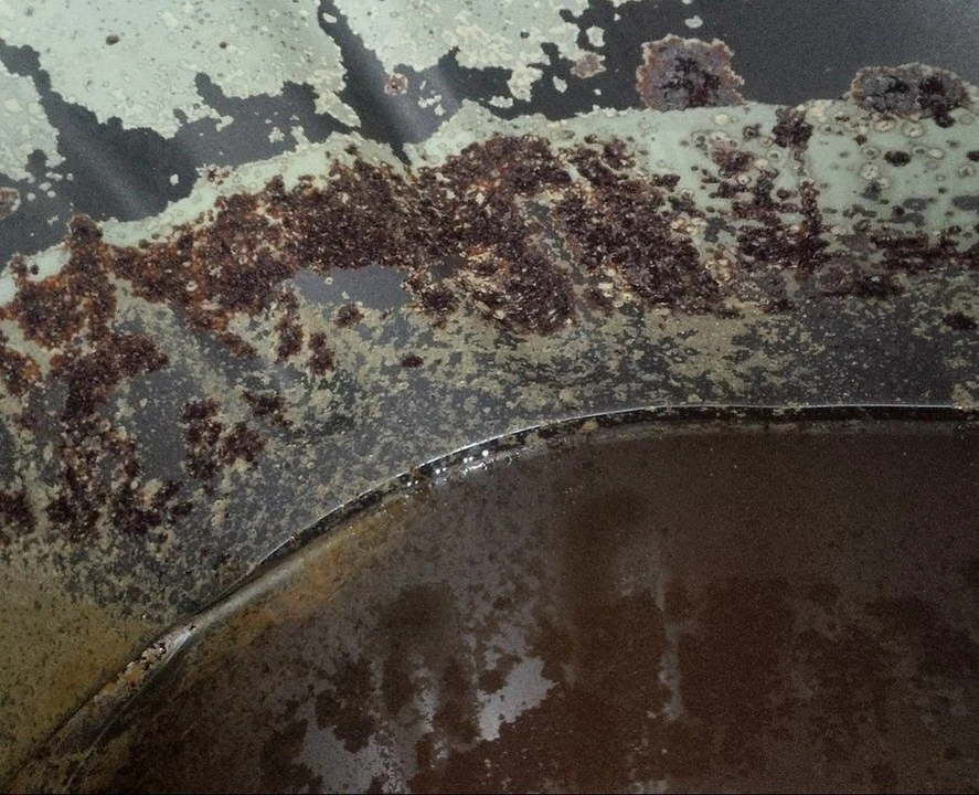

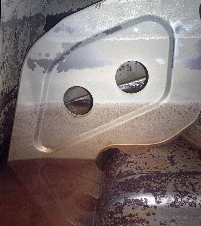

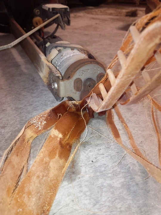

I haven't been driving it because of the dirty fuel issue. I removed the fuel tank access panel and holy :poo:.

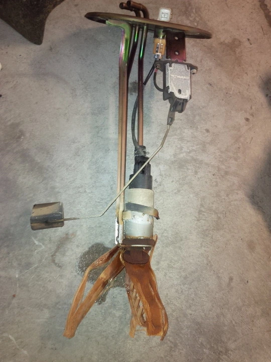

fuel pick up is ...
Inside the tank
And here is what I wiped off the bottom after pumping the tank dry.
I thought it was a rusty tank from sitting for 3 year. However, it doesn't seem that way. Somehow a lot of dirt has found its way into my tank. And that's not nice.
The crap in your tank clogged your fuel injectors
You're right on that! I suspected the misfire/no start issue was related to driving the dragon. Maybe the old fuel strainer was stiff from sitting with an empty tank. Then gas sloshing around broke it. Oh well. Eventually I will remove the tank and clean it. I work at a chemical company and my boss said use Metal Etch (our stuff) because it will remove both rust and dirt. Not sure what the active ingredients are but I know its not phosphoric acid so it won't leave a coating on the metal. Replaced the fuel filter last night and put a new strainer on. Now it's getting clean gas.
