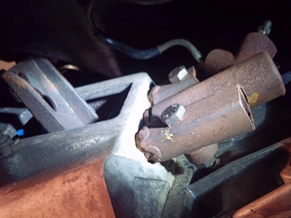

Hey guys a bit off topic but if you ever decide to go hydraulic clutch here is how the builder did mine. I remember once we were going to drive my buddy's 500hp fox up in NY (it had a small fire earlier) and when he pushed in the clutch, pop! Cable snapped. Anyway, there are a few different ways to do the slave cylinder bracket, just search miata t5 clutch etc.
I guess it was easier to do this than swap in a cable setup. Not totally sure.
A new hole was drilled further down the fork to prevent slave shaft binding.

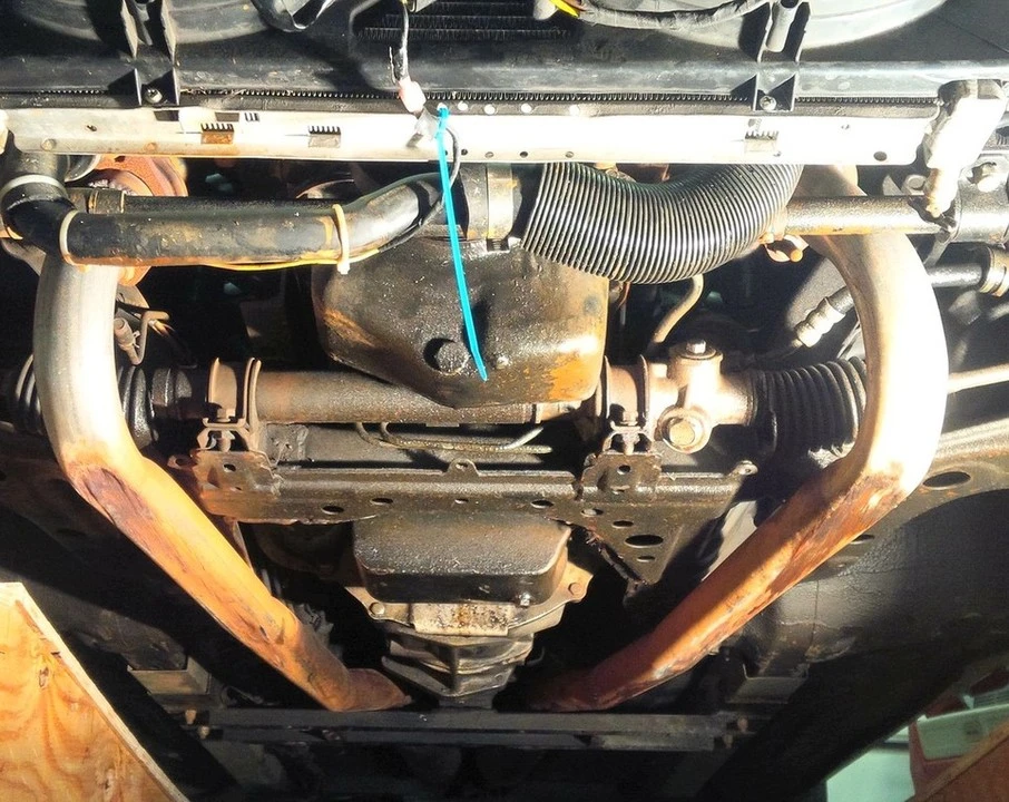

Slightly more on topic is low profile oil pan. Due to the sub frame I don't know, dry sump may be the only option. Reason for this is impact marks on the pan. The car doesn't have adjustable coil overs yet (bilstiens are still on the parts car awaiting re valve) or I would raise it for more clearance.

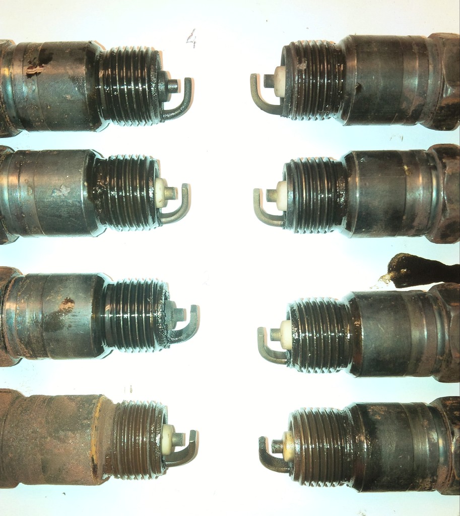

Plugs
cyl 2 and 4 are black with deposits. This cyl bank also puffs white, at least on cold start. Cyl 6 leaked a small puddle. Occasionally it misfires (every few seconds) and feels hesitant at light throttle. I believe most of the issue is exhaust pipes flattened in half under the subframe.

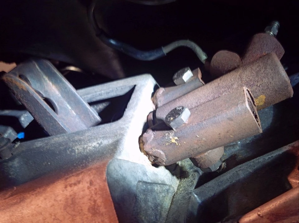

Today I did what I should have done a long time ago. Fired it up and pulled injector wires while listening to the engine. Turns out 4 and 5 aren't working. Got a loaner noid light tester and, to my amazement, they were getting pulse. Now I'm at the parts store swapping out those injectors. If you have a misfire, check your injectors!
I wasn't able to test plugs 7 and 8 due to the intake manifold. Any suggestions?

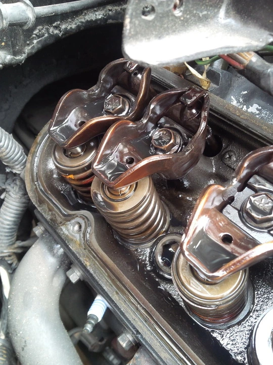

What are the chances an intake valve is stuck shut? That would explain the gunshot backfires...

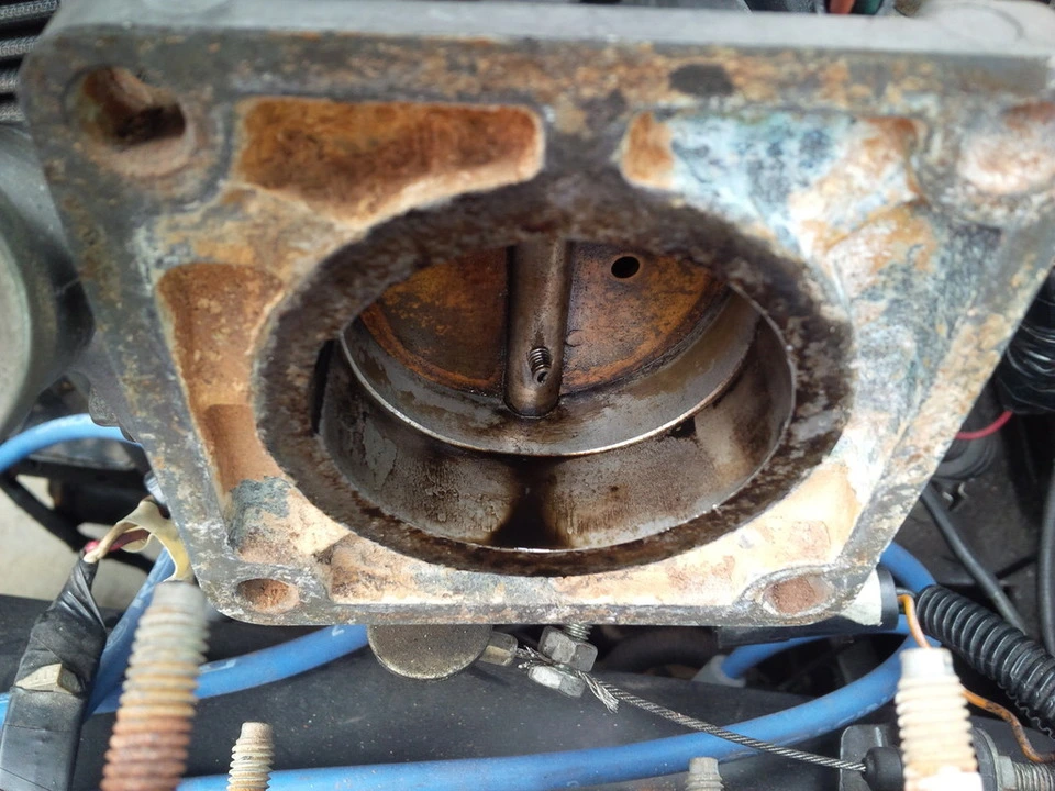

Decent amount of oil in the throttle body, guess i need a catch can. This can't be normal. Piston rings shot?

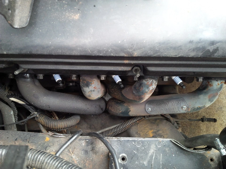

Looking at the headers it's plain to see #4 is not firing.

They are stock replacement motorcraft. 4 and 5 are dark from the plug wires being swapped. The rest are ok except #2. It's nasty but not sure why.
Pretty sure it's stock HO cam and definitely HO firing order.
