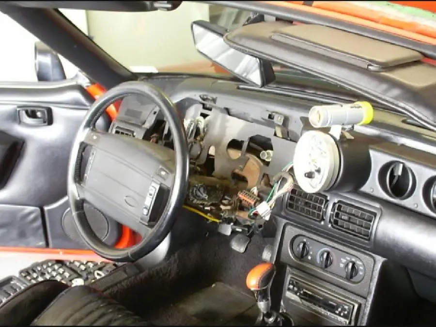

I'm about to install a white face gauge kit in my car. I've recorded all the needle positions and I'm ready to take off the instrument panel.
What exactly is involved - where to start? Do I need to remove the headlight switch to get to the screws?
any help, tips, instructions (87-89 specific) would be great. I've come across many sites offering step by step instruction, but only for the 94's and up. I figured the kit I bought would have some instructions - and they do - but they are just basic, universal instructions.
thanks again
Don't think you need to pull out the switches, but you may want to anyway becuase you'll want to unplug them to take the whole thing out anyway, and it's easier to do it first. You'll also need to take out the knee panel under the column to get at the lower screws. All pretty straitforward, let us know if run into any hitches- good luck.
I installed mine, I took the switches out. I belive they have to come out, and yes they just pop out. I also took the lower part of the dash off to access some of those screws. Then you pull the instrament panel out a little then dissconect the two plugs, then they spedo cable. To remove the speedo cable you just push on the on the flat side of the connecter, their isen't alot of room but mince came off pretty easily. The panel should come right out after that. And remember to hook up the spedo cable first when you reinstall your cluster. If you have anymore questions just ask
there is 2 screws on top of the cluster near the windshield, and I'm going to have to take off the steering wheel shroud to get to the others.
I can get one side of the switch's out, but no farther. Is there a trick to getting the headlight, foglight switchs out? It feels like they are going to snap if I put any more force on them.

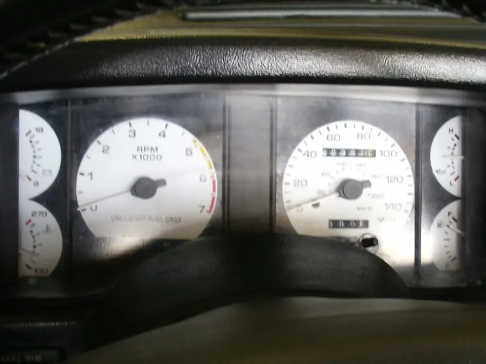

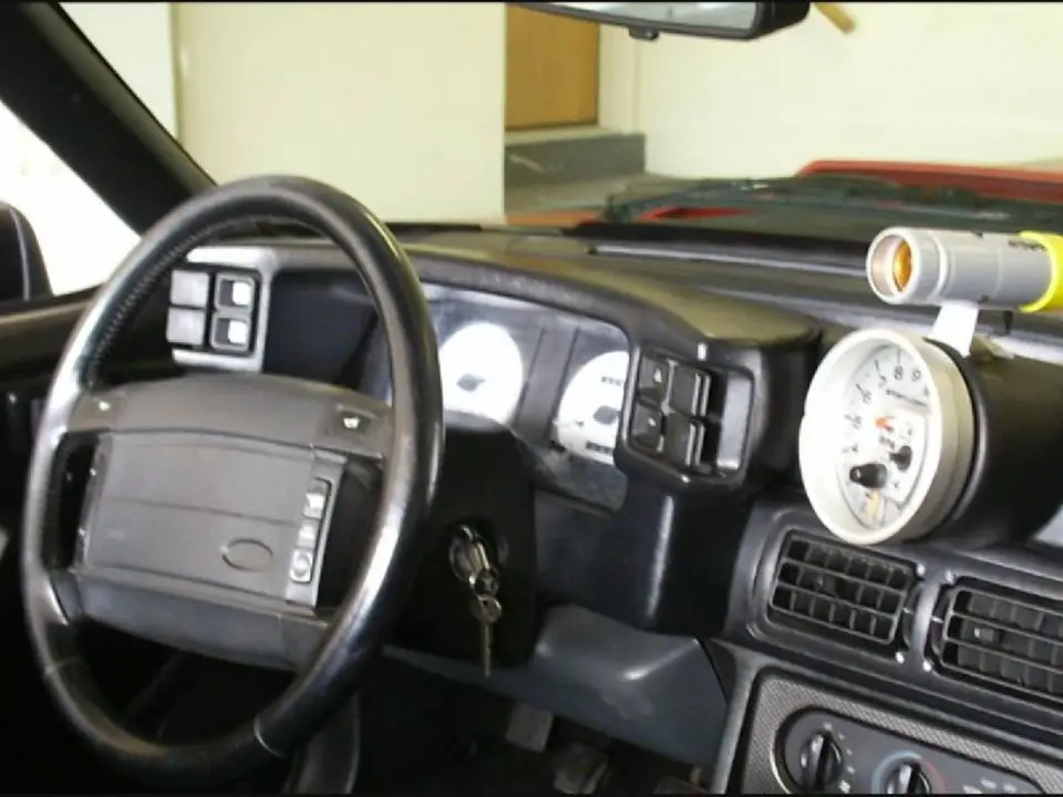

hows my gauges look? yes headlight and fog switches must come out then black bezel then clear cover then remove the screws holding cluster then remove the connectors from back of gauges and remove speedo cable. pretty tight when i did mine! use small jewelers screw dirver on swithes look for detents to press to get them out!
Sweet!

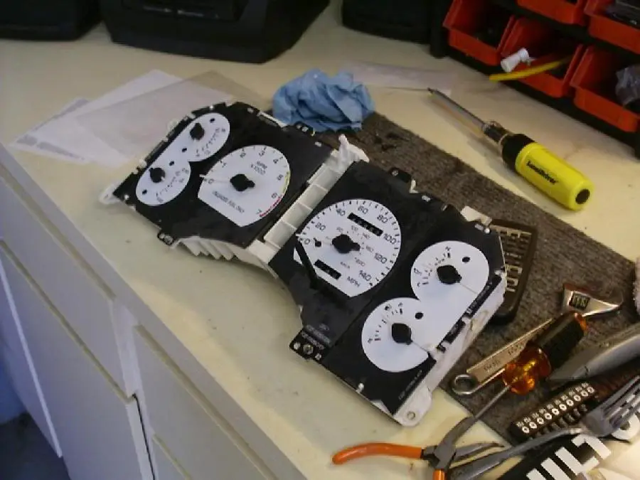

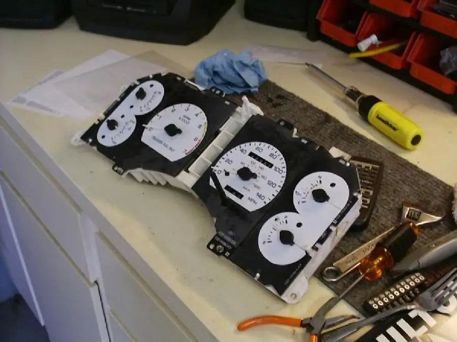

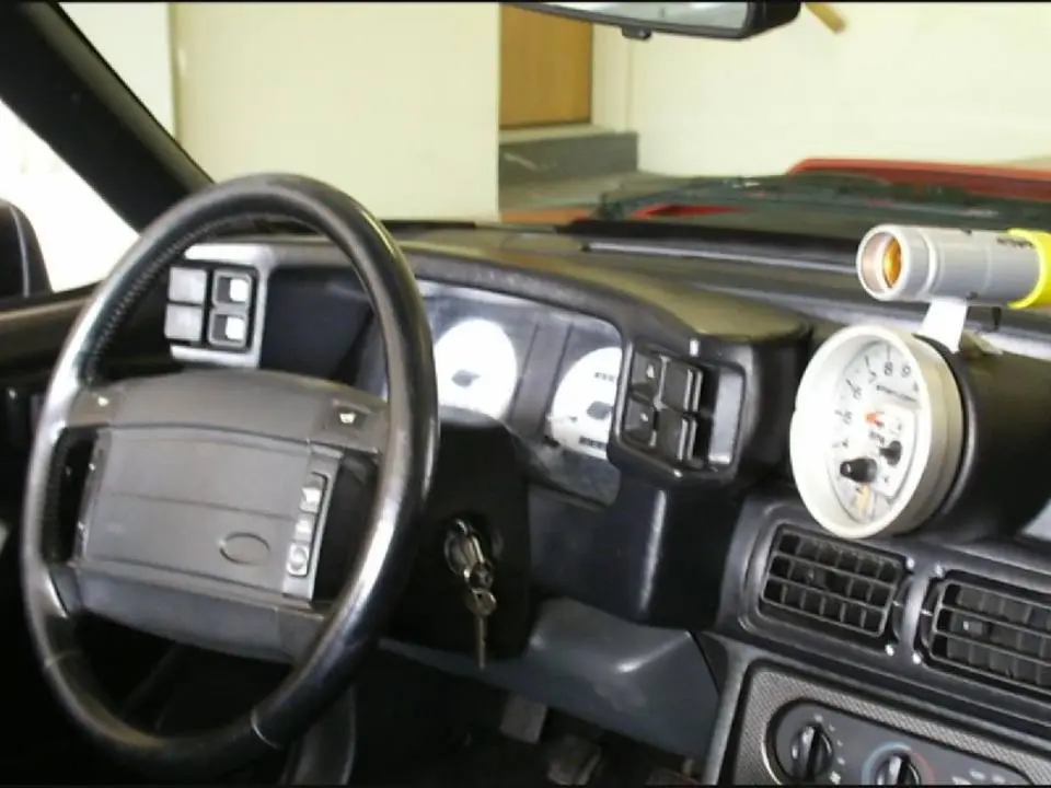

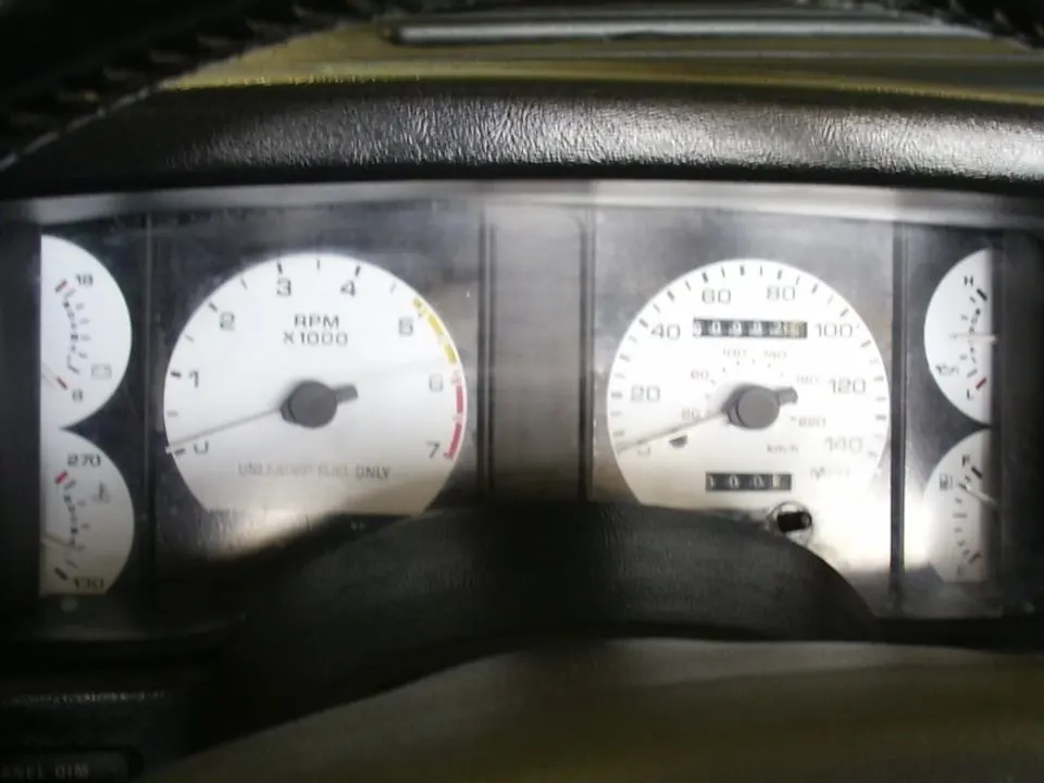

Here are my gauges, $20 off ebay..sorry about the big pics. I didn't feel like resizing them
