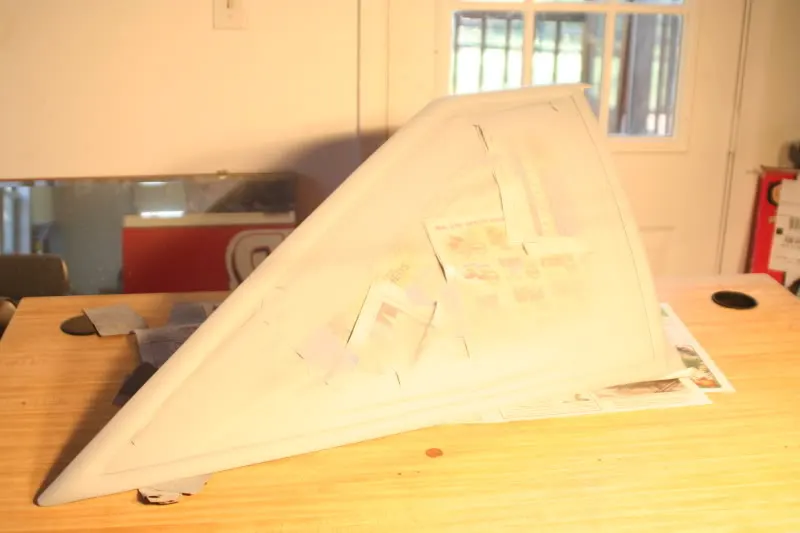

Do you have pics of your progress? I'm curious to see.
Here's one. I've painted the windows now, and put on a clear coat. I don't know if I did the clear too soon, but the paint in one corner rippled up, so I need to sand it down and paint and clear it again. I'll try to remember to post a picture of that when it's done.
