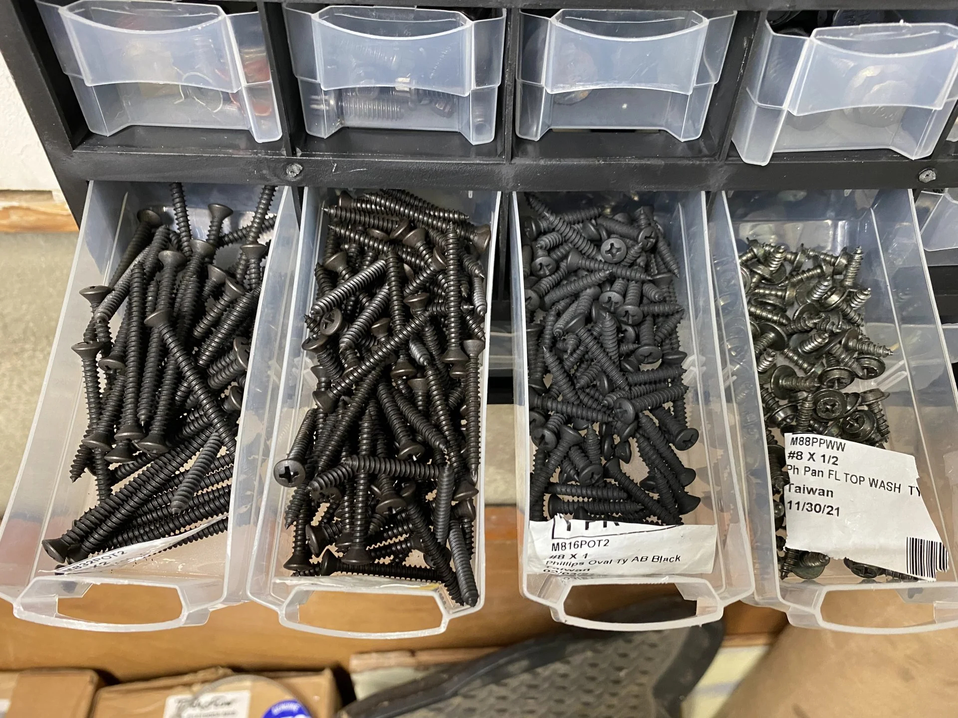

When I redid my interior, I replaced all the screws. The vast majority are #8 phillips oval head screws. 2”, 1.5” and 1”
Another common interior screw is #8 X 1.2” long phillips pan head screws
I believe the rear armrest screw is the 1” and the top one near the switches is the pan head style that screws into the door panel only. Going off memory here
I think the lower speaker cover is the 1.5” but a 1” might reach fine.
This covers most of your fox body screw needs. I think the hatch interior quarter panels have a single 3” each as well.
