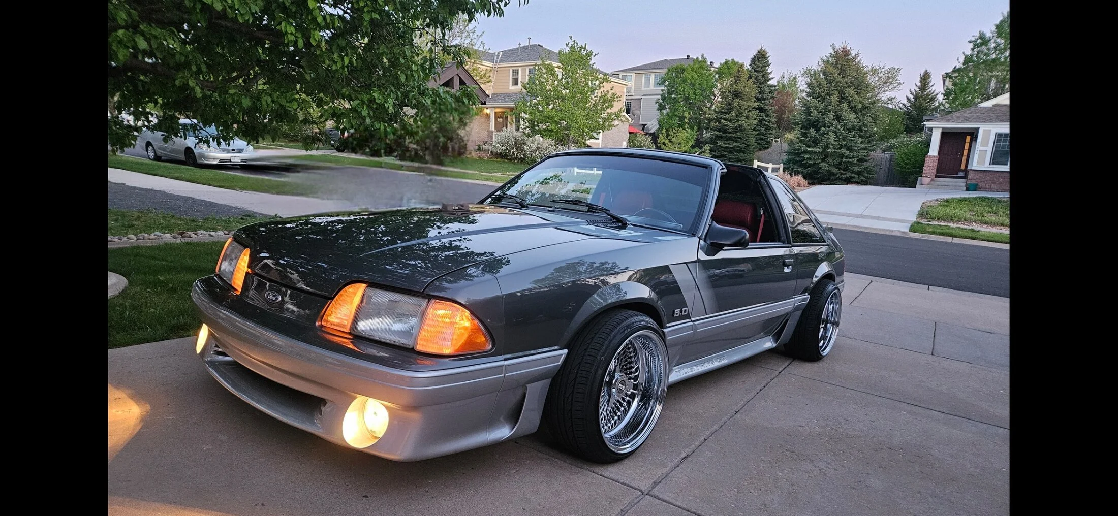

I put Saleen fader stripes on it, is that the decals you're referring to?

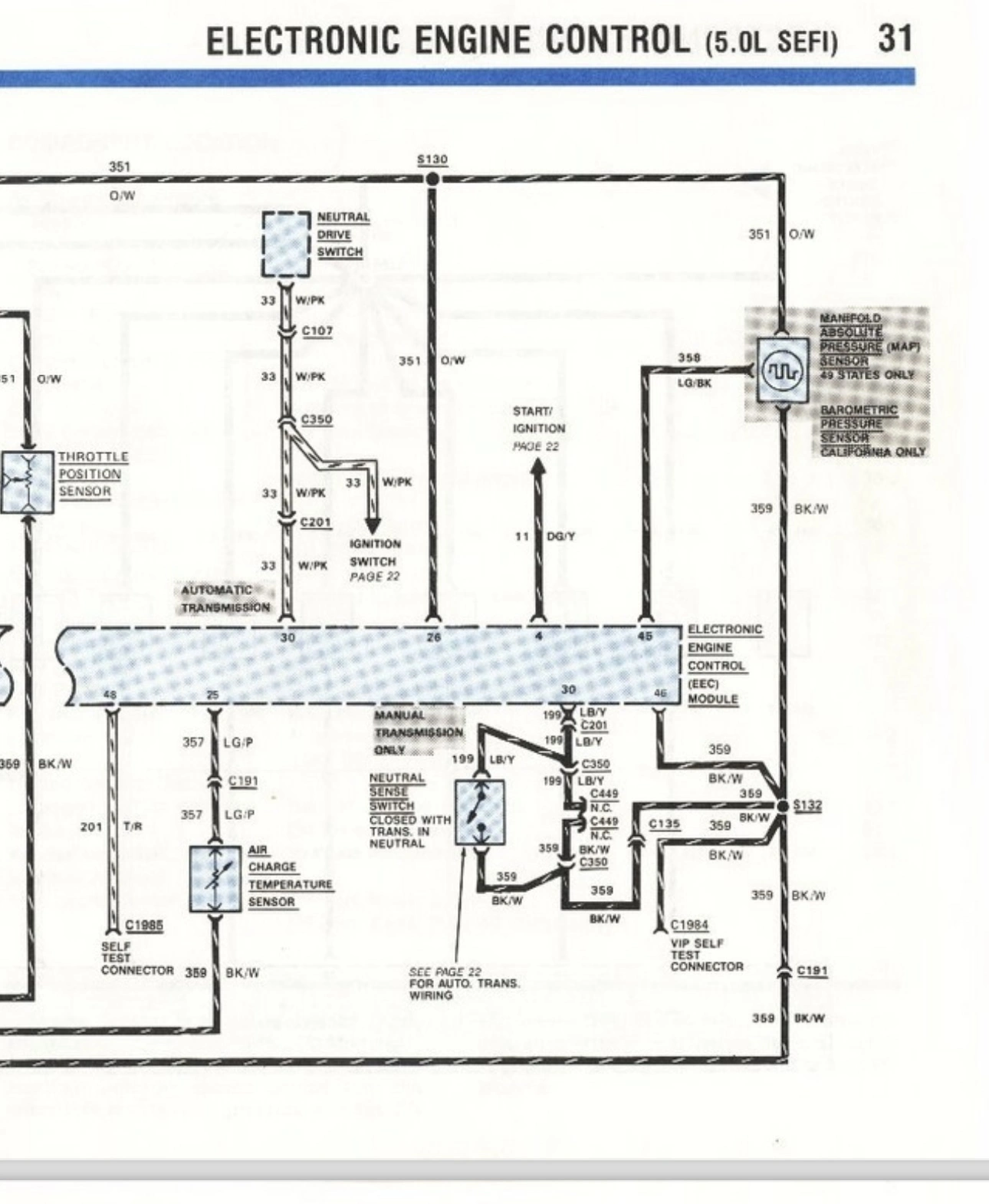

Check the orange/white wire for 5v to ground.
You’d need an occulliscope to further test it, or something like a thexton 127.
If you have 5v you can try testing continuity back to the ECU and make sure the wire isn’t damaged/broken.
Pin 45 is the signal wire. Pin 46 is sensor ground and pin 26 should be 5vRef.
Also. Make sure it’s a current code by erasing all the codes, and doing a few engine cycles and pulling them again.
Make sure the vac line is securely connected to manifold vac
