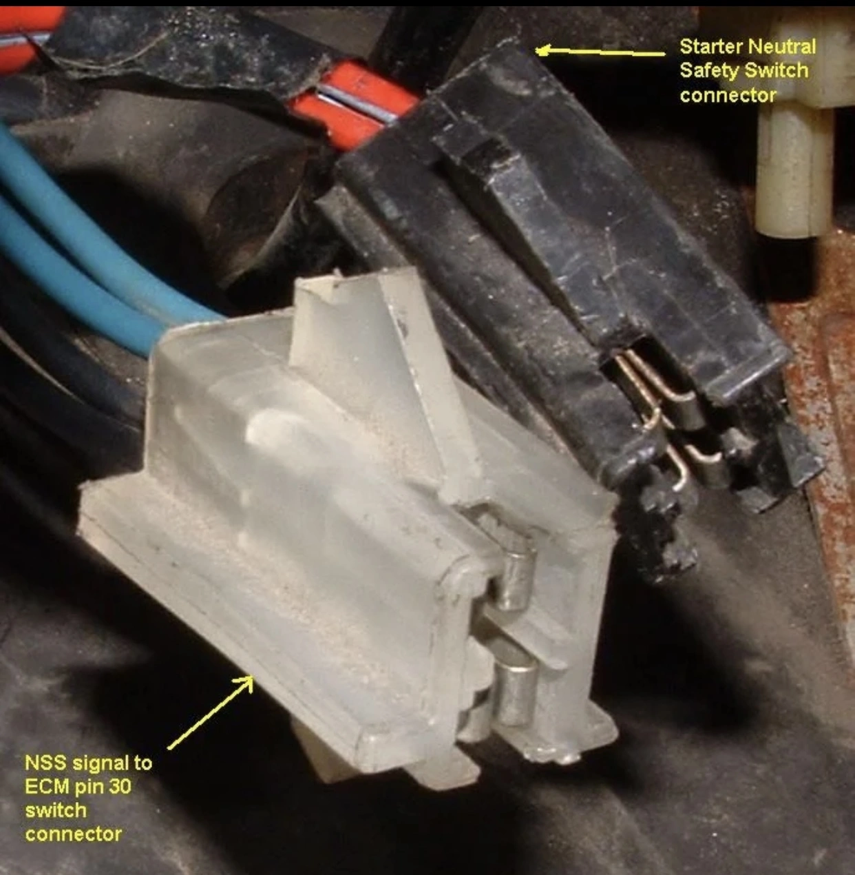

did you swap the transmission harness out to the manual harness and connect the NGS on top of the T5?
As a work-around, disconnect the clutch NGS and install a 5amp blade fuse. See if that corrects your idle issues. If it does, then you need to troubleshoot the NGS circuit (which tells the ECU the car is in nuetral so it can idle better)

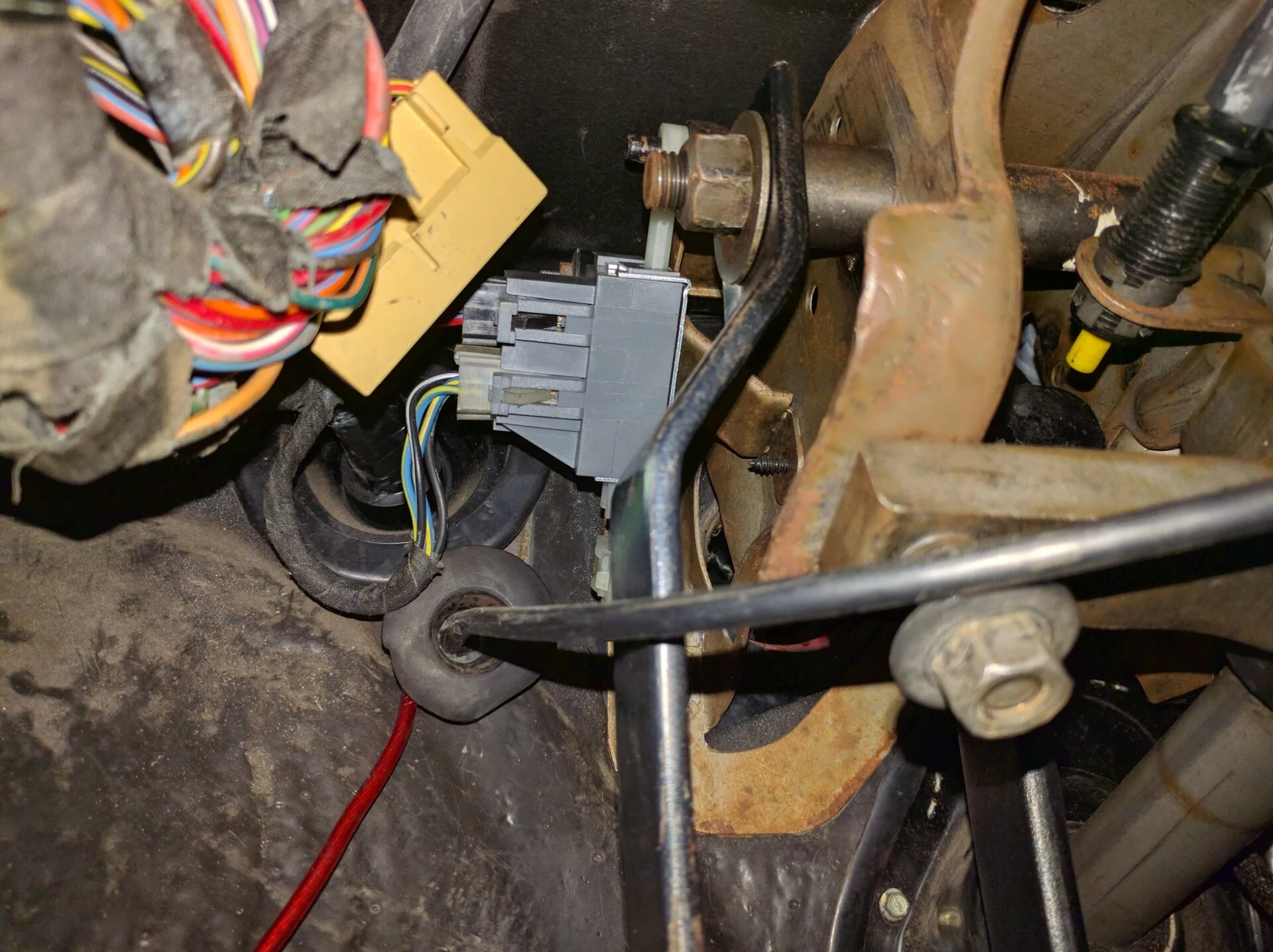

I did try the 5 amp trick and it didn’t really do anything. The car is not mass air equipped. Lmr also mention the clutch dump switch but I did not hook that up cause I couldn’t find it.

Did you hook up the switch on top of the T5?
You said you did the 5A fuse trick. Where did you plug it in? Did you connect it to the clear plug next to the clutch switch? Did you plug these two plugs into the switch? One is the starter safety plug
I connected it to the clear plug. I’m not arguing with you guys but I’ve heard multiple times that the speed sensors also tells the computer to raise the idle once the car gets below a certain mph. I’m leaning towards getting a manual trans harness when I do the trans. I just don’t want to do all that work and still have the idle issues. It is tolerable until I turn the ac on. The the idle has a stroke
