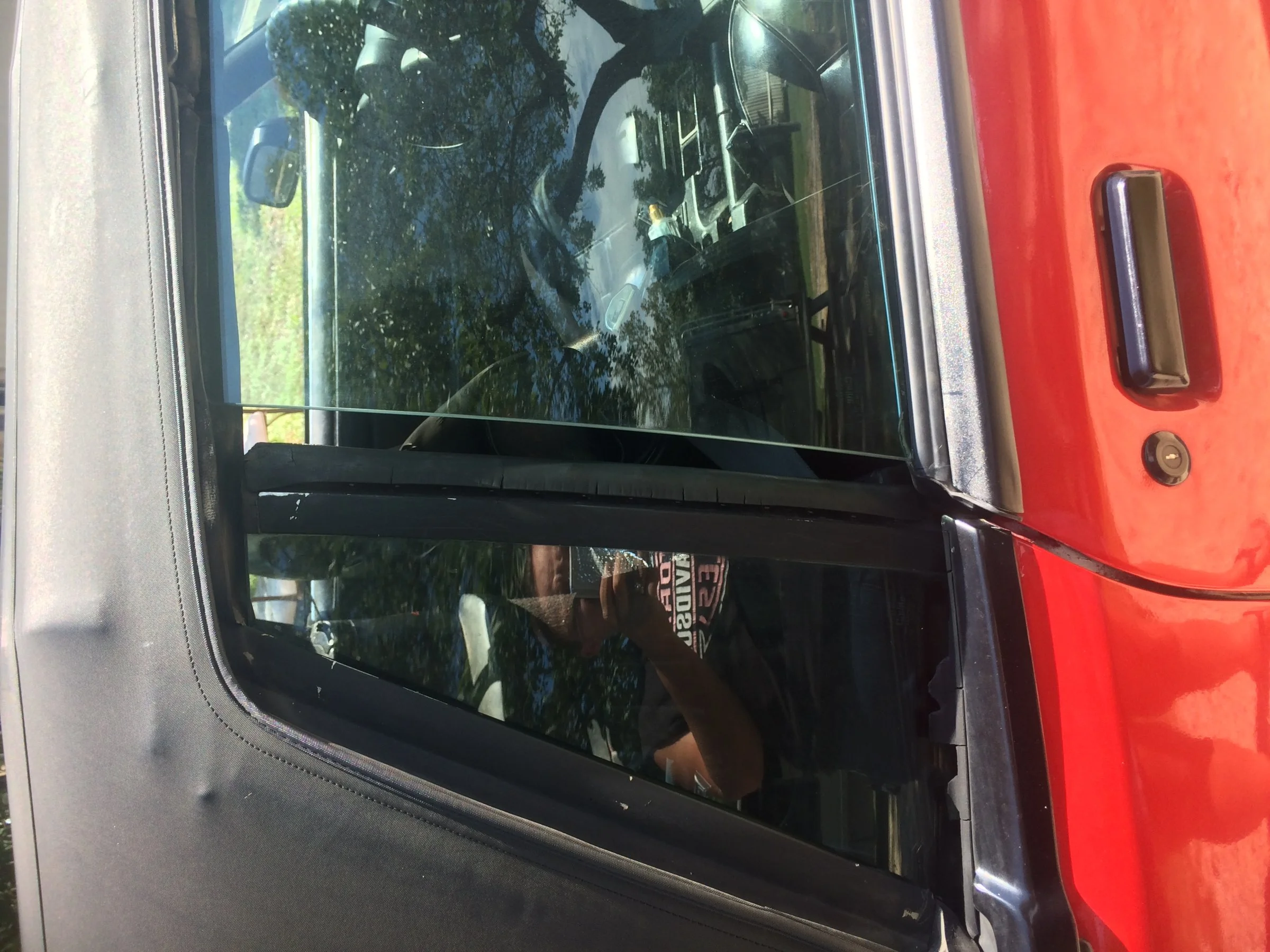

K Kerstinzn Active User Sep 11, 2017 15 5 13 Texas Sep 30, 2017 #1 Sep 30, 2017 #1 So today I figure I try and fix my passenger window. Any help or advice would be helpful. The recent rain has caused me some issues(as in getting in) and the window wobbles as I roll it up and down. Attachments IMG_0144.webp 410.6 KB · Views: 175
Mustang5L5 That is…until I whipped out my Bissell Mod Dude Feb 18, 2001 43,347 18,081 224 Massachusetts Sep 30, 2017 #2 Sep 30, 2017 #2 Window bushings probably need replacement
K Kerstinzn Active User Sep 11, 2017 15 5 13 Texas Sep 30, 2017 #3 Sep 30, 2017 #3 I haven't taken a door apart in for like forever. It ended up being one bushing fixed and working great! Because I wasn't sure the issue I did take both doors apart to compair the working parts and what it should look like.
