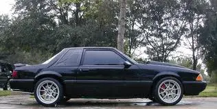

Are you thinking of the coupe spoiler? That is the only other OE spoiler the 'verts had. Anything else would have been aftermarket.
Sorry, that was the best pic I could find.
