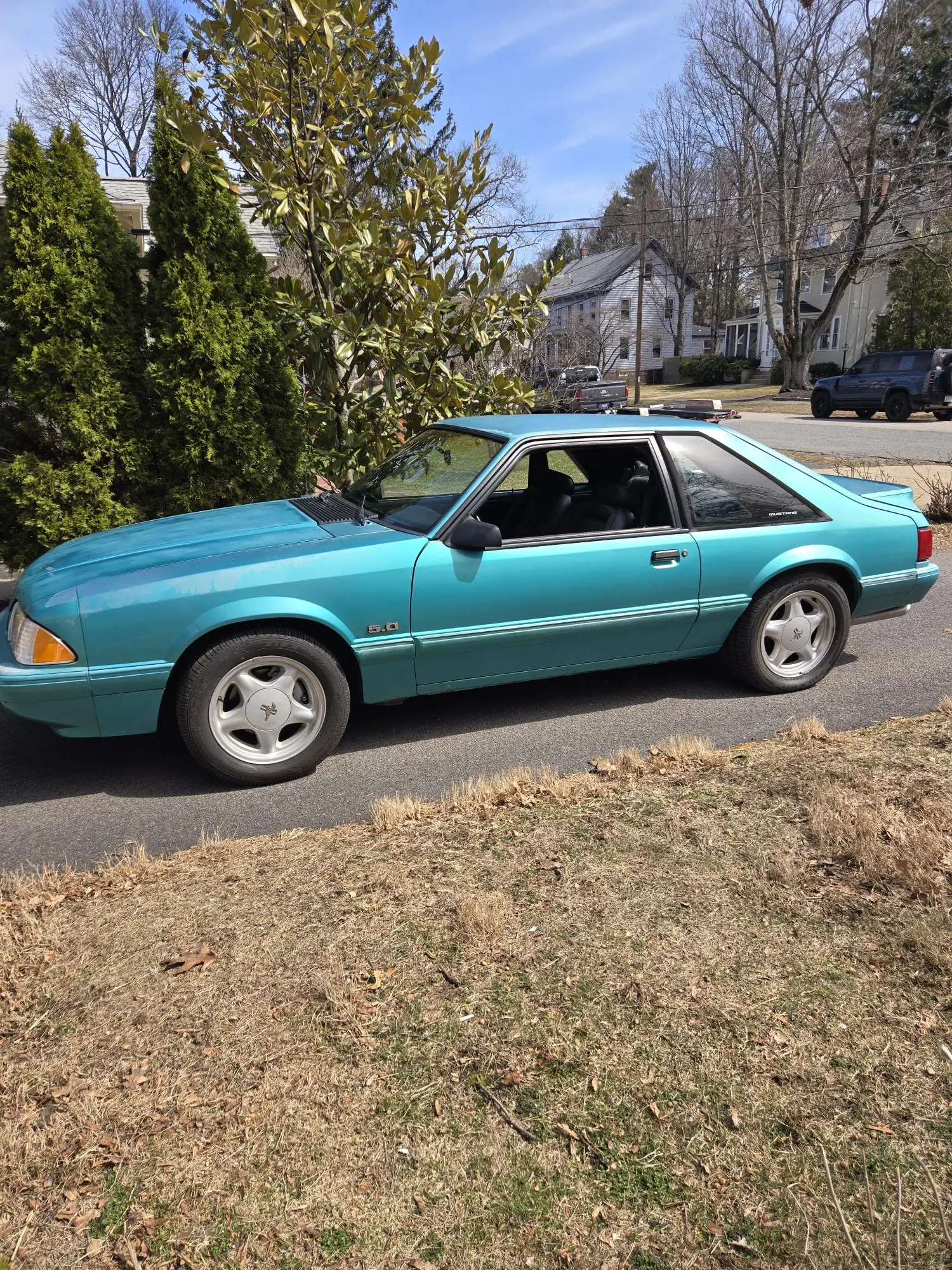

Hello all!
Been lurking for a while, trying to see if I wanted to jump back into the Fox Body game (my first "real" car was a brand new '88 Mustang GT when I was 18). LOVED that car and the memories it left me with. I LEARNED to really drive on it. It was amazing to see how much support exists for these cars now. Being an intense DIYer, I'm not afraid to work on anything and figured I'd jump back in.
Recently picked up the 92 LX hatchback in rather faded Calypso Green. It needs a lot of electrical work (airbag light, no fuel gauge, tach is wonky, no AC), a full interior refurb (this has worked it's way up on the list due to POs smoking in it and needing to get down to the wiring anyway), suspension is shot, and the engine/auto transmission are very tired (138K miles). But body is straight, never wrecked, only light surface rust (originally a southern car), and it's not missing anything.

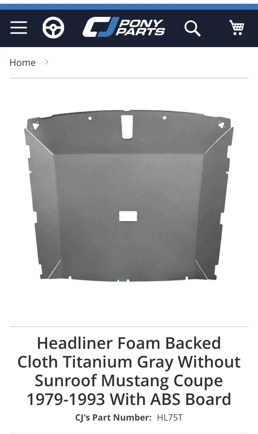

Most choose to replace just the fabric instead of the entire board.. I did mine a few years ago and purchased the one-piece headliner from CJ Pony that had the fabric already glued to an ABS backing board with the holes pre-cut for the dome light, etc… I didn’t want mess with glueing and reusing the brittle original board.
It took me maybe 2 hours with my father to install. Easy peezy… I don’t have a sunroof though. Just remove the front/rear, and side trim pieces then the whole unit drops down. Disconnect the visors if lighted. The new unit went right up and clipped into place. Install the Trim pieces and you’re done. One of the best interior improvements I made. It was worth the expense (to me) and encountered no installation issues. Just have an extra set of hands to help hold it up and shift it around while installing.

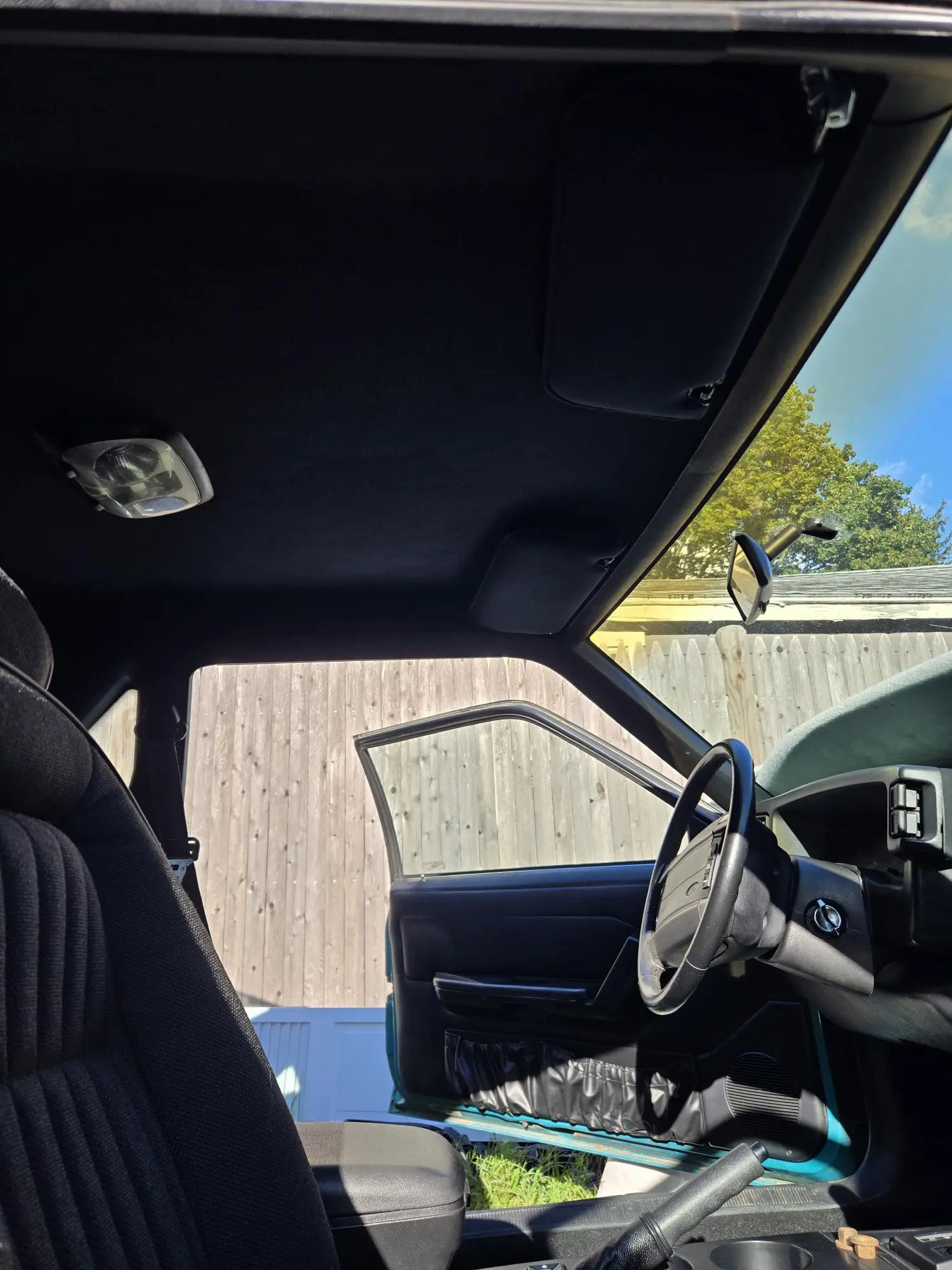

Tried cleaning the headliner with some Chemical Brothers cleaner and a light brush (per the instructions)...started disintegrating under the brush, lol. Soooo, that needs to be replaced now. Decision to be made: get just the liner or get the full board and everything already glued together?

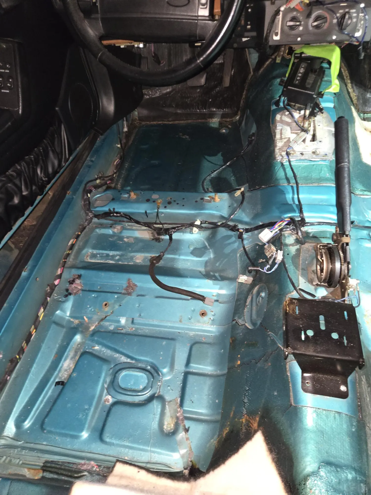

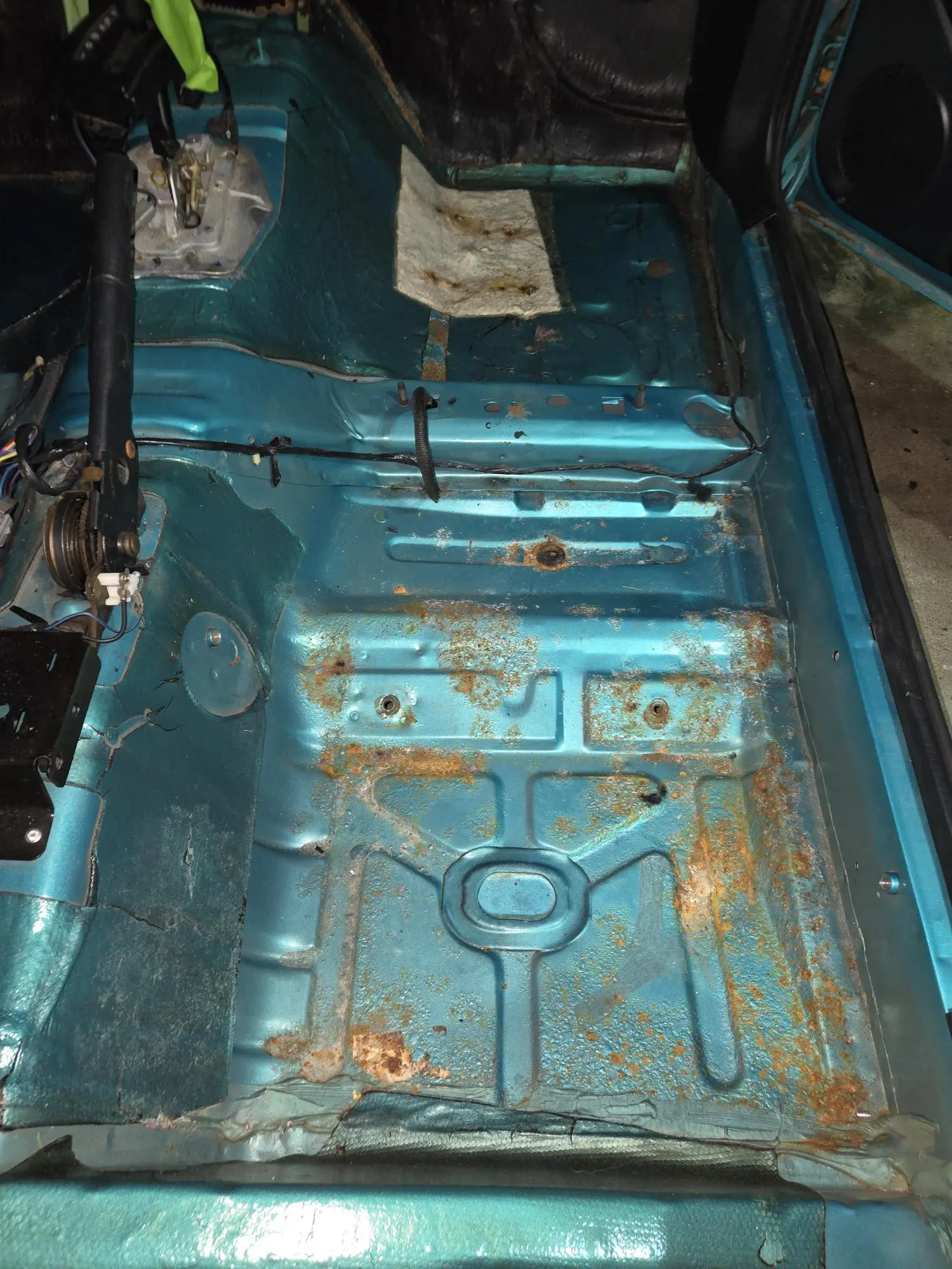

Took out the seats and carpet, floors look really good, except for light surface rust on passenger rear. No idea why it picked that spot, but I'm not complaining. I think it may have come up from that rubber plug somehow and settled under the carpet. Going to put down some Eastwood rust encapsulator I have on-hand and replace both rubber plugs before dropping the new carpet in.

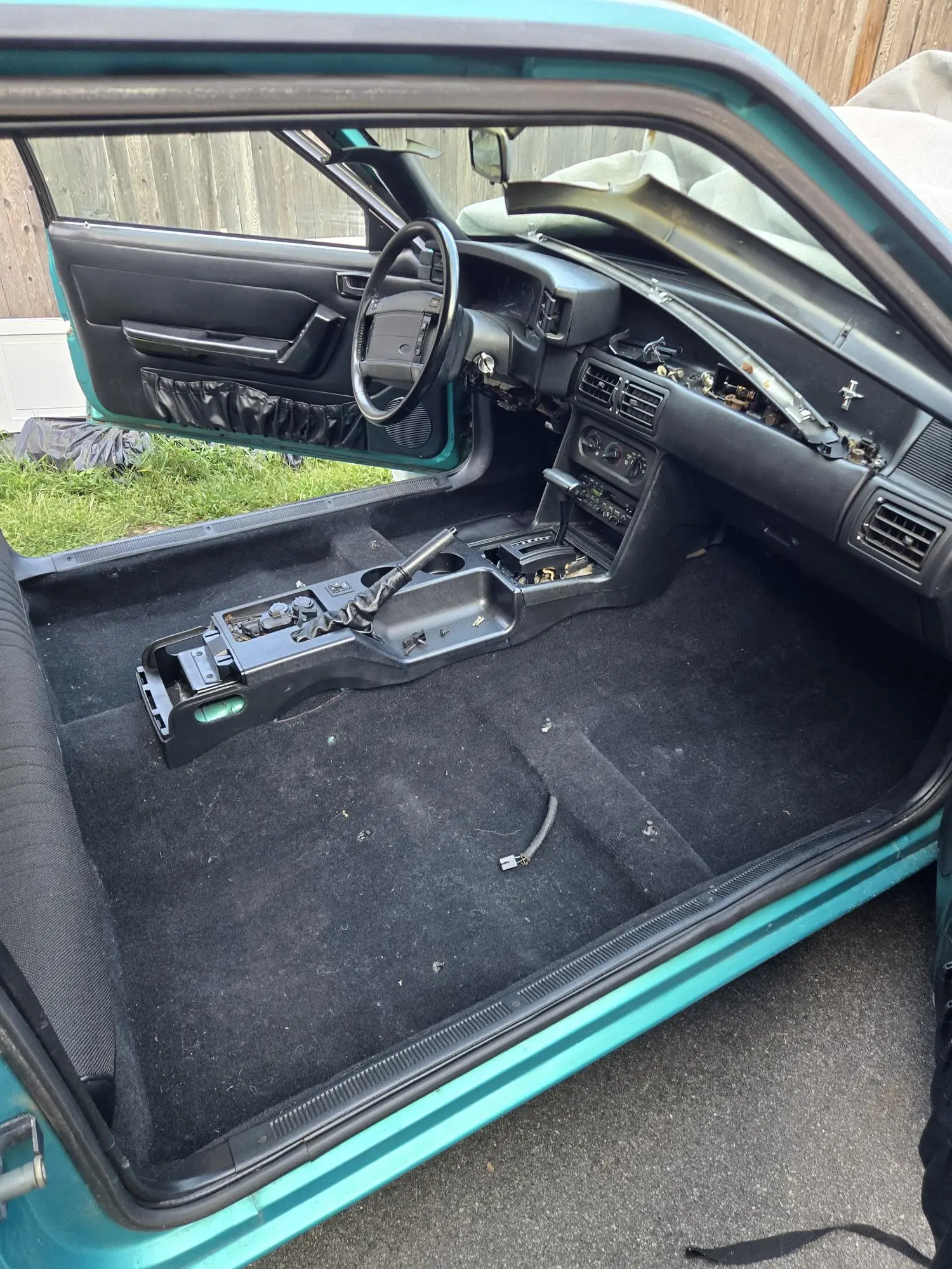

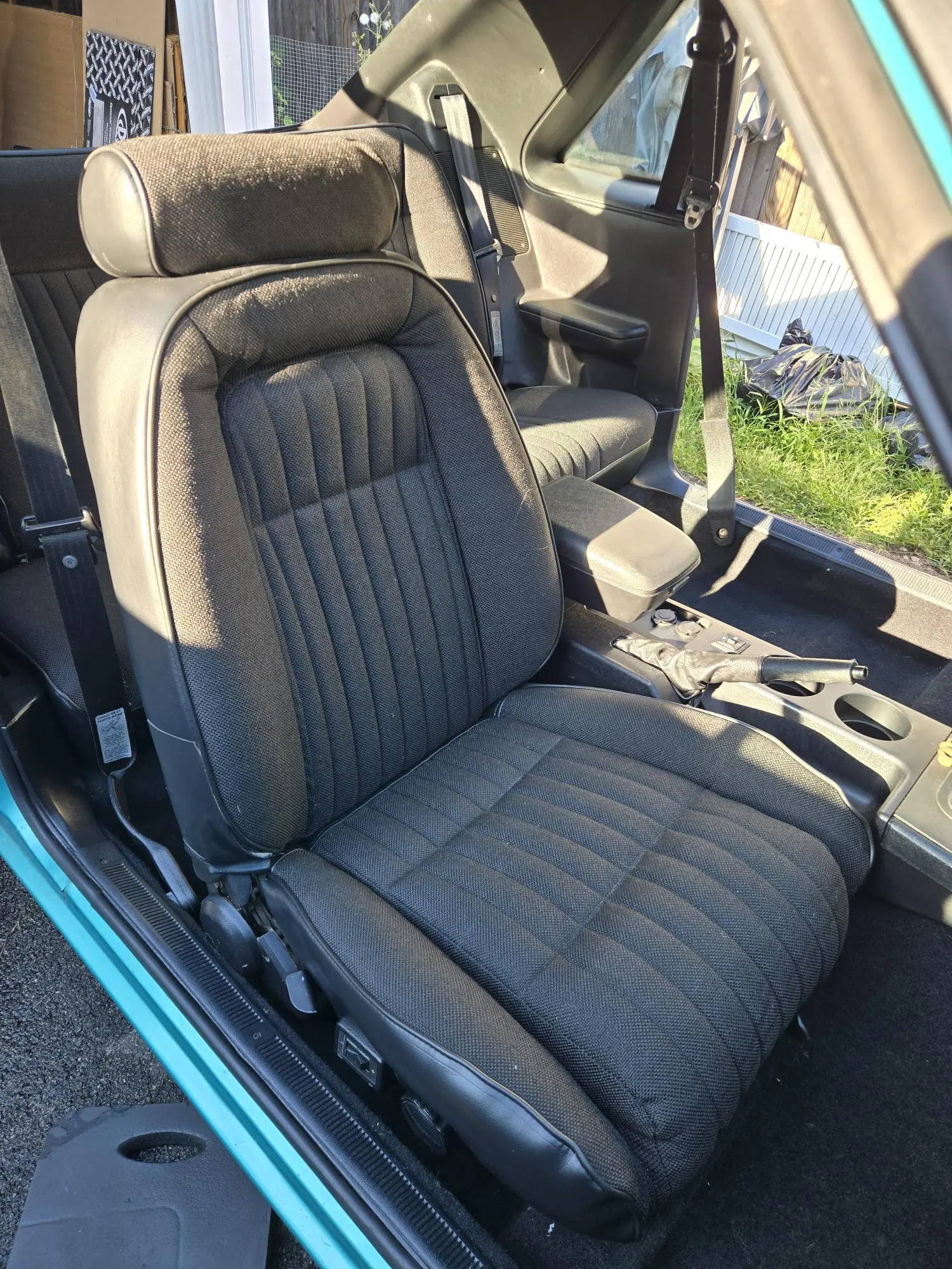

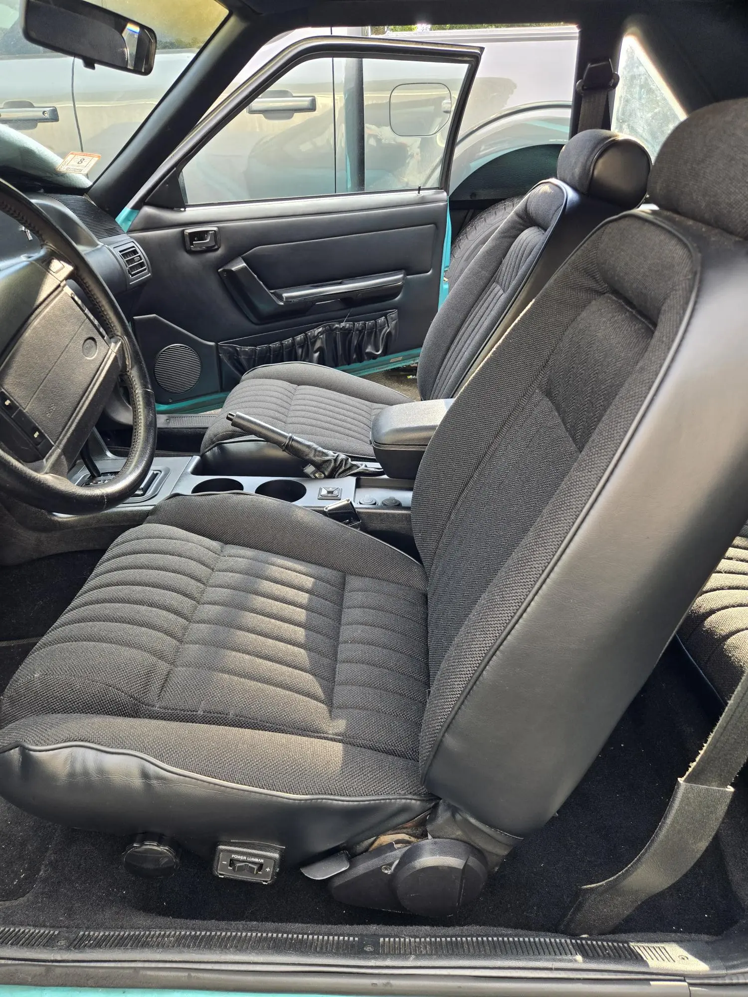

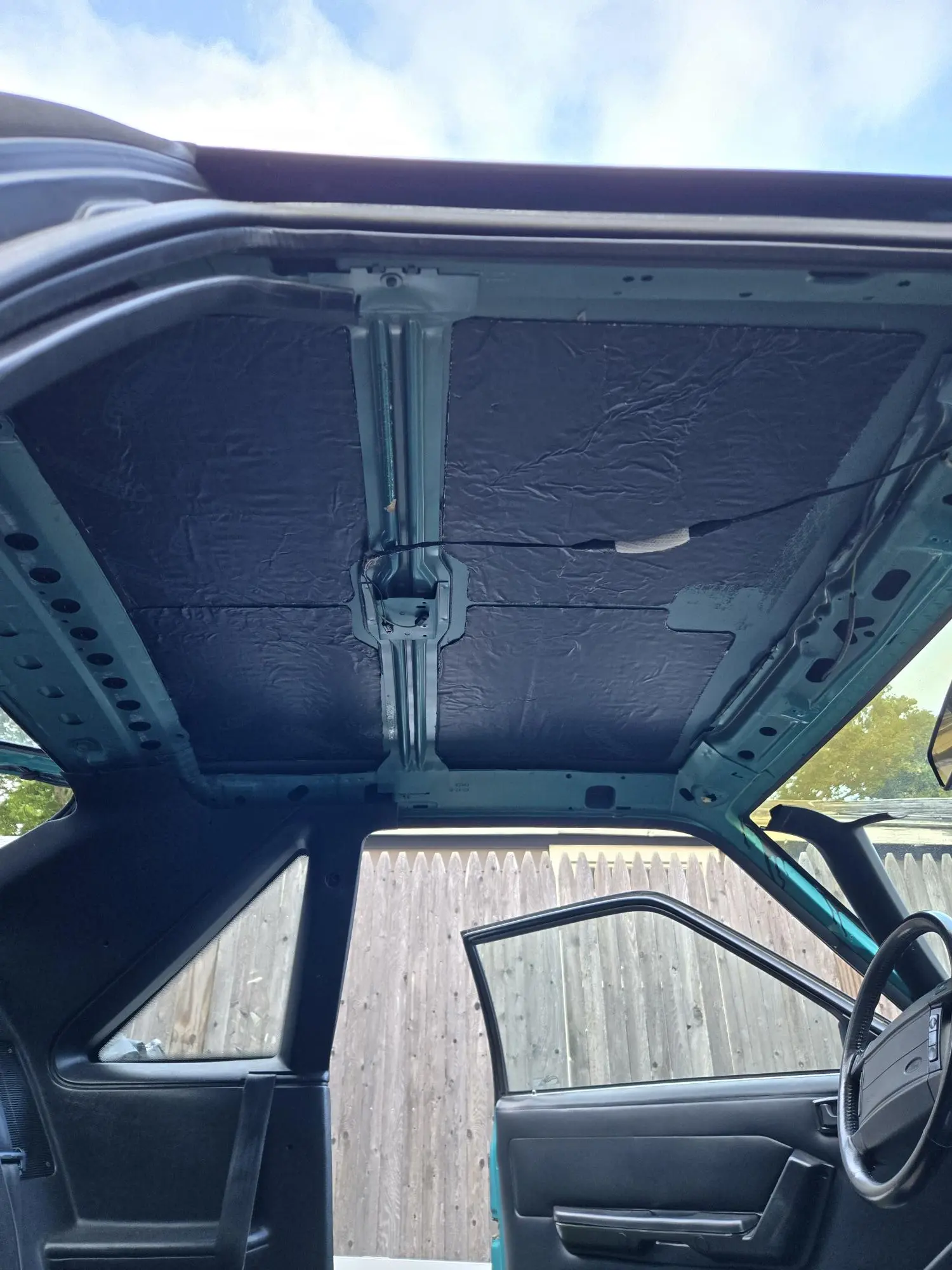

Finally redid the seats (new TMI foam and new covers from some dude on ebay, look VERY close to stock pattern!) FedEx lost my lower seat spring package for a week, so that's what delayed me overall. But that gave me time to treat the floors, re-finish the lower seat frame and sliders, put the carpet in, headliner with new Dynamat, and all new hardware for the interior panels along with new visors (I lost the mirror and light feature with the replacements but I don't care about that).
The passenger seat backrest cover wound up ripping on the door-side vinyl piece. Ripped in the fabric itself, not the stitching. I guess I just got too aggressive with the stretching over the new foam. Much cursing ensued, but I'm not going for perfect. Slapped on some "leather tape" to hold it together. I also cut too much of the rug next to the e-brake. The AAC carpet fit a bit different over the transmission tunnel, so the marks I made from the original carpet where a bit off. But you don't see it with the seat in.
If you plan on doing the headliner, I would just order the pre-cut Dynamat for it, because the stuff over the original headliner will disintegrate all over you and can't be re-used.
Also put the "modern" console in with a USB jack, 12V DC, and cup holders.
Overall, I'm very pleased with the new feel of everything and the utter lack of stench coming from the old fabric.
Interesting things I noticed:
- The passenger side seemed to have more rust on the floor and seat track/sliders than the driver's side. And the old rug was nastier on that side. Maybe water intrustion on that side at some point in the past from an open window or something.
- The driver's seat is likely a replacement from another car. It has the "Power Seat" button under the left side of the knee bolster, but no wiring for it is in the car, and the sliders were manual. I left that off since I didn't want to cut the new upholstery around it, and there was nothing to make it work anyway.
Now just need the foam to settle down a bit. N
ext is new seatbelts and new rear quarter windows, then maybe new weatherstripping in the spring.

Looks good. If it was a smoker car I'd suggest running an ozone in it over night.
Power tracks where a late 90's option same tracks and switch carried over to sn95's so they pop up on 92-93 seats here and there, the switches are a pita to find now so don't chuck it. You can tap power from the lumbar connector if you ever want to add it with an sn95 track... Been doing that for years.
Headliners are easy, a drill brush to knock the old crap off the board some glue and new material, about $50 bucks. I use adhesive backed neoprene for the sheetmetal
You got a link to the eBay seat guy, those look like an acme kit with the vinyl piping, but I do remember some guy on eBay doing leather covers in stock and diamond patterns, don't remember him having a tweed option though but haven't Checked in ages. Think lmr had a warning about acme and tmi foam not playing nicely together but I never mixed them.
Here is the ebay guy, supposedly makes them in-house in CT but who knows? Definitely feels close to the stock fabric but it is different. The TMI foam had to be trimmed in a few spots. It's a little overdone, imo.
Ebay upholsteey dude
I kept the power seat switch, bracket, and wiring harness, don't you worry. I have a habit of not throwing anything out from classic cars I work on unless it's broken or can't be re-used. I won't be adding power seats to this.
