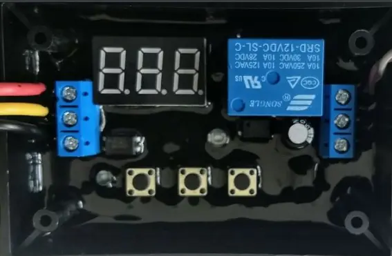

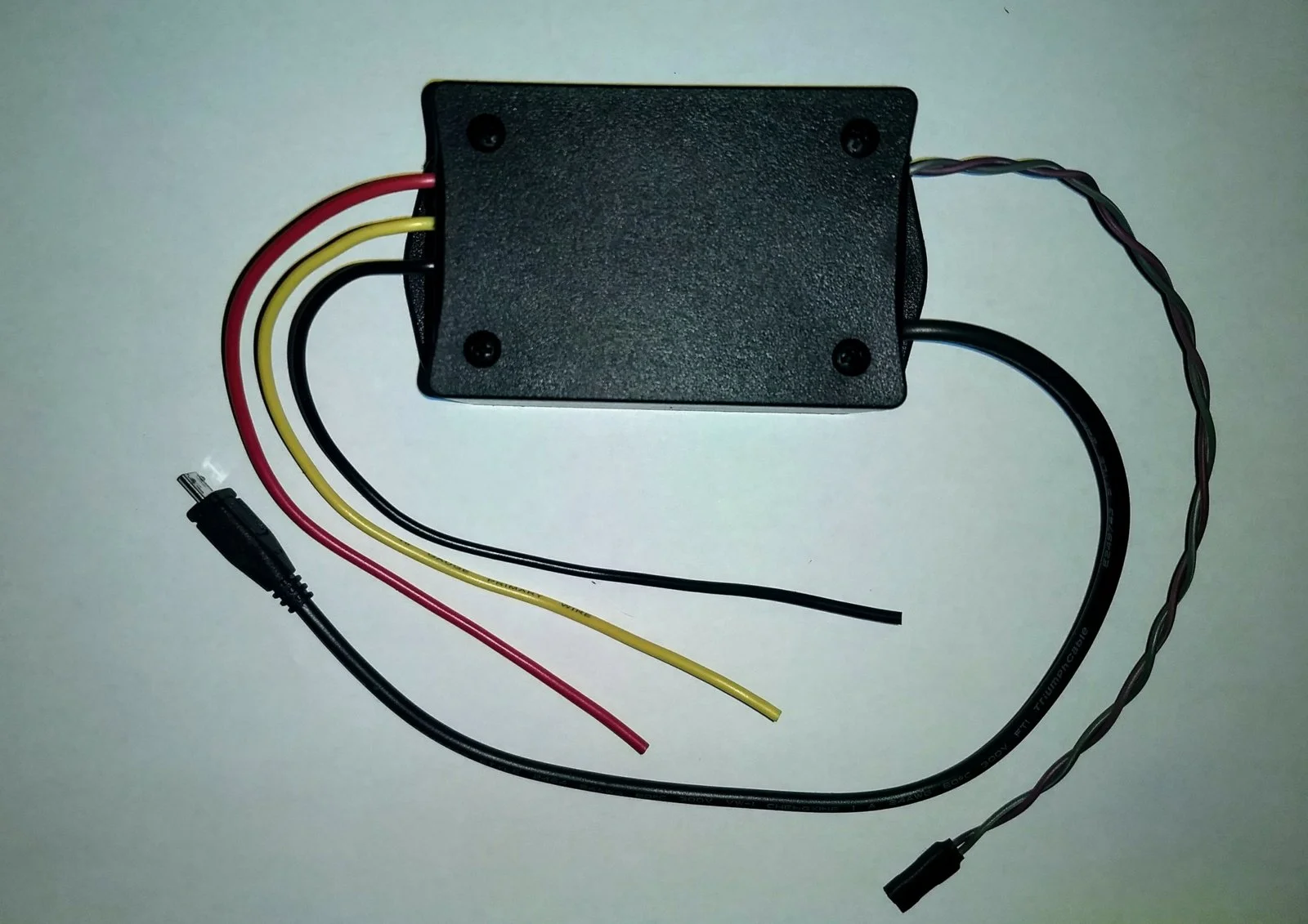

FINISHED:
I have been able to complete the power supply over the weekend. I built another prototype, and tested it on the car before putting it in the enclosure. After I got it in the enclosure I was able to epoxy it in-place. The new enclosure has a screw-on top, so I that I could leave the programmable component accessible. This will allow for a couple different functions: (2) LED's Red for power connected (Red and Black wires) to the power supply and Blue for the activation of the power to the micro USB plug that will go to the RPi, the programming buttons to change the timer on the power supply, and a LED display screen to show the length of timer before the power supply turns off.
On to the picture:

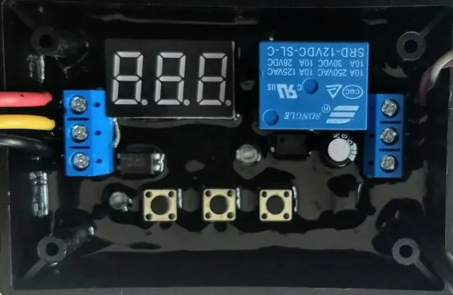

I finished up the power supply for good. I have the top edges of the enclosure notched for the wiring and the screw on lid put on.
Picture time

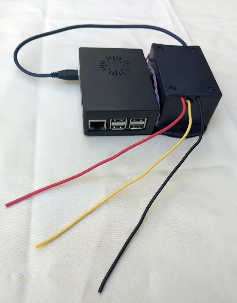

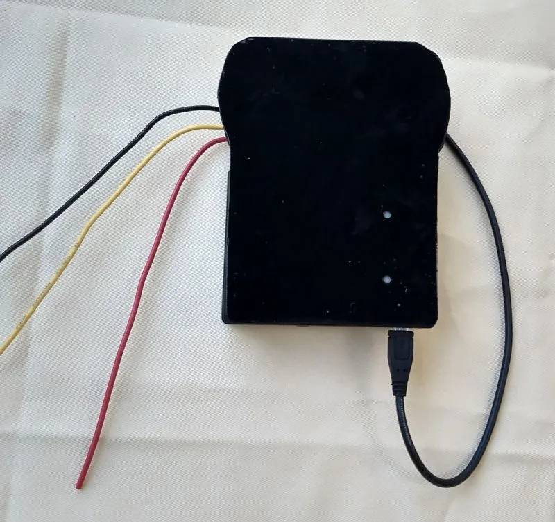

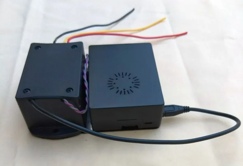

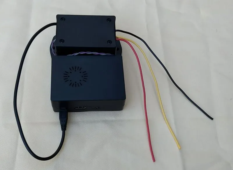

Well, I wasnt able to get as far as planned this weekend. I was able to get the RPi and the Power Supply mounted on a plate, and wired together. This will make the installation super easy as all that is needed to complete is wiring the 3 wires to the car and plugging in the (2) cables to the LCD Screen. After finishing the mounting plate, I have decided that I will move a couple of the wires (Micro USB Power Cable & Trigger Wire) exit points and shorten them as well. This will clean-up the look, so that there isnt some much extra wire laying around. I will also be adding a mounting point next to the RPi, so there is (3) mounting points over the current (2) on either side of the Power Supply.
Here are a couple pictures of Version 1:

you can get a 90 deg adapter for the usb that would clean it up and shorten it a bit.
I have been looking at those as well, but it would put the Micro USB cable point up higher rather than out the end as it currently is. I am not as worried, since I will be needing to plug in the HDMI cable right next to is as well. I could add a 90* HDMI as well, so have some thinking to do on that one.
