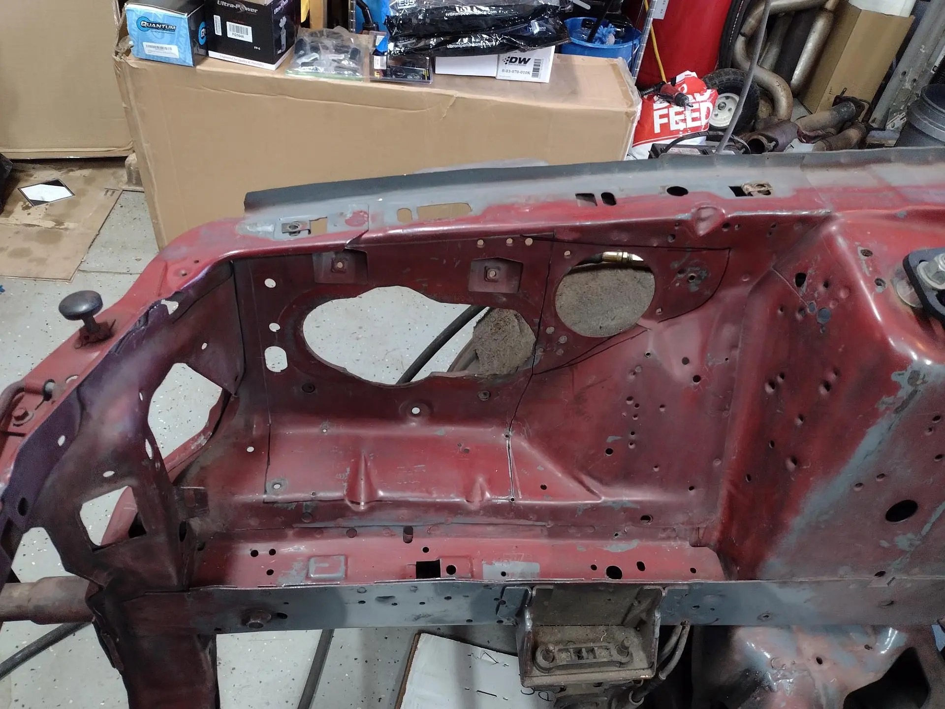

Stud gun?

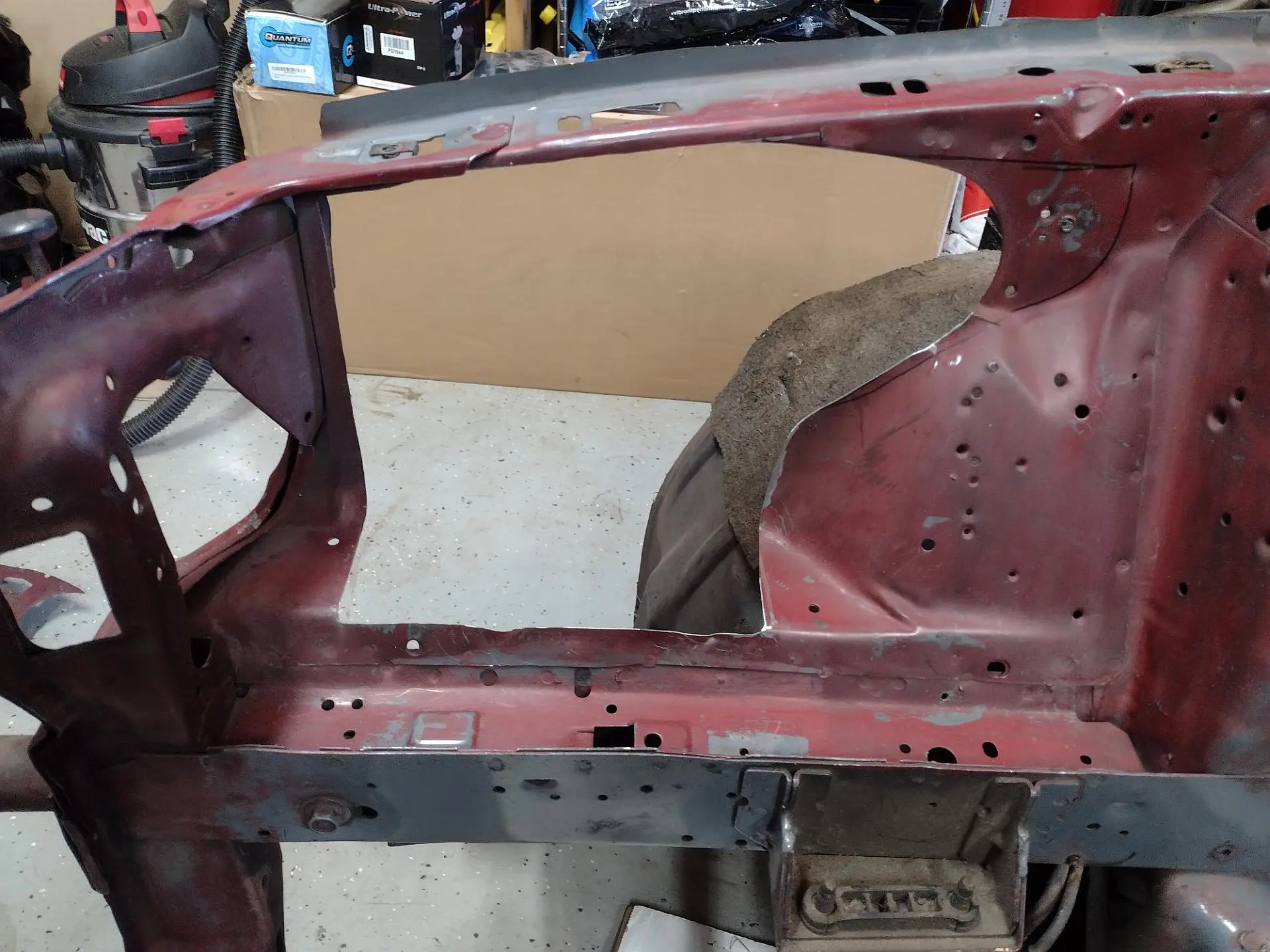

Yes, I used a stud gun that I got from Harbor Freight to remove the last bit of dents that I was not able to get from inside the cowl area. The majority of the work was done with a ram press on a hydraulic ram pump from inside the cowl area pushing up while using body hammers to shape/flatten.

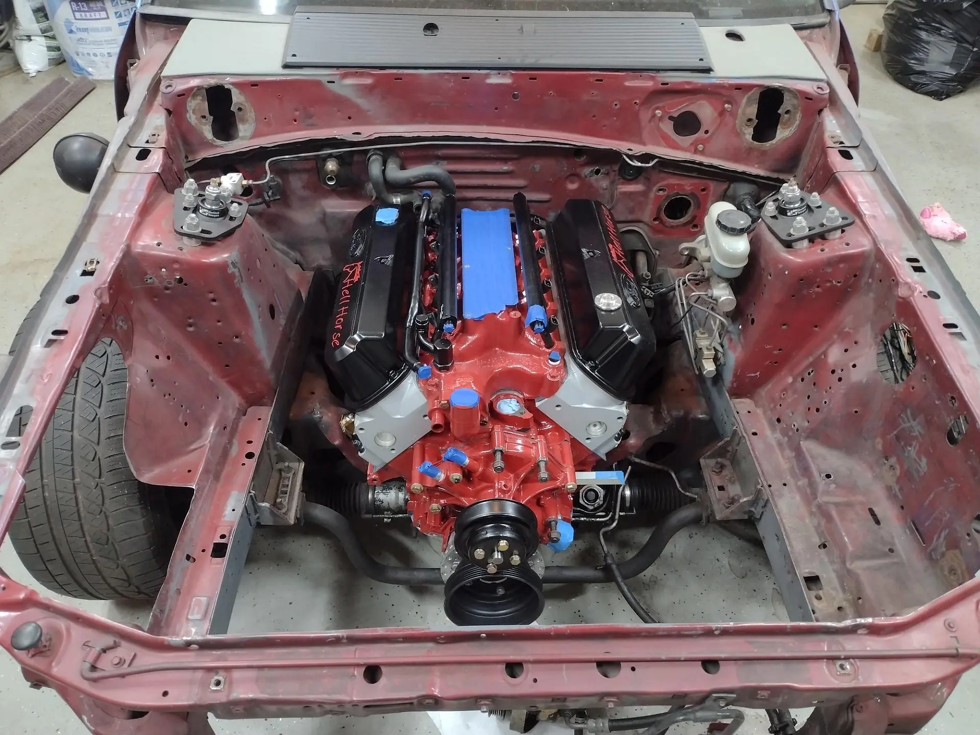

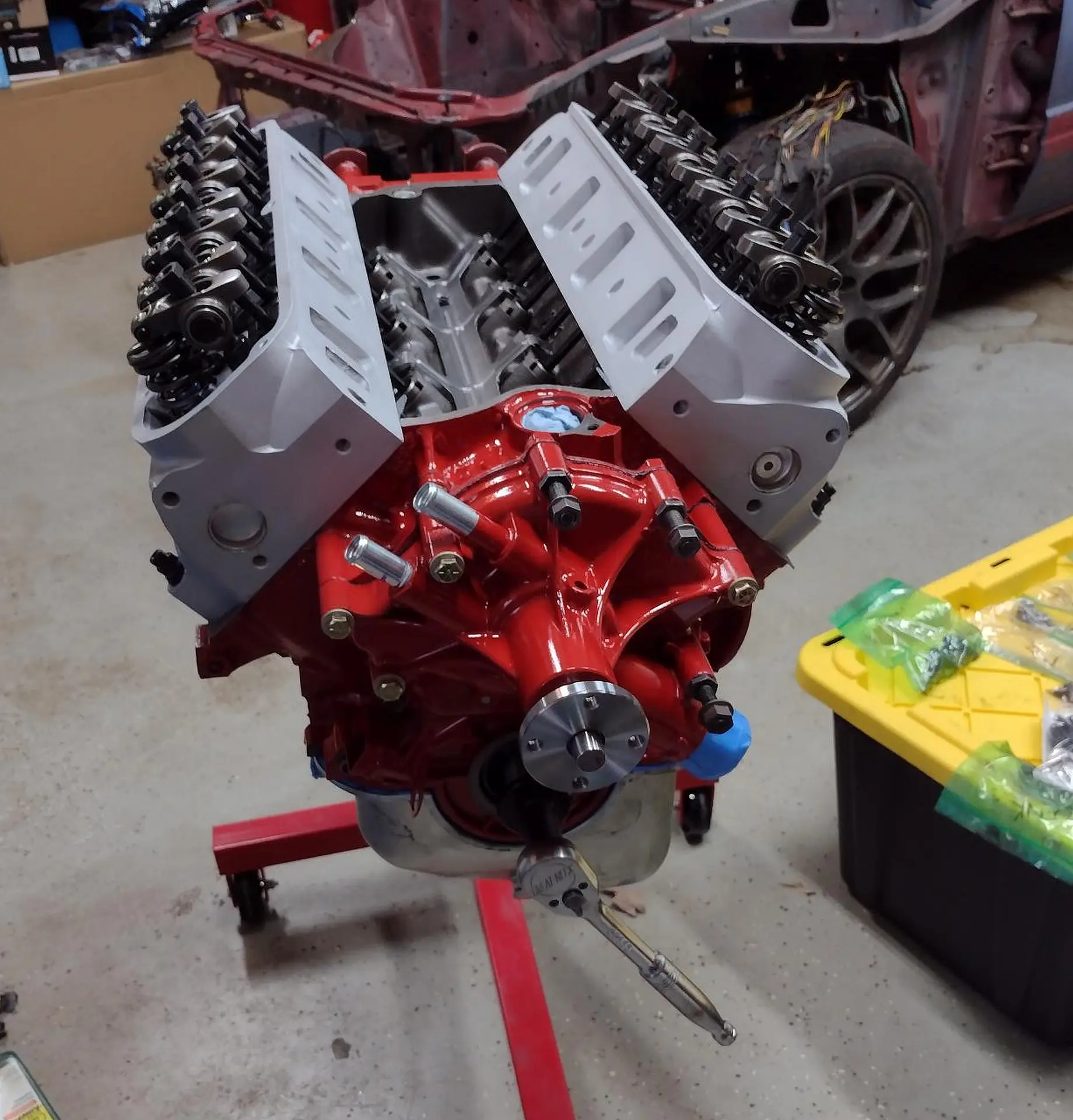

I have gotten some additional work done, but much picture wise to really show. I gutted out the rest of the items under the car AOD transmission, driveshaft, and rear half of the exhaust. This did also include a lot of vacuuming of spider webs and nests after it sitting for almost 3 years now.
The next step is to gut the rest of the unneeded wiring including factory engine harness, fog light wiring, and the alternator and starter wiring as well. I won't be using any of it as it will all be new custom harness that I will build. The plan is to also pickup a SN95 fuse box to wire everything to as well.
