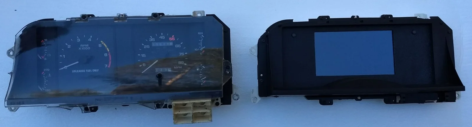

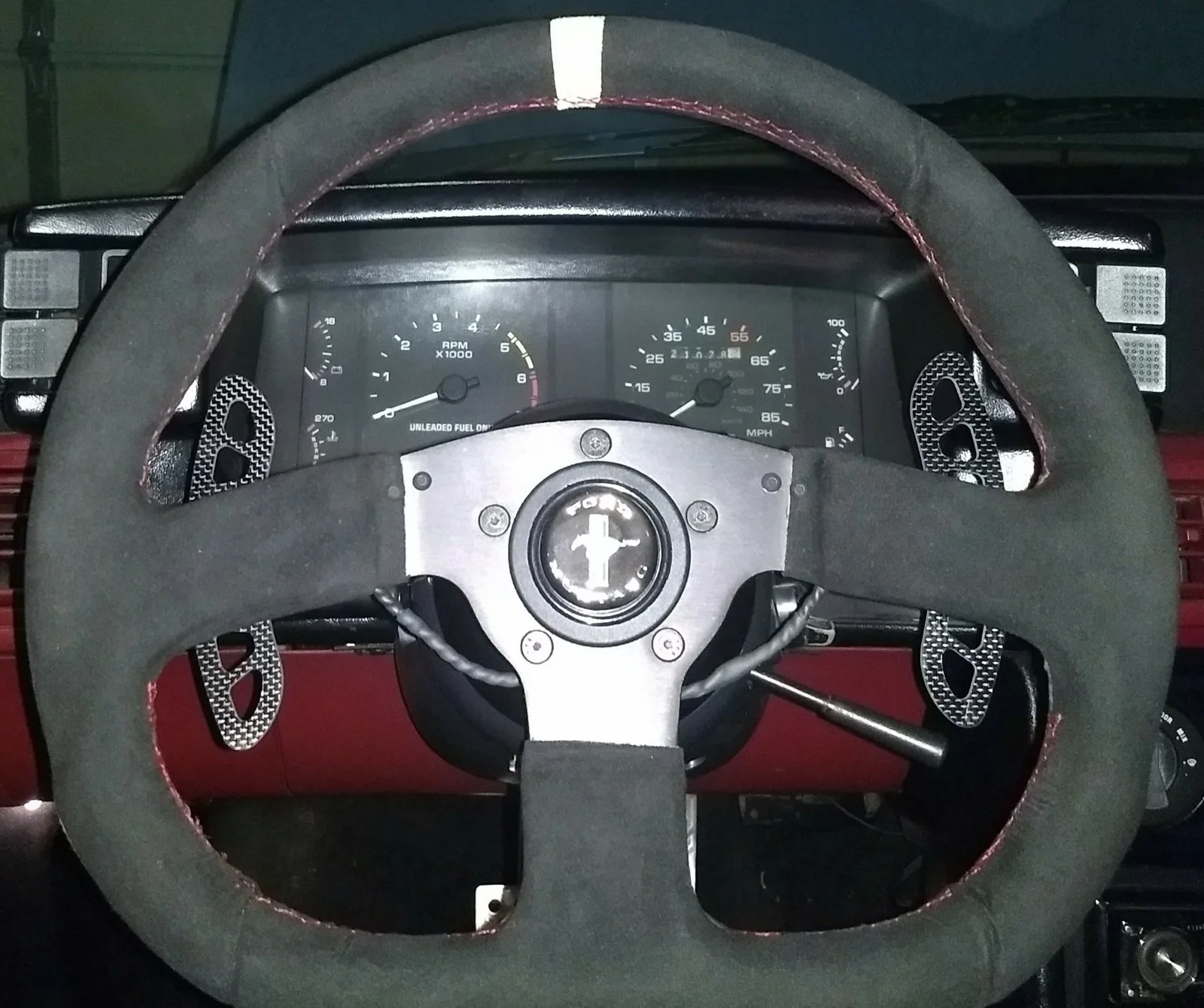

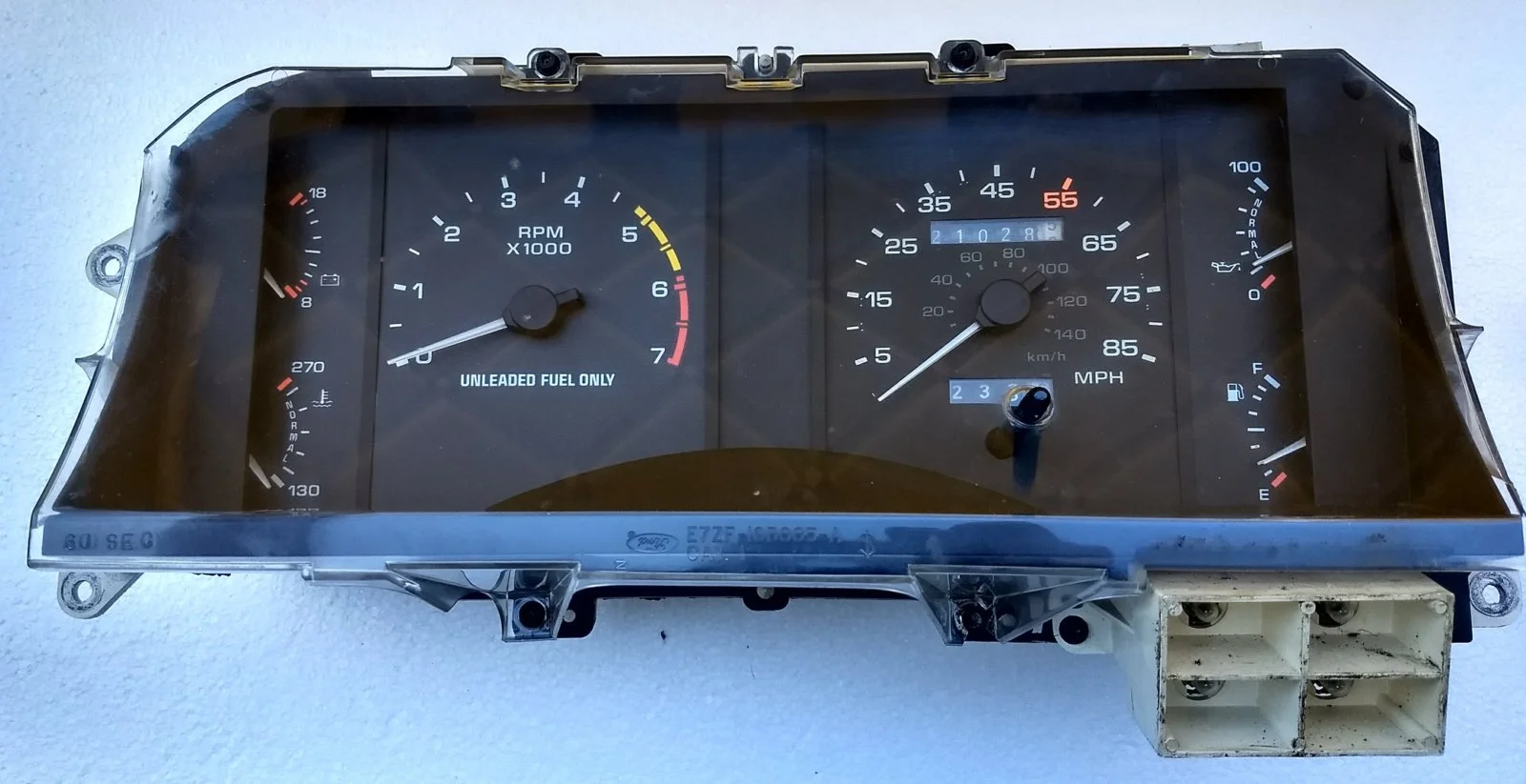

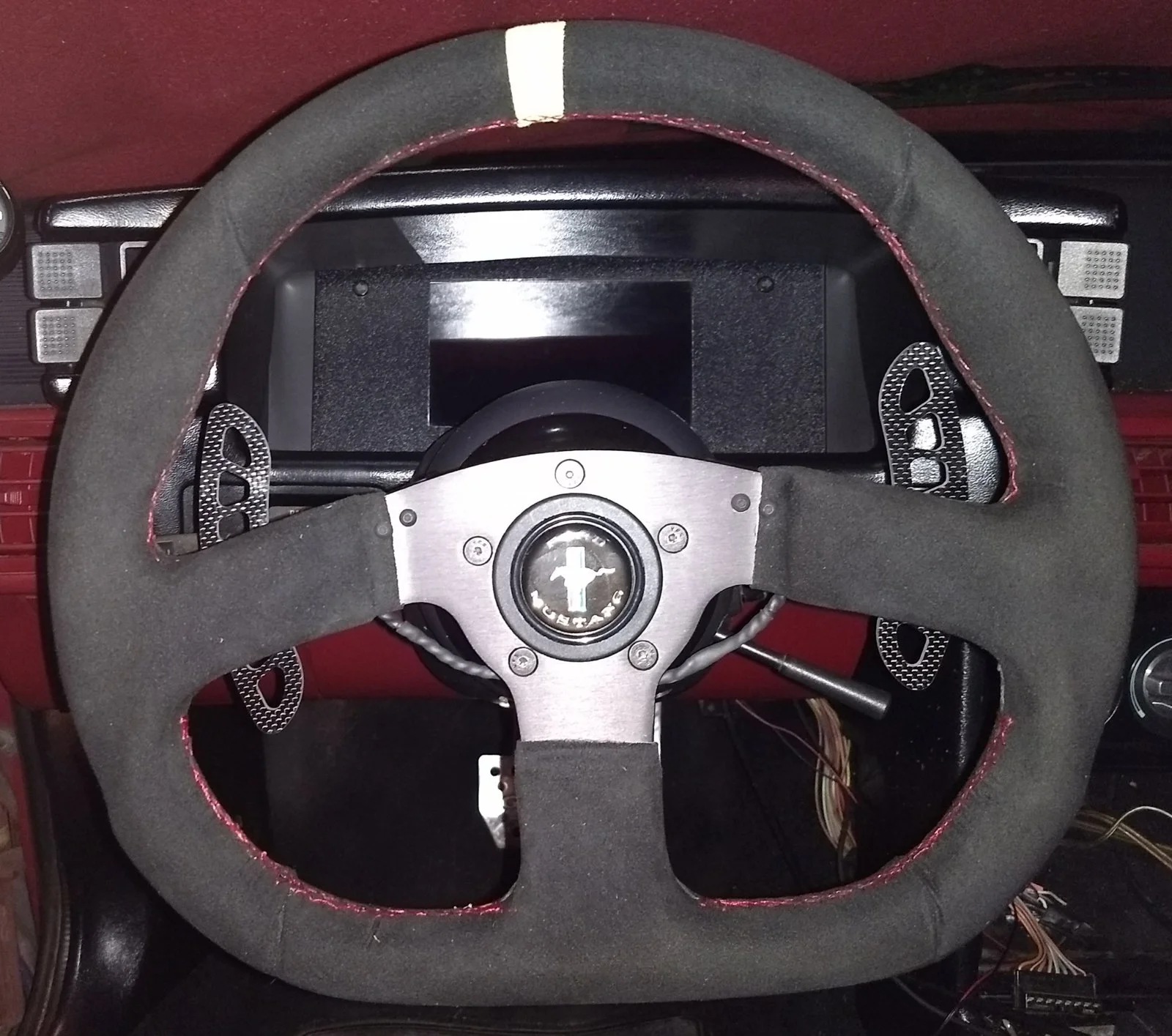

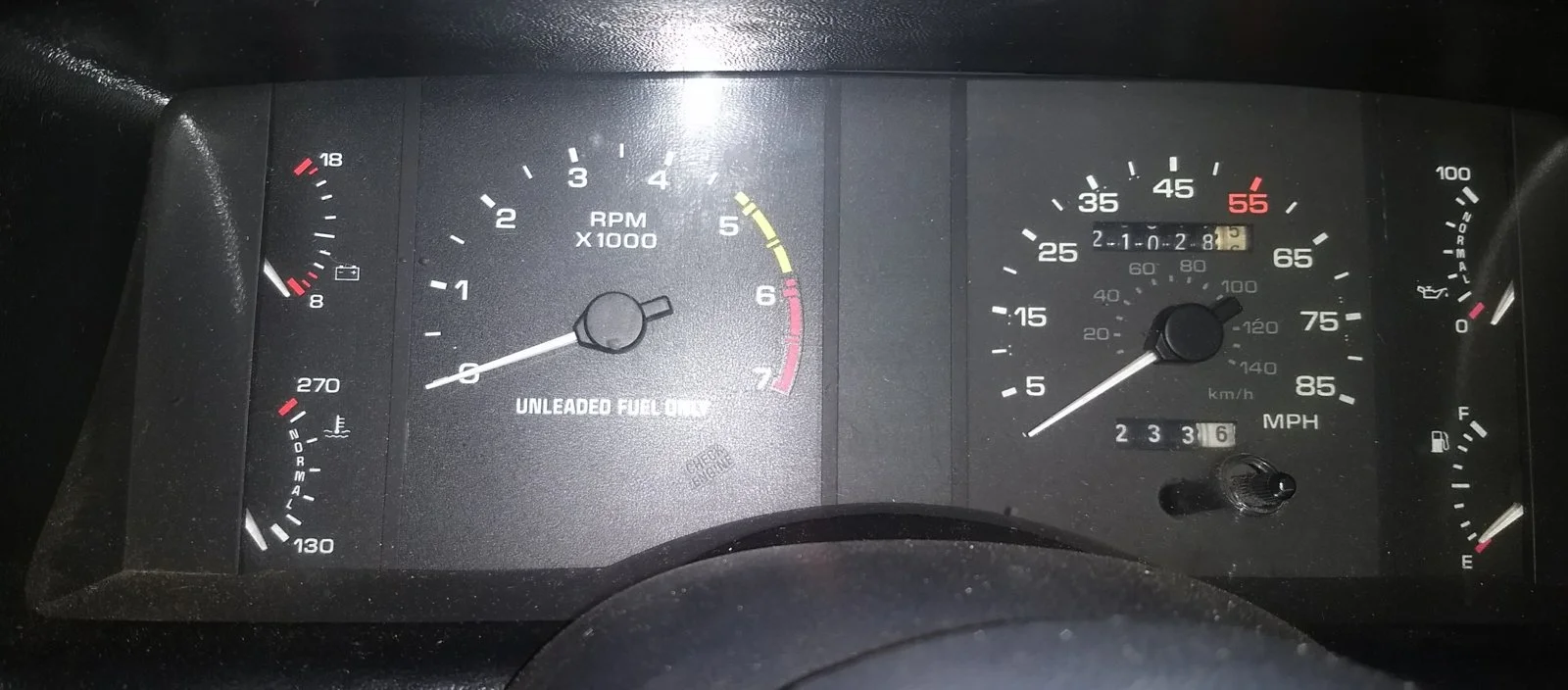

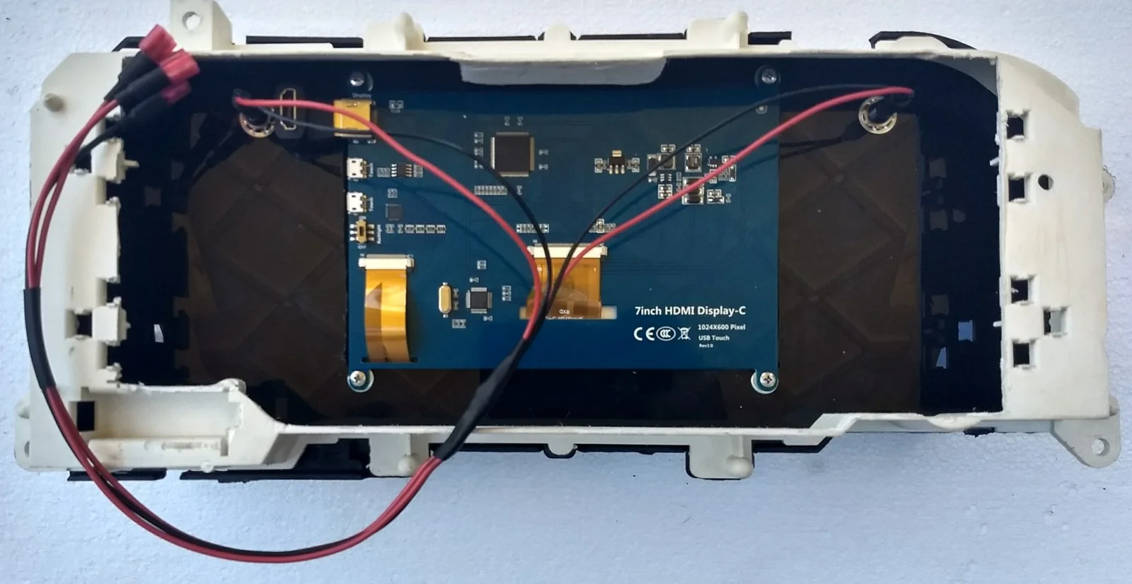

Finally:
The instrument cluster has been installed in the car for it's final location. I built a mini wiring harness for the turn signals, and heat shrinked it all together with the terminal ends. I then spliced onto the factory harness for the turn signals using a small pigtail with terminal end. Plugged in the connectors and installed the cluster in the car. Tested the lights and they work just as they should.
I got all the trim back on and ran the HDMI and USB connectors to the screen. They are not hooked up to the power supply yet. I did get the old radio out, so it is ready for the next step of installing the mini fuse box.
Here are some pictures of the before and after along with side-by-side comparison. There is definitely a weight comparison that's for sure too.

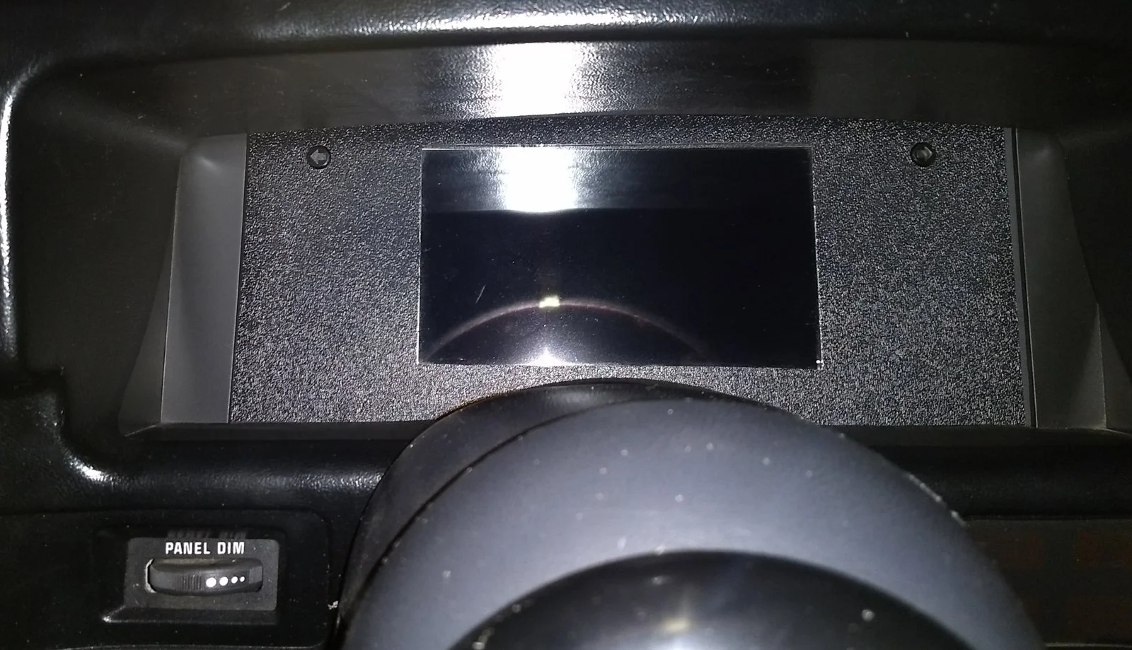

Final installation:

It's Alive!!!!!!
I was able to complete my above todo list, and have the digital dash installed in the car. Wired in the fuse box with its own dedicated 10ga wire to the battery, and connected the spade/ring connectors to the ignition and ground wires to the car. Turned the key on and the dash started just like its supposed too played my video and opened directly to TunerStudio. I tested putting my Vehicle Project on a thumb drive, and opening it from the dash directly from the thumb drive. It worked perfectly, so any changes that I make to the tune or record datalogs will be saved directly to the thumb drive. This makes it super easy to just pull the thumb drive out and put it in my tuning laptop.
Sorry guys no video on it as I got side tracked on the screen delay script, which turns on/off the screen based on the ignition being on/off before the shutdown process is executed. This makes it so the screen isnt on for the 15-30 minutes of the computer shutdown delay, but turns the screen off in 30-60 seconds. I was having issues with the trigger not resetting. After the ignition is turned off the screen would turn off after the delay and turn back on with the ignition back on, but if you turn the ignition back off again it wouldn't trigger the delay again. It just would hang there and do nothing. That took a little time to adjust the script a couple different times to get the outcome I was looking for, but it works now. Just took a little longer than expected.
Last things on the list now is to just go back through everything. I still have little things that need to be done like make a service to automatically run the screen delay service, and a configuration screen to adjust the delay period. A couple of my new dashboards that I made need to be corrected, since some of the numbers get chopped off. The big thing is that it all works, so just need to wrap up the little things.
Then it will be video time again...
