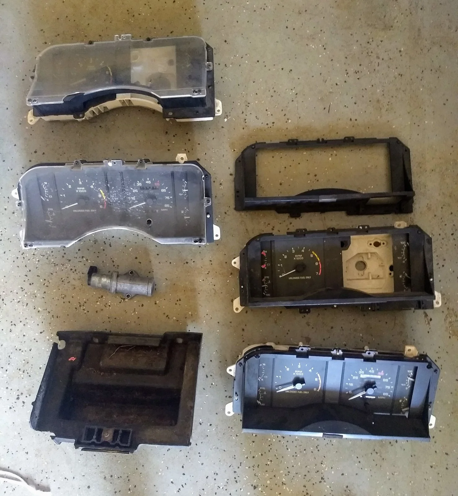

On the way there, I stopped at the Pull-a-Part that we passed heading to the beach. It had a 91 hatch that I pulled the instrument cluster out of for mocking up a new Digital Dash setup. I also got a spare IAC Valve, headlight pigtails for a new harness project at some point and battery tray to replace the terrible one currently on the car.

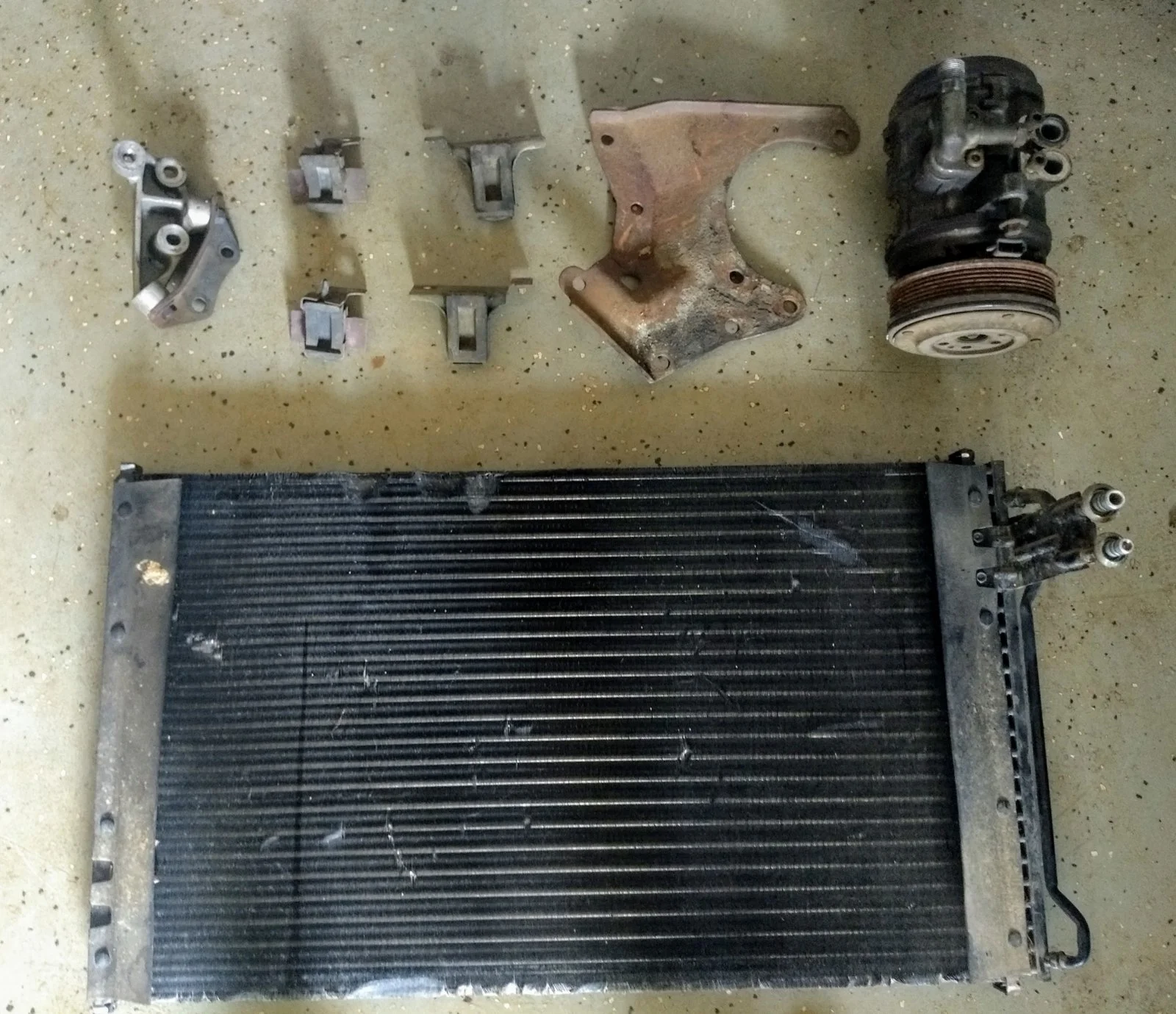

I also got to go there my Uncle's Garage that's packed full of mustang parts because we had a trade for an electric fan for A/C parts, so I got a compressor, condenser, and brackets. I also got a few more "junk" instrument cluster for a couple more digital dashes.

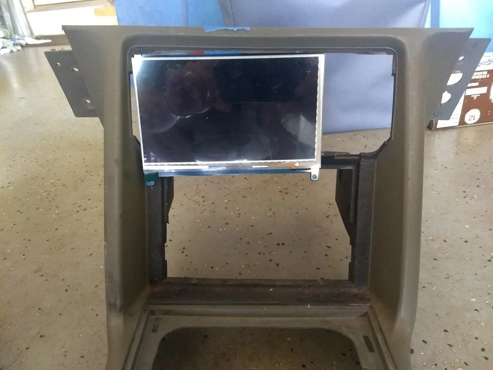

Lastly, I had to climb into the attic space to get a center console frame for mocking up the center console touch screen. I think I need to go bigger than the test 7" screen.

That screen looks like it would fit perfectly mounted lower in the console

nope just needs a larger screen. Kurtis and I are in an unofficial race of sorts to see who gets a working prototype ready. We think a 10" touch may fit but I am doing a 7 as that's what I have on hand.
I don't have internet right now...boooo
But using my phone it seems like a 9" screen is going to fit perfectly in that area. The current A/C controls are going to be moved to the bottom rather than the top.
List of current features planned:
- Stream Music
- Phone Calls
- Navigation
- Rear Back-up Camera
- Splash Screen Boot-up

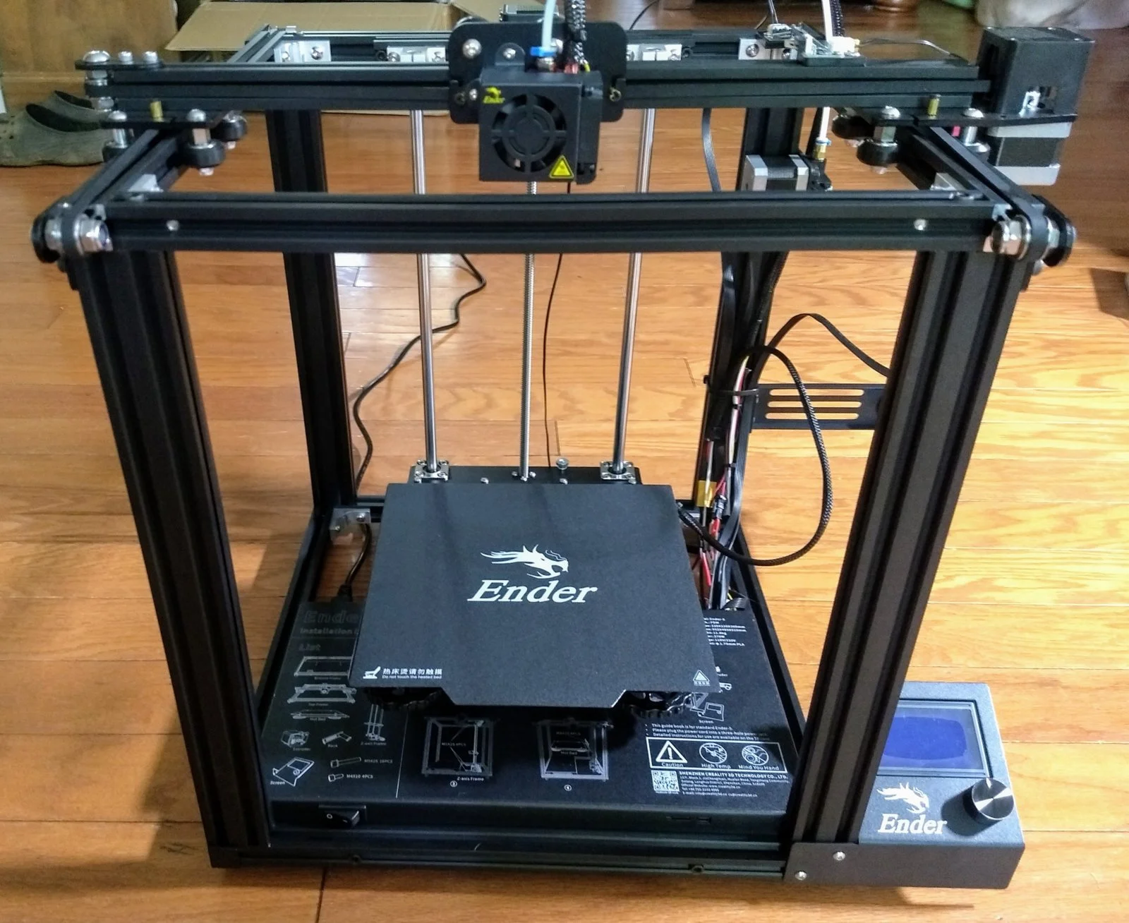

I got it put together

I know that I can go out and buy a double din radio and stick it in the bottom area of the center console, but anyone can go out and do that. This project is to do something unique like you do Mike, and try to modernize the interior a little more. I never did like the HVAC Controls to be front and center eye sight wise, and wanted them further down in the center console out of the way.
The plan is to redesign the layout of the center console area to have the Touch Screen at the top for the above features initially, and then move the HVAC controls to the bottom a little recessed back a little making them less pronounced. I do have other plans of tying the Digital Dash and Center Console systems together, so that I would be able to change dashboards, change boost levels, enable/disable other outputs to the MS.
