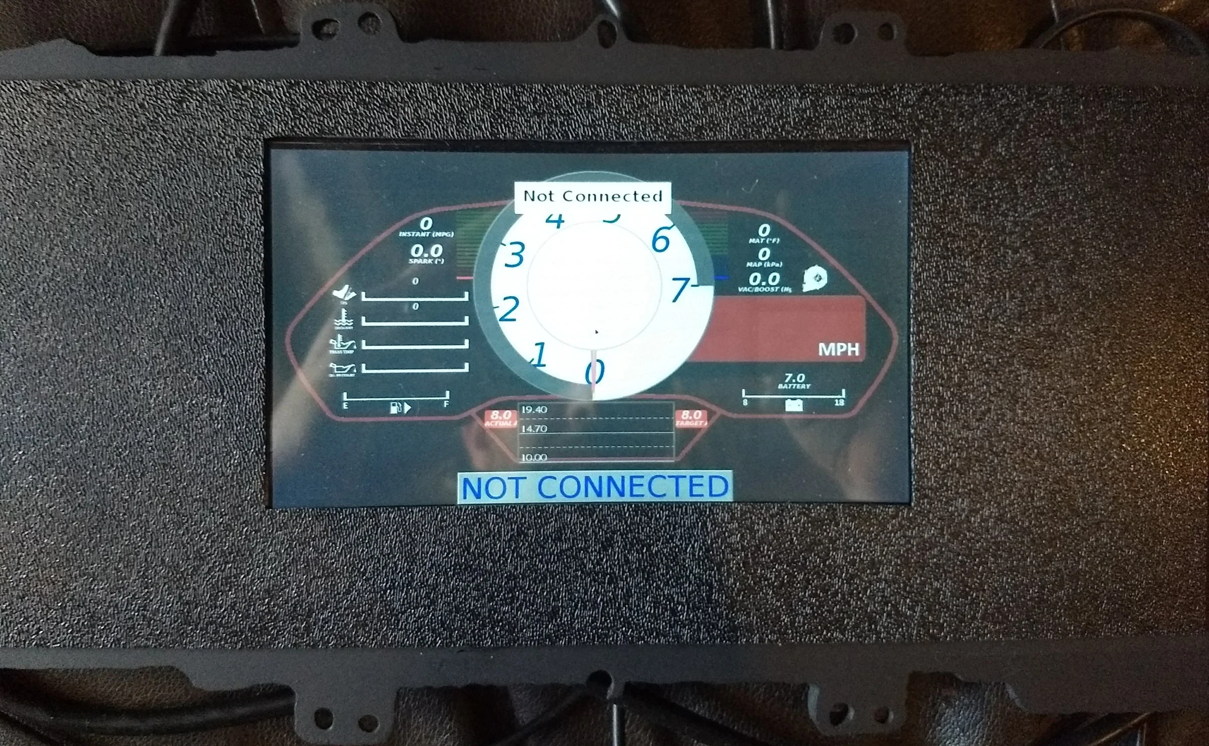

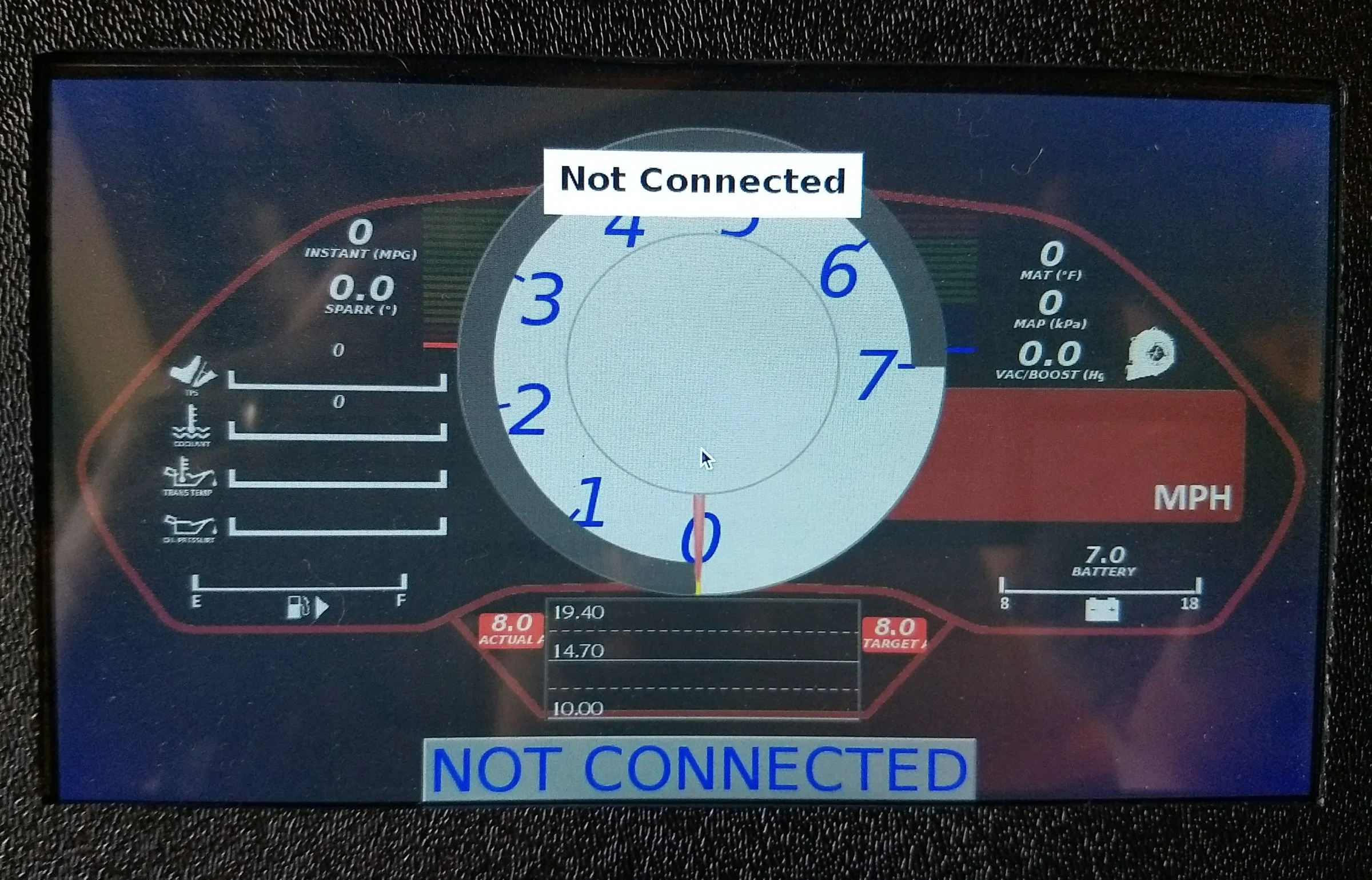

Checklist:
1. Fix the purple line on LCD Screen
2. Address the project not opening issue in TunerStudio
3. Work on quicker booting from power on to gauges showing in TunerStudio ( Goal: 30 sec of less)
4. Configuration of splash screen when booting
5. Drill hole on right-side of instrument cluster base to allow HDMI and Power Cable routing to LCD Screen
I have been able to complete #1 & #2. The original LCD screen settings that were provided with the screen are incorrect. They had the setting being hdmi_group=1 when it was supposed to be hdmi_drive=1. This tells the Raspberry Pi that this is a screen only with no sound. Why that makes a difference in the screen resolution I have no idea. This was after a lot of google searching and reading on the display options of the Raspberry Pi.
The feedback from EFI Analytics for correcting the project loading issue was correct. Changing the communication setting to serial, and reloading the project fixed the problem. I am now able to turn on the Raspberry Pi, and have it load automatically the TunerStudio software to the fullscreen dashboard. I have a current picture on the dashboard, but this will change due to the resolution of the screen. Things are quite small text wise, and others like the RPM numbers are huge.

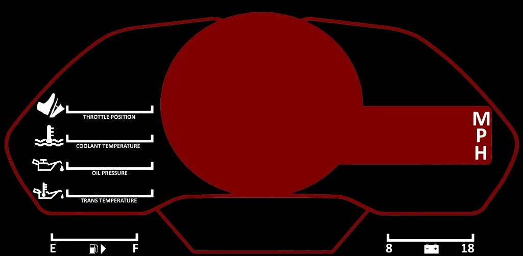

I have updated my previous tuning laptops dashboard display to the below draft background that will be used as the cars new digital dashboard. I moved some things around since a lot of the text wasn't visible on the smaller screen. This doesn't have the gauges on it yet (clearly) as I wanted everyone's input on layout. If you know of a different dash design I am all open to ideas.

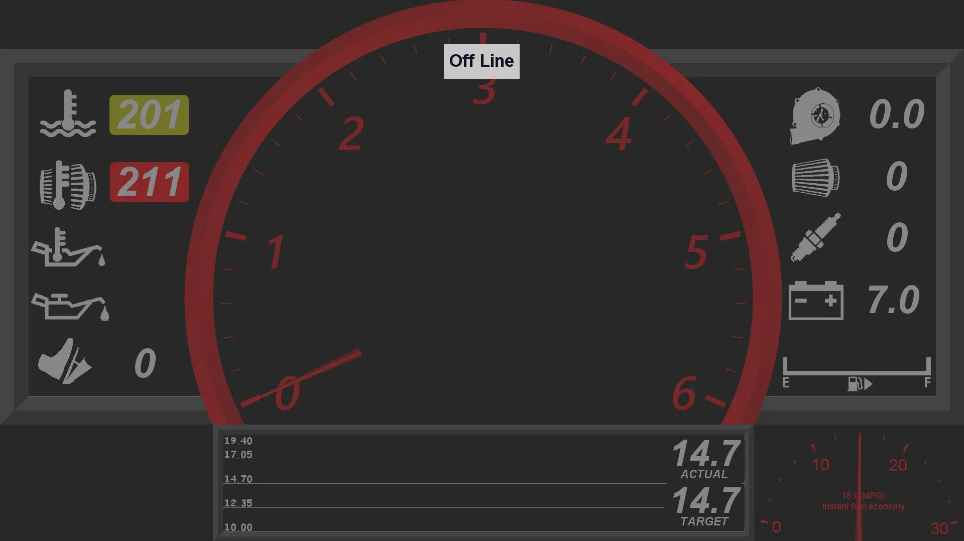

Yes, you are correct in that TunerStudio does have settings for 4 different levels that you can change the colors:
- Low Warning
- Low Critical
- High Warning
- High Critical
My current plan is to just display the digital value next to the icon rather than the traditional bar gauge. My original design had both the bar gauge and digital reading above it. I think this is just over kill.
This is Car Dash V3:
Ignore the 4 gauges at the bottom right as this is just a work in progress. I am thinking of having 5 gauges down each side as it seems to have room. I will have the MPH and Gear in the center of the Tach is the current thought as well.
Reactions: a91what
