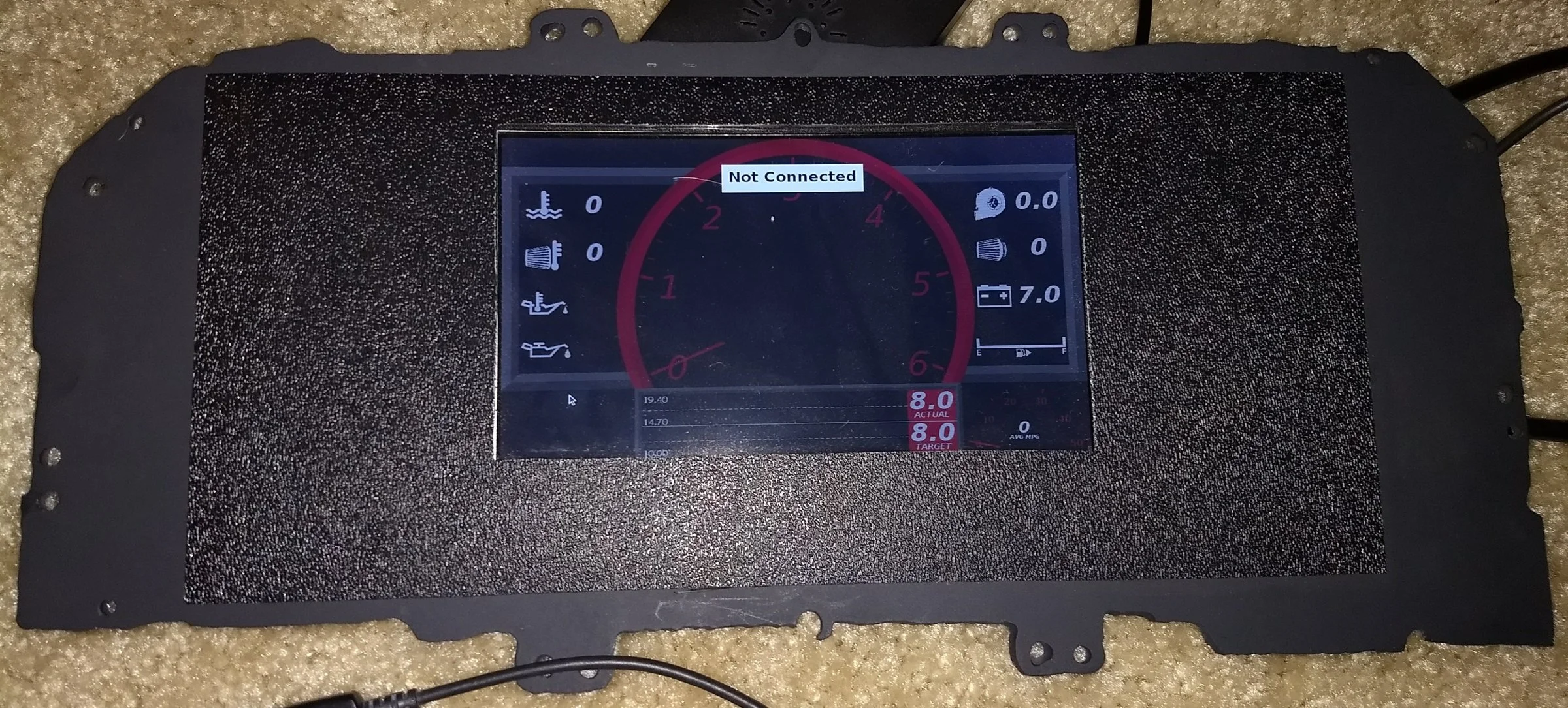

Well tonight was interesting with the digital dash that it took a little bit of and then doing some of to get past some issues I ran into. I was working on the boot-up process and found out there is an issue with the computer not autostarting in the correct location, so it boots twice. Not very good when you are trying to speed up the starting process. I was able download a corrected file to address this issues. It took my boot times for 42 sec to 35 sec currently. Not sure if I can get it any faster, but still need to work getting the splash screen to play my video at startup not at the end. Or maybe I will just change to shorter video. Not really sure just yet. Decisions decisions...
Here is the current dashboard display on the dash screen. It's much better than the first one as you can read it.
