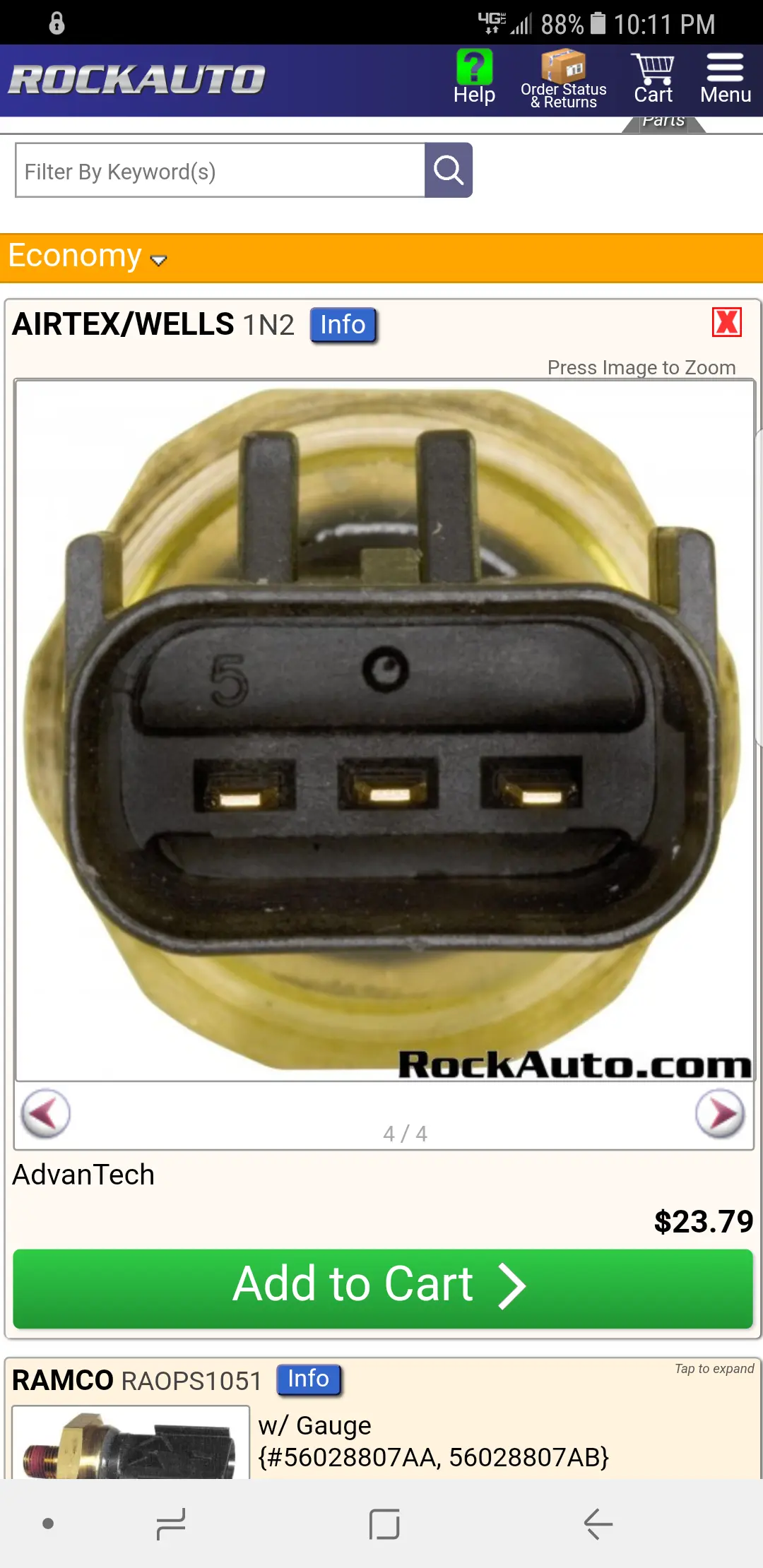

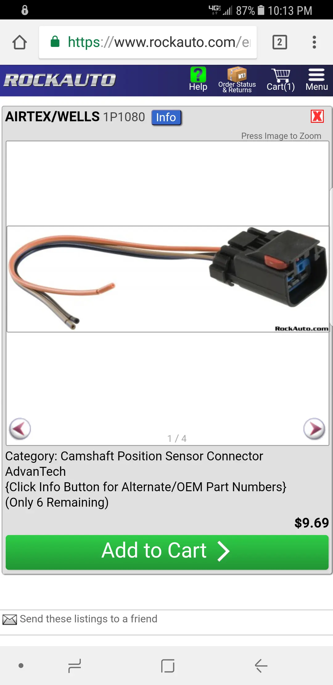

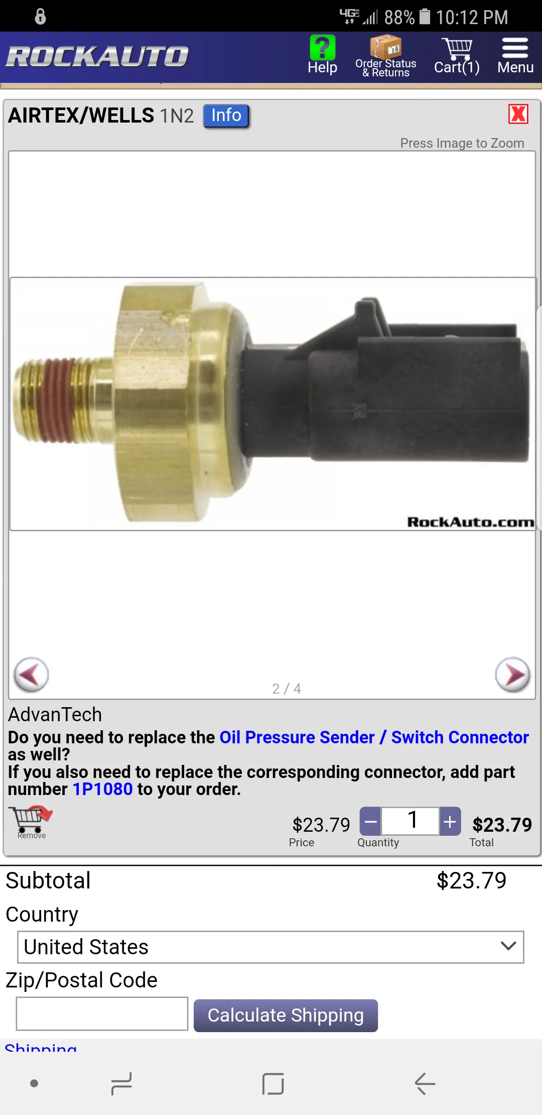

The Dodge caravans and Chrysler town and countrys have electronic oil pressure sensors that are pretty precise. The 3.6L has a dumb oil cooler that sits under the intake. It has the oil filter canister at one end and the sensor at the other. It reads from 0 to over 100 psi.
Our factory one could be used but I'm not sure how accurate it is.

This is good. These sensors can be used for many fluid pressure readings...

Thank you! This is a lot sheaper than the AEM one I have been looking into: Amazon product ASIN B002NT7HK2View: https://www.amazon.com/AEM-30-2131-100-PSIG-Brass-Sensor/dp/B002NT7HK2
@a91what Do you think these sensors are the same voltage range as most digital oil pressure sensors? 0V = 0 psi 4.5V = 100 psi

Thats hard to say... best way to test it would be to simply hook it up to a regulated air supply... take the reading at atmosphere [0psi] then at 50psi then at 100psi record your voltage readings and see if the sensor has a linear output. [it should]

short answer is no...
I would find a suitable 0-5v sensor to use. [there is a list out there somewhere on easily attainable sensors known to work easily with ms they even have the voltage range spelled out for you.
here is an example
http://www.msextra.com/forums/viewtopic.php?f=131&t=41192
