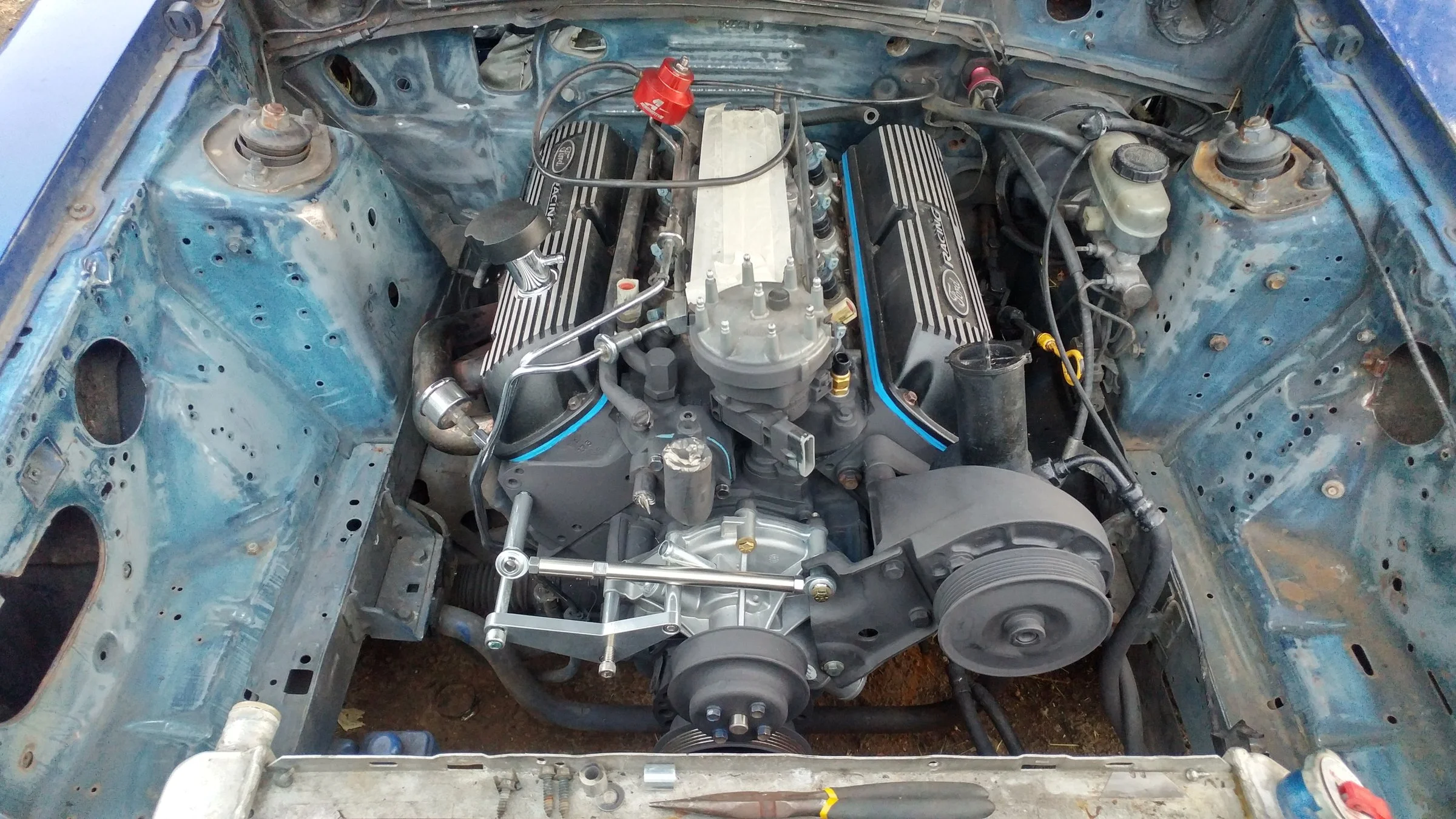

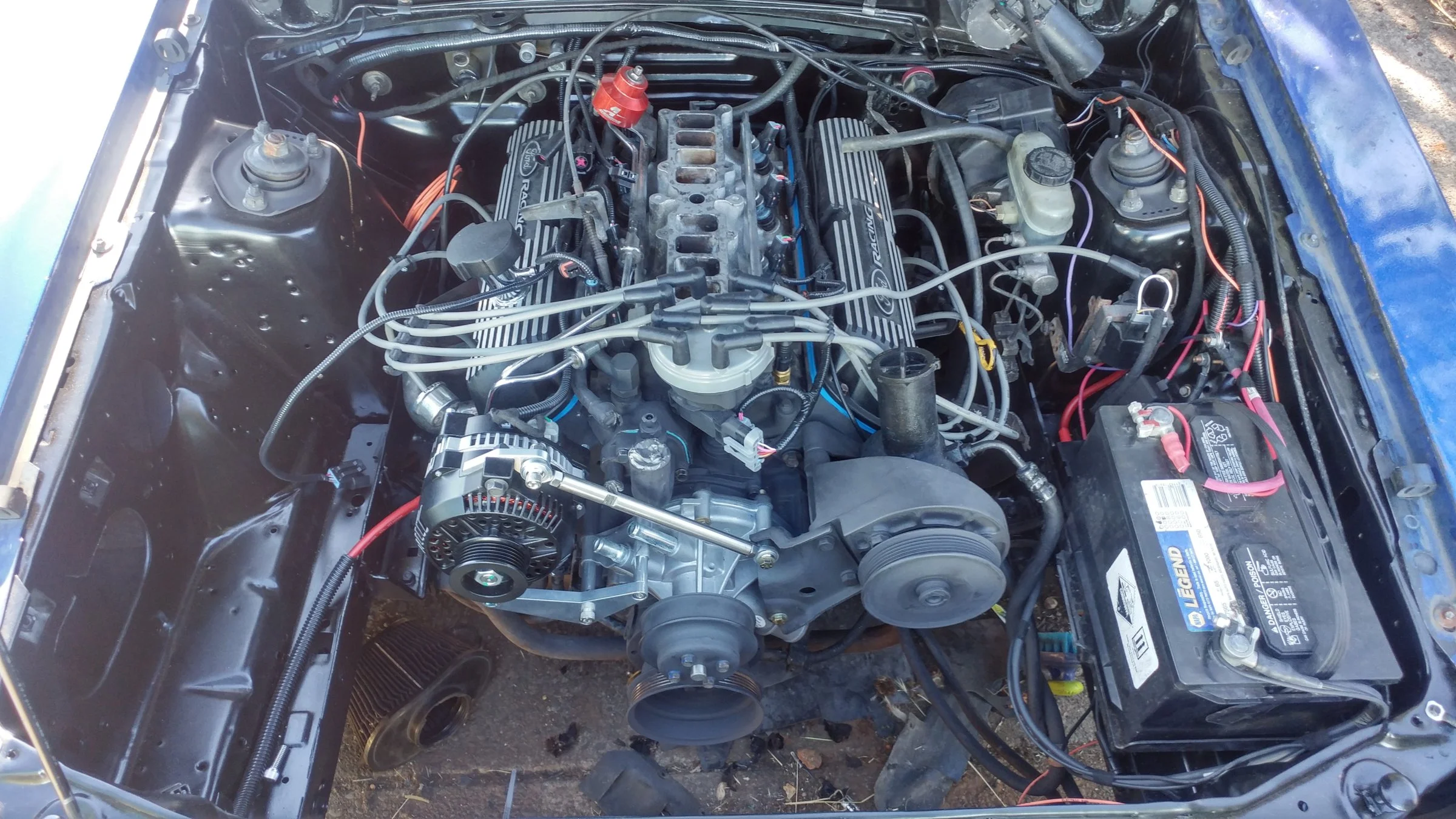

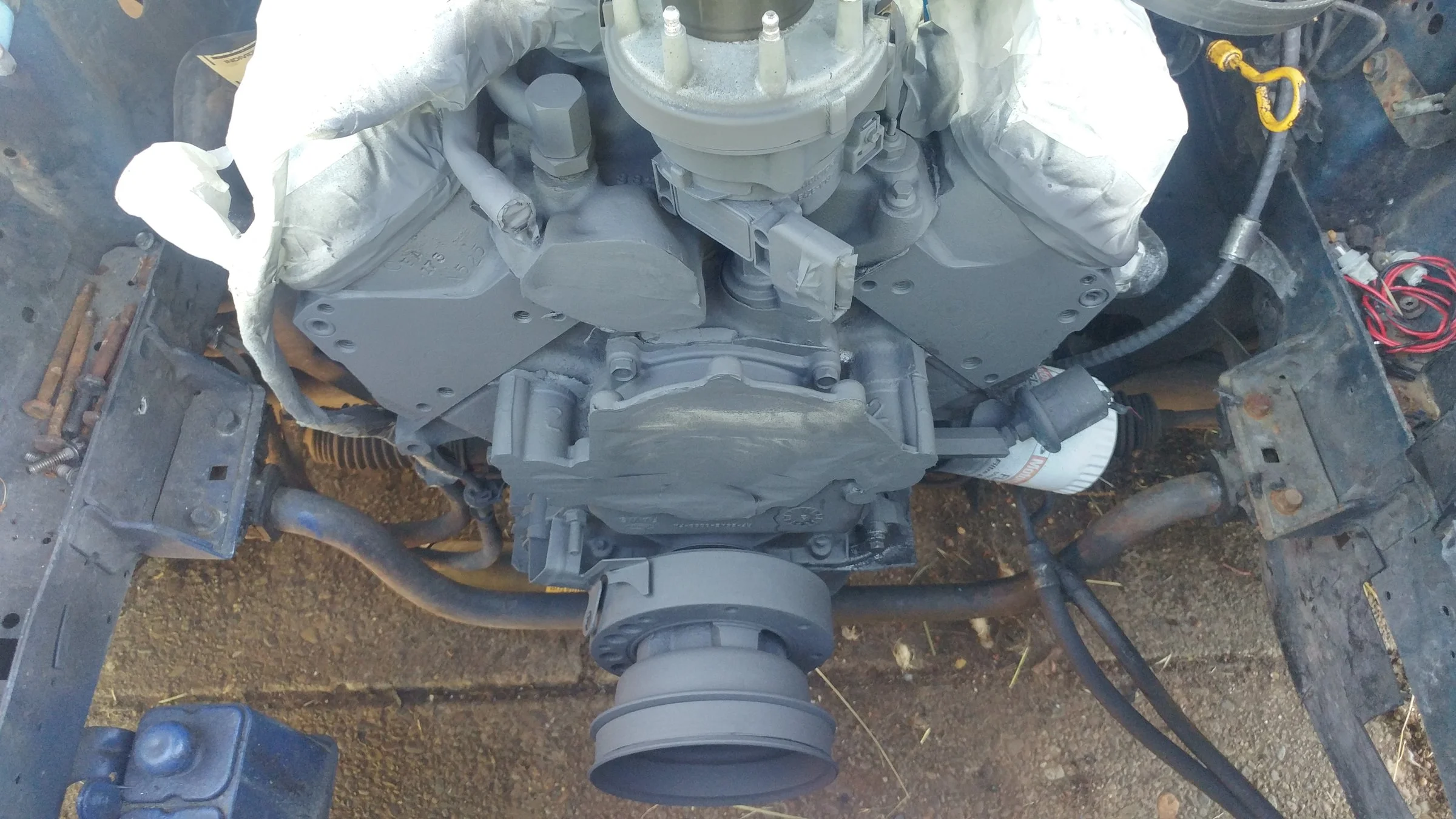

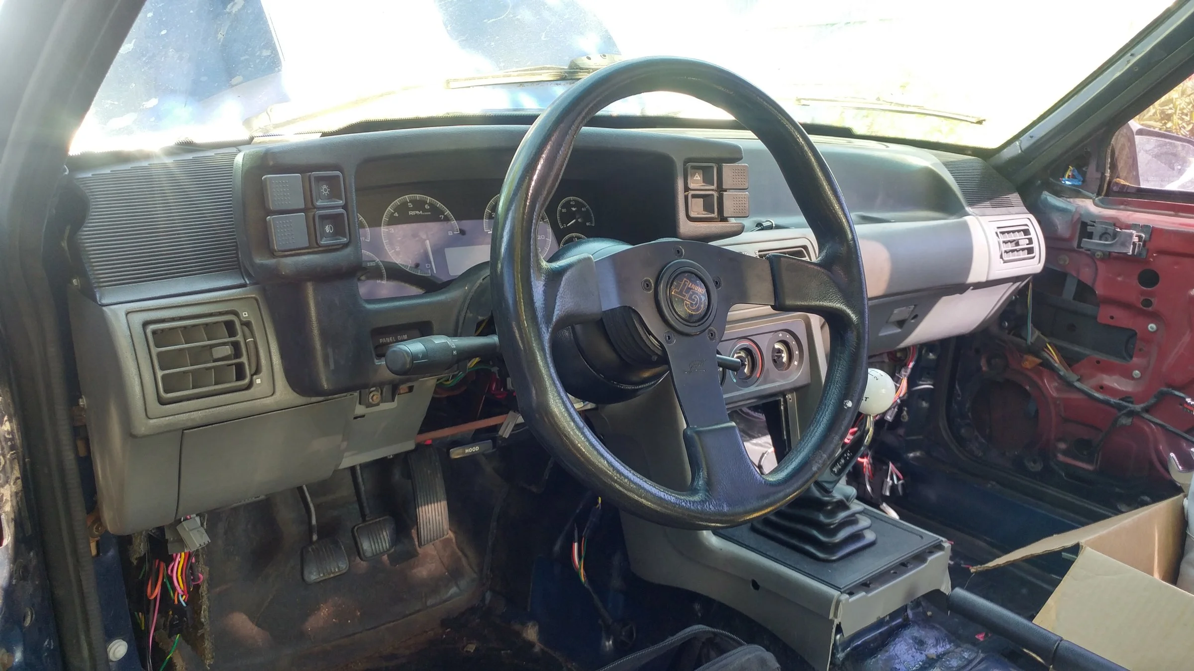

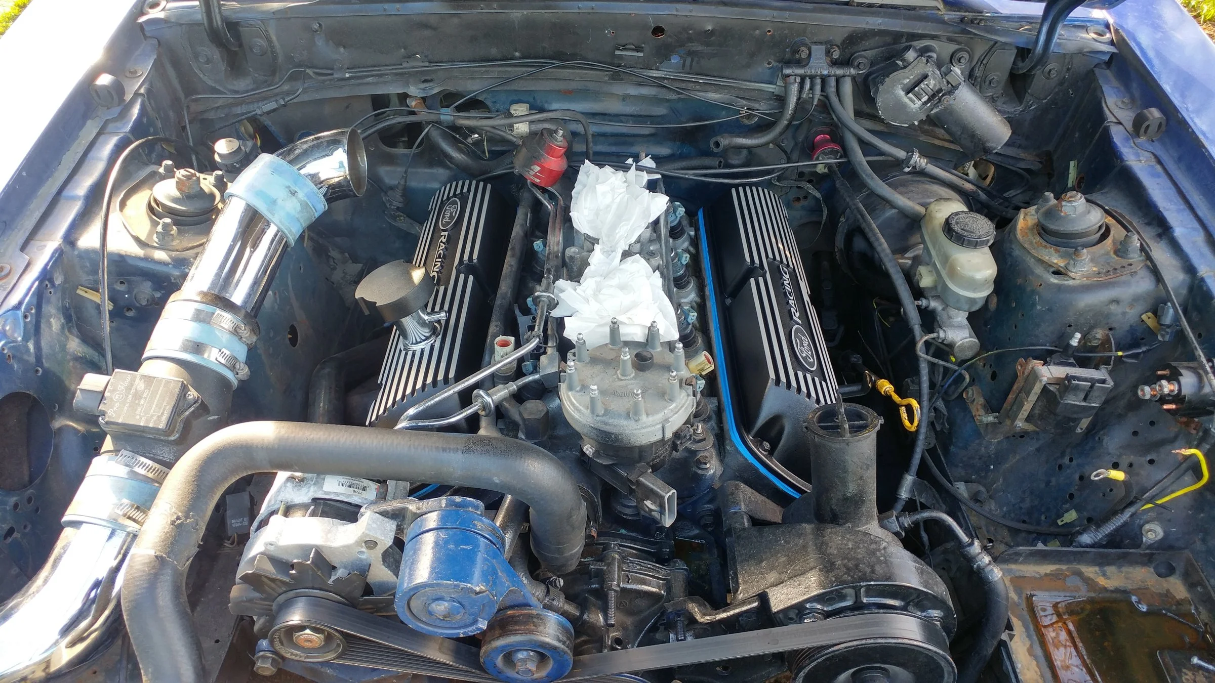

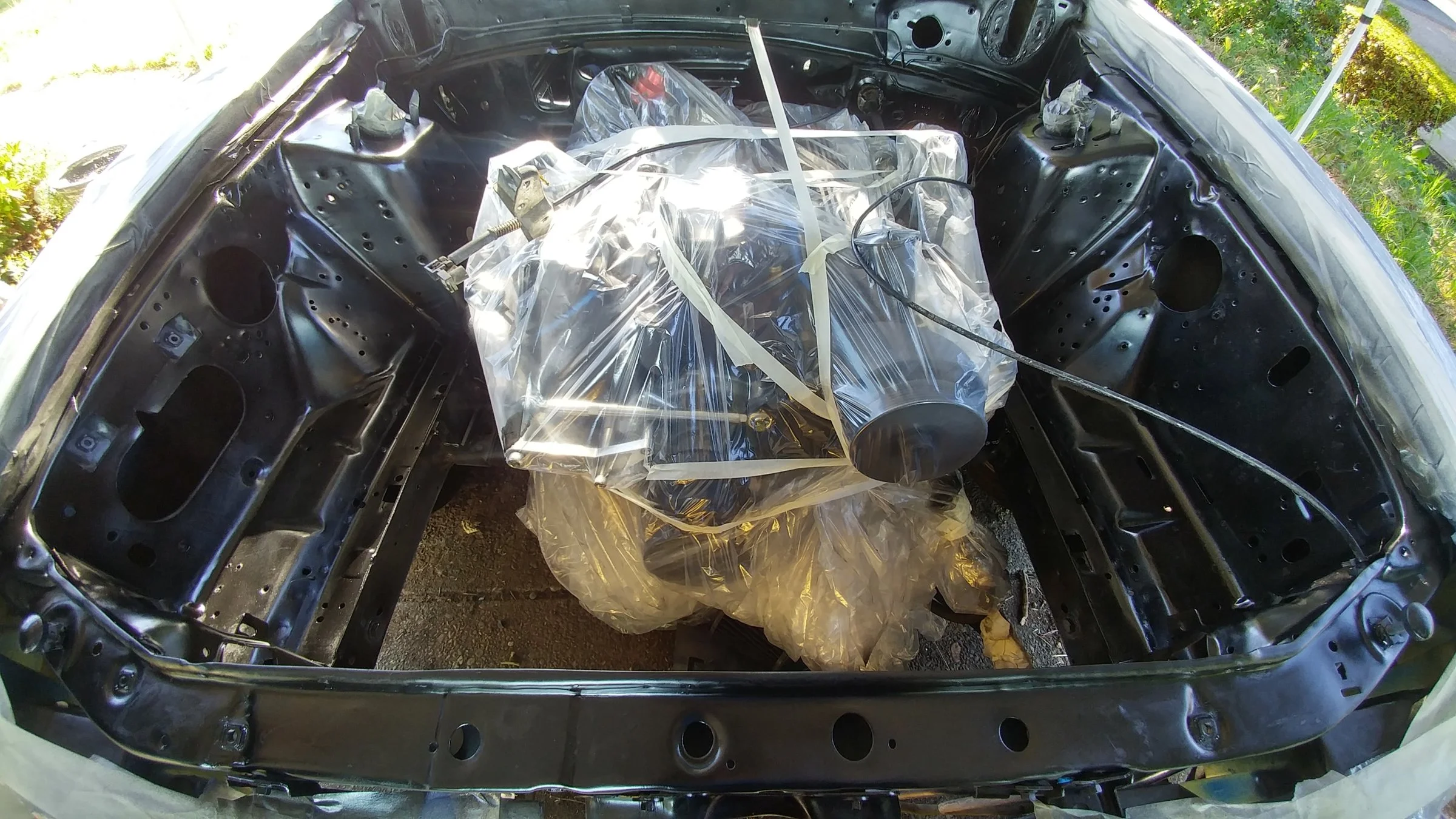

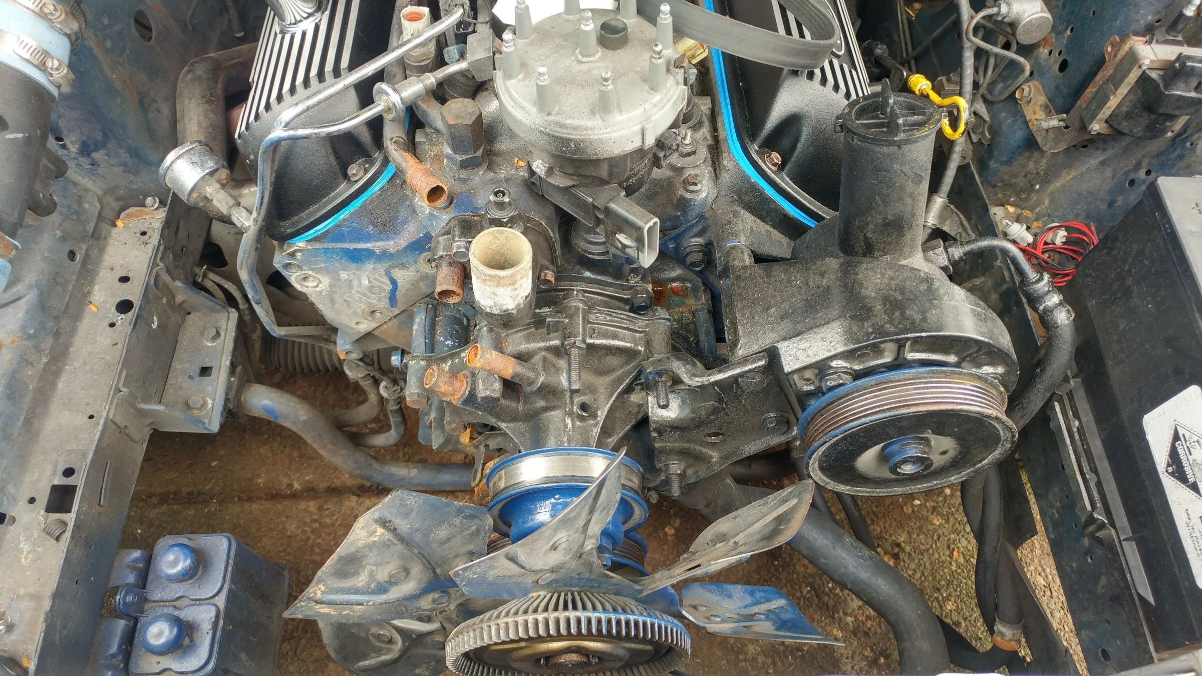

IM BACK! I got some updates too! I have done a lot of work and still have a bit but here is some pictures!
Started tearing it down. Looking pretty gross. Haha

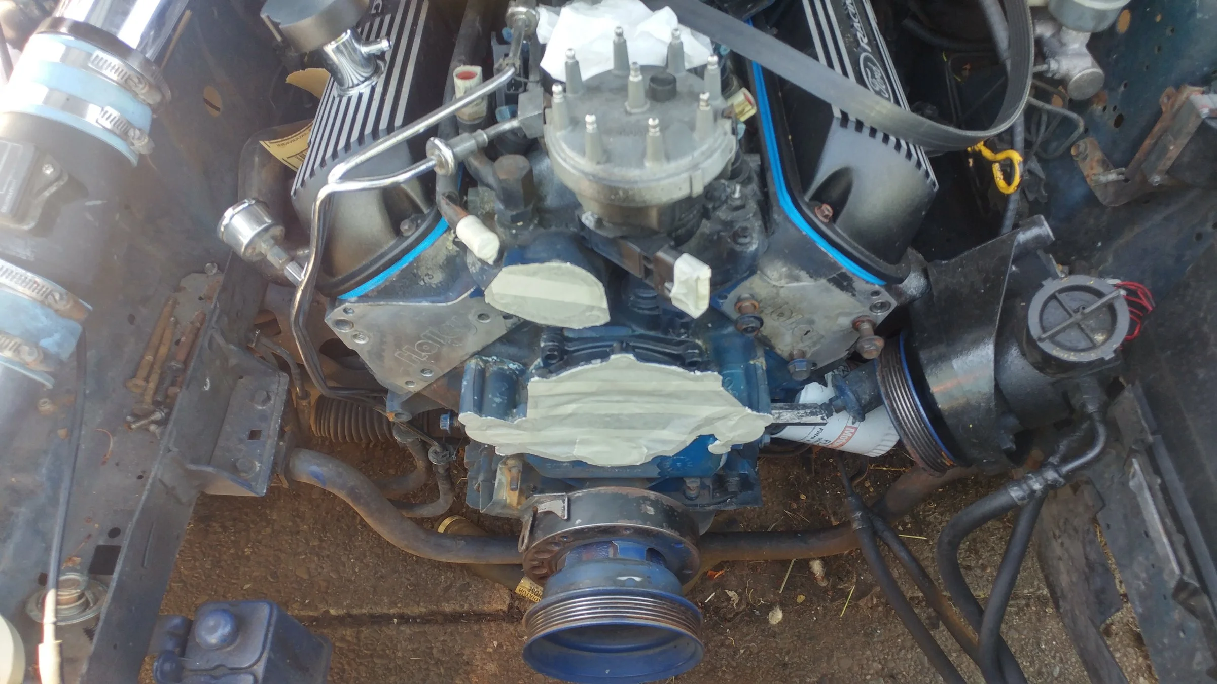

Started prepping for paint! Don't judge, I never planned to do it properly, I just wanted this one to look... Not as ghetto. Note: I taped too much of the TFI module. It looks ugly later. I'll probably remove it and paint it again or replace it. lol
Painted.

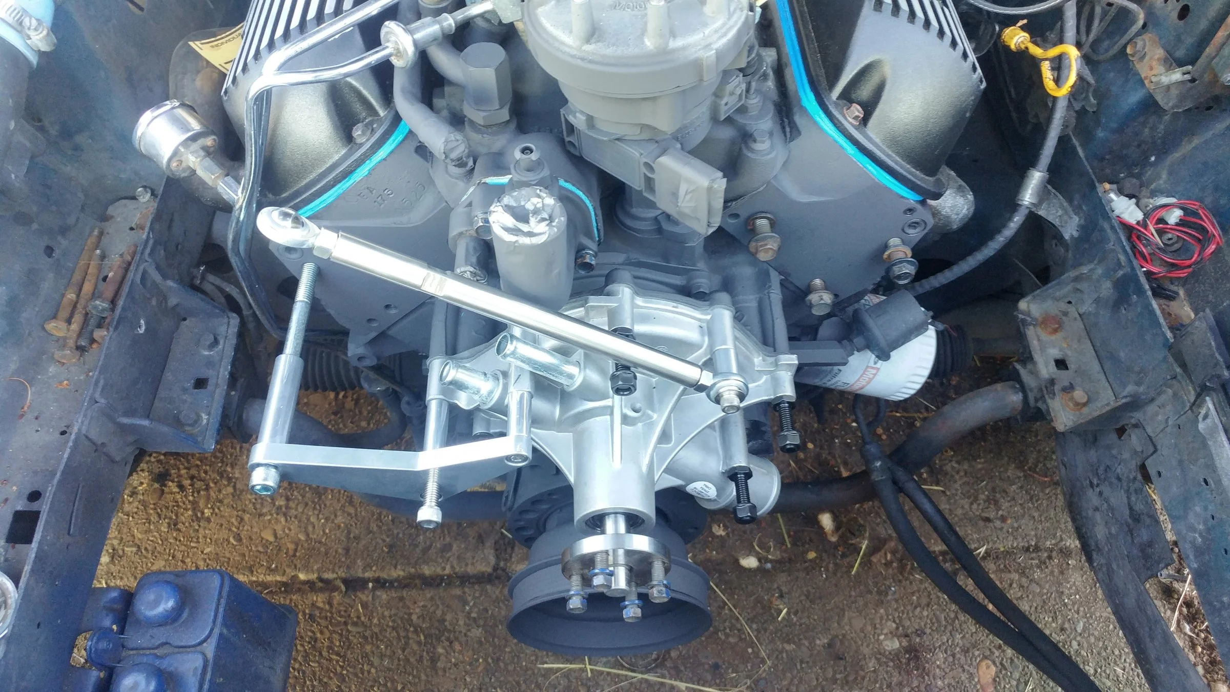

New water pump, March performance alternator bracket. I had ARP bolts for it, but when I had it all together, I realized I could only use like two of the bolts from the kit. So I just replaced them with grade 8 as well and will sell the kit. Whoops
Engine bay prepped.
Painted with Semi-gloss black

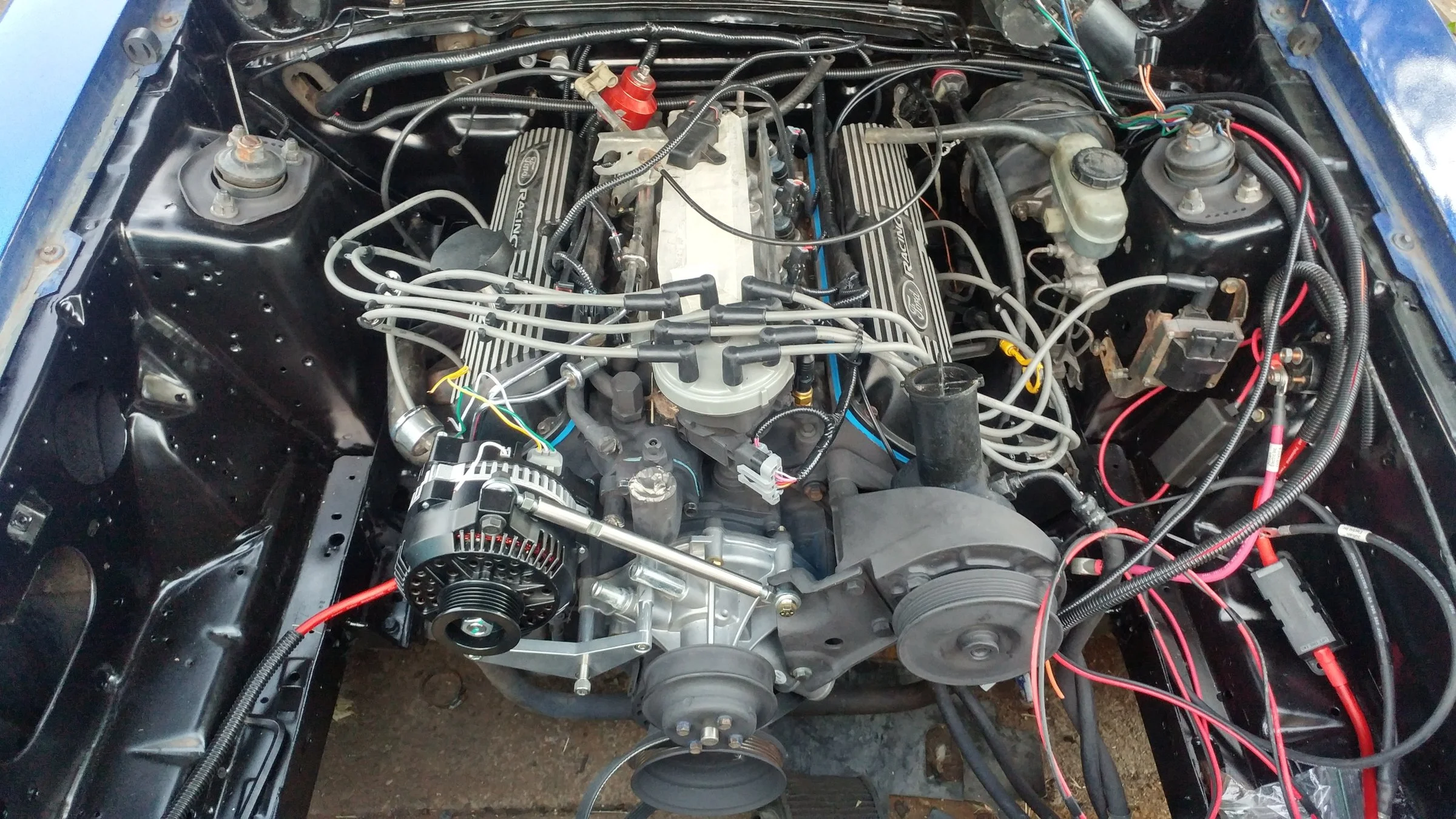

Assembled. New engine harness installed, most of the wiring completed, new dist cap, rotor and plug wires and SVE 3G alternator kit. The belt tensioner comes in contact with the alternator housing, and the lock nut is stuck against it as well, so I had to purchase another little bracket from march performance to work correctly with the 3G alternator.
Where we are at now. I got most of the wire loomed and where it needs to go, still have to figure out a few things though. I'm no professional. The wiring is kinda crazy around the starter relay, but bear with me, I have no control over some of this, and I'm not done yet. Someday I plan to remove the fender and hide some of it behind there. BUT my favorite part is that it all makes sense now, and is clean and I can follow a wire if I need to.
Look at those beautiful gauges! So far I'm very impressed!
I will be back with more things! I have not included everything and have more pictures to show, but here's something. I hope you find the progress as satisfying as I do!
