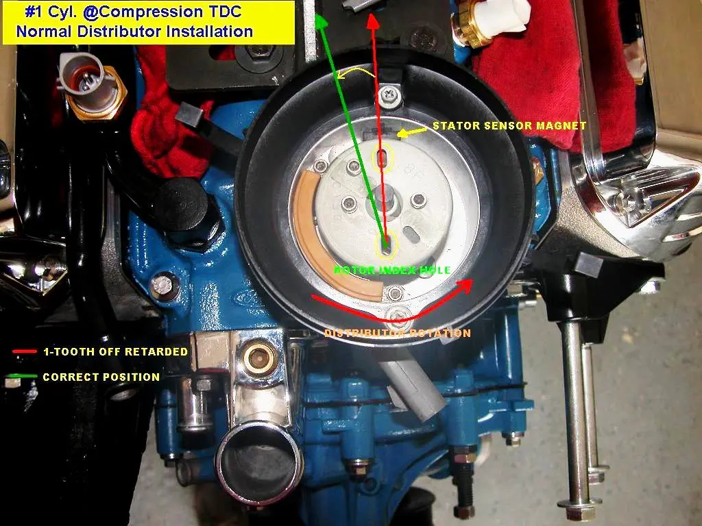

I'd appreciate any help with this problem. My '89 mustang Fox body 5.0 high output will only start after I clear the computer by unplugging the battery and turning on the headlights for a little bit. I plug it back in and I can get the thing to turn over and start on the first try. It'll start for about 20 seconds it's got some stumbles it's not perfect and then it dies. I can smell gas and it will not start up after that. Seems like it's flooded. The work that's been done is replaced the distributor it's on time I think I pointed the distributor dead center at the number one with it at 0°. And yes currently the spout connector is removed. Any thoughts

Base timing is supposed to be 10degBTDC.

So at the 10° before top dead center mark I should set the distributor rotor pointed directly dead center at number one is that correct?

Setting the balancer at 0* and the rotor at #1 on cap should get you started and then set the timing @ 10* with a timing light but since your engine will not start don't worry about that step yet.
First thing I would do is make sure I have the engine at TDC on the compression stroke, also pull the plugs to check for fouling, plugs are cheap.
No, that would retard the timing.
