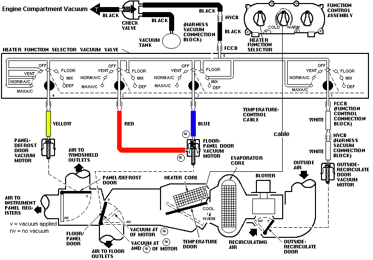

My 89 doesnt have heat but the ac works. No matter where the i turn the knob to it all blows out the defroster duct onto the winshield. Is this a vaccumm line problem behind the heater/ac controls? Thanks Dustin
edit: sorry, i should have searched first, please delet.
The vacuum has nothing to do with your temperature control knob.
The temperature control knob has a black shielded cable with wire inside that is either pushed or pulled when you turn temperature control knob.
