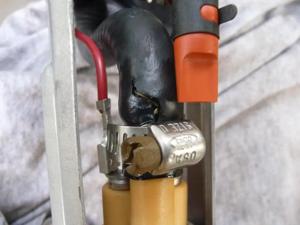

There is a short S hose that goes between the fuel pump and hangar connection. It has a tendency to split and might be your problem. I upgraded my fuel pump about a month ago and found this hose was about to let go on my car.
If that's the case I will find out on wednesday and update if so. I prob should have checked that before getting the new pump, but with a half tank currently I'd prefer to only drop the tank once...

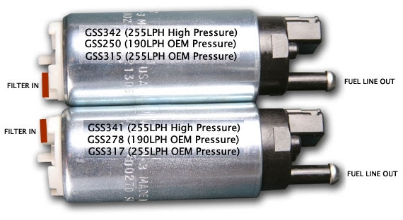

I ran the 255 with the stock ECU no issue. I still get my 34psi at idle now with the gss255lph hp pump in tank. :shrug: maybe I got lucky or I have it mixed up in my mind with the 225hp version.
It could be because there are now many different 255''s, mine maintains pressure at high flow, I think it's the GSS342.
https://walbrofuelpumps.com/walbro-gss-fuel-pumps
4 different 255's shown here.
