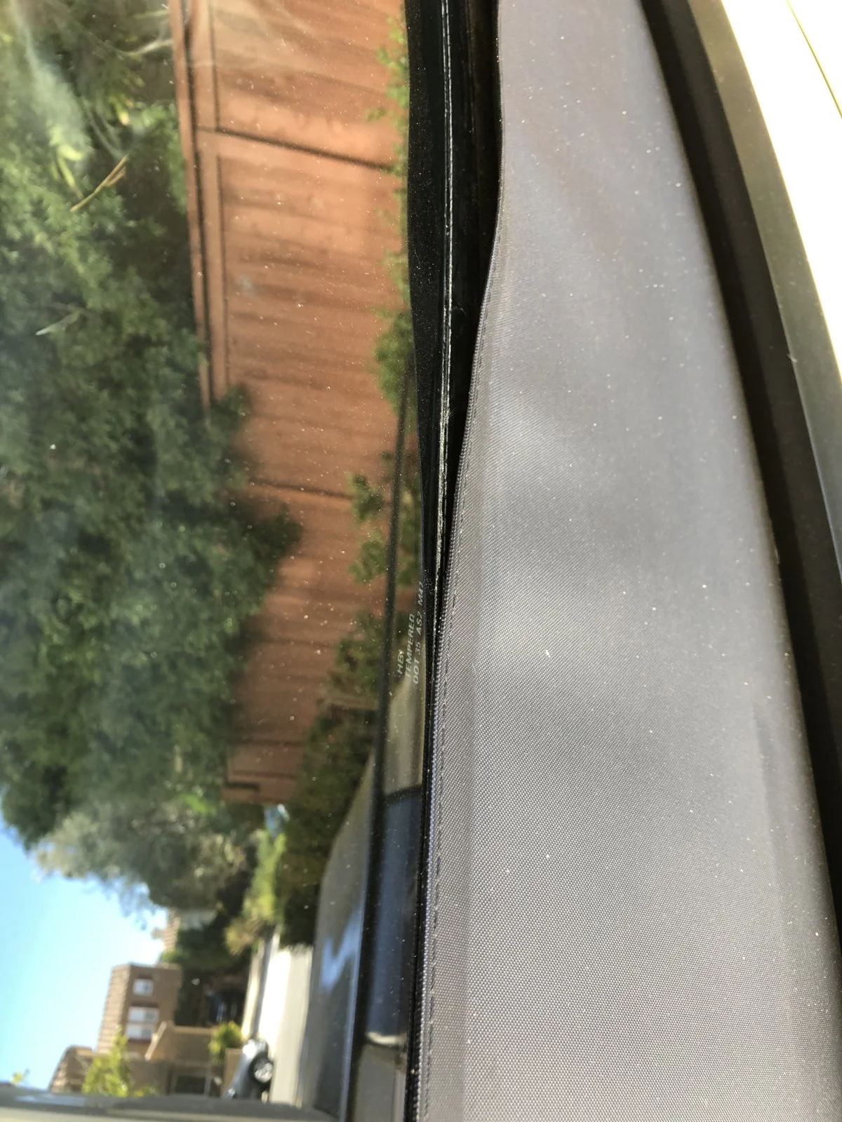

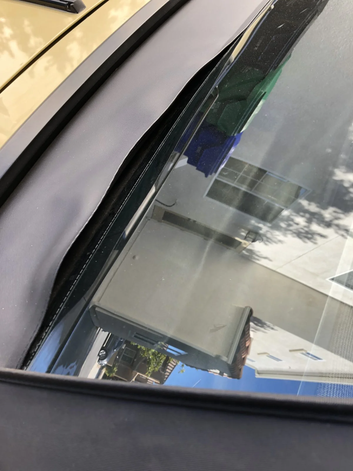

Rear glass coming apart from top material, is there a fix for this or does the top need to be replaced?

I spoke to a guy today at a top shop here in San Diego and the guy said he wants to remove and reseal out of the car for $250. Seems like the top is over stretched or shrank to have caused this unless it’s a defect?

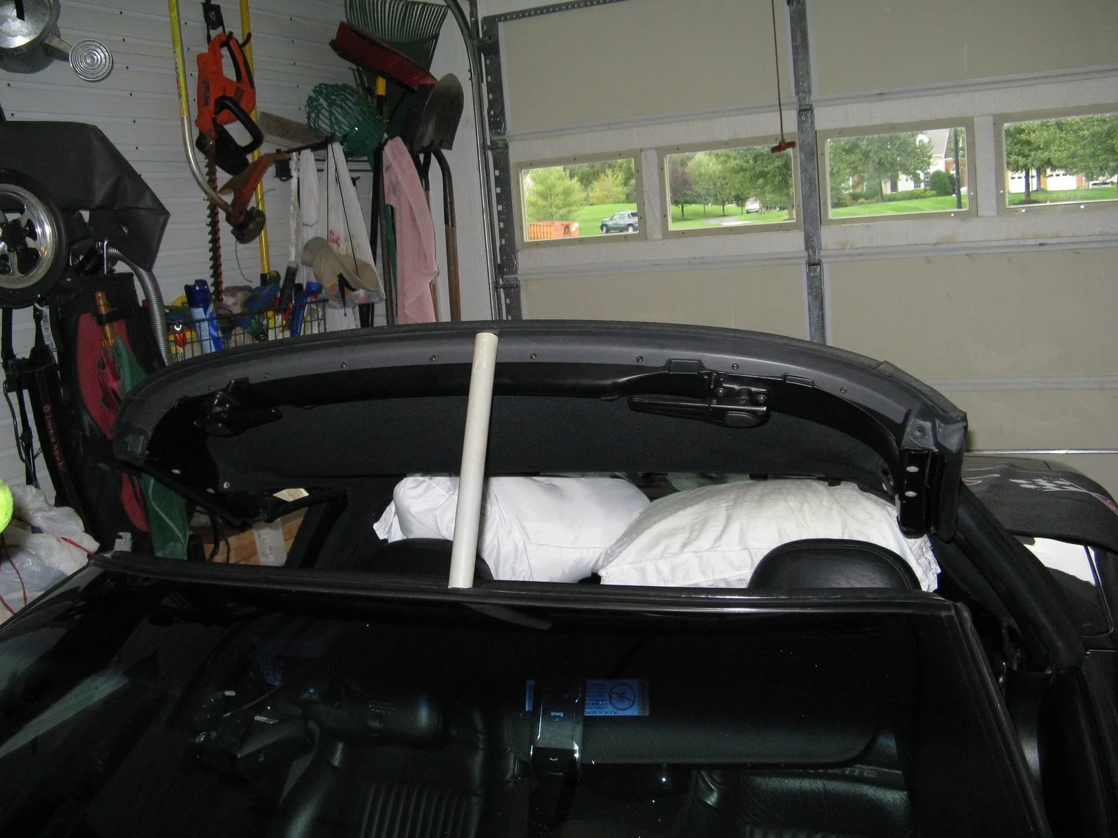

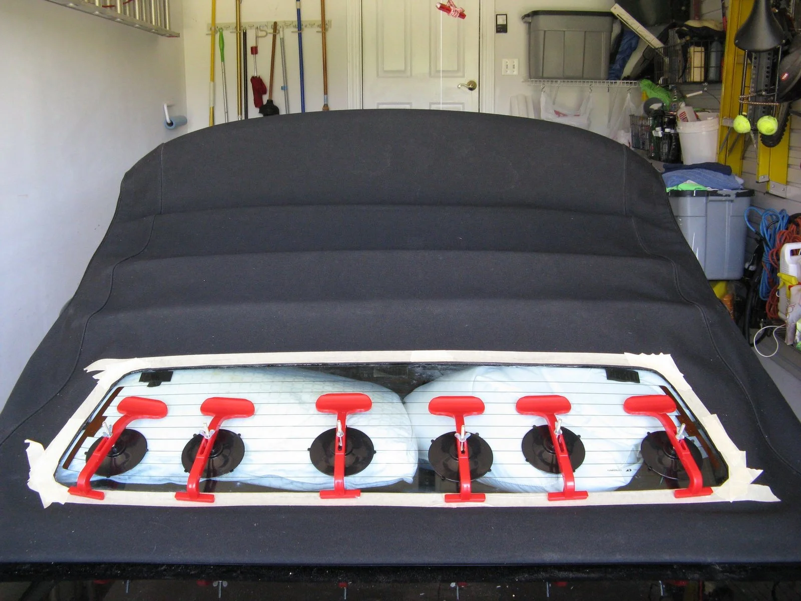

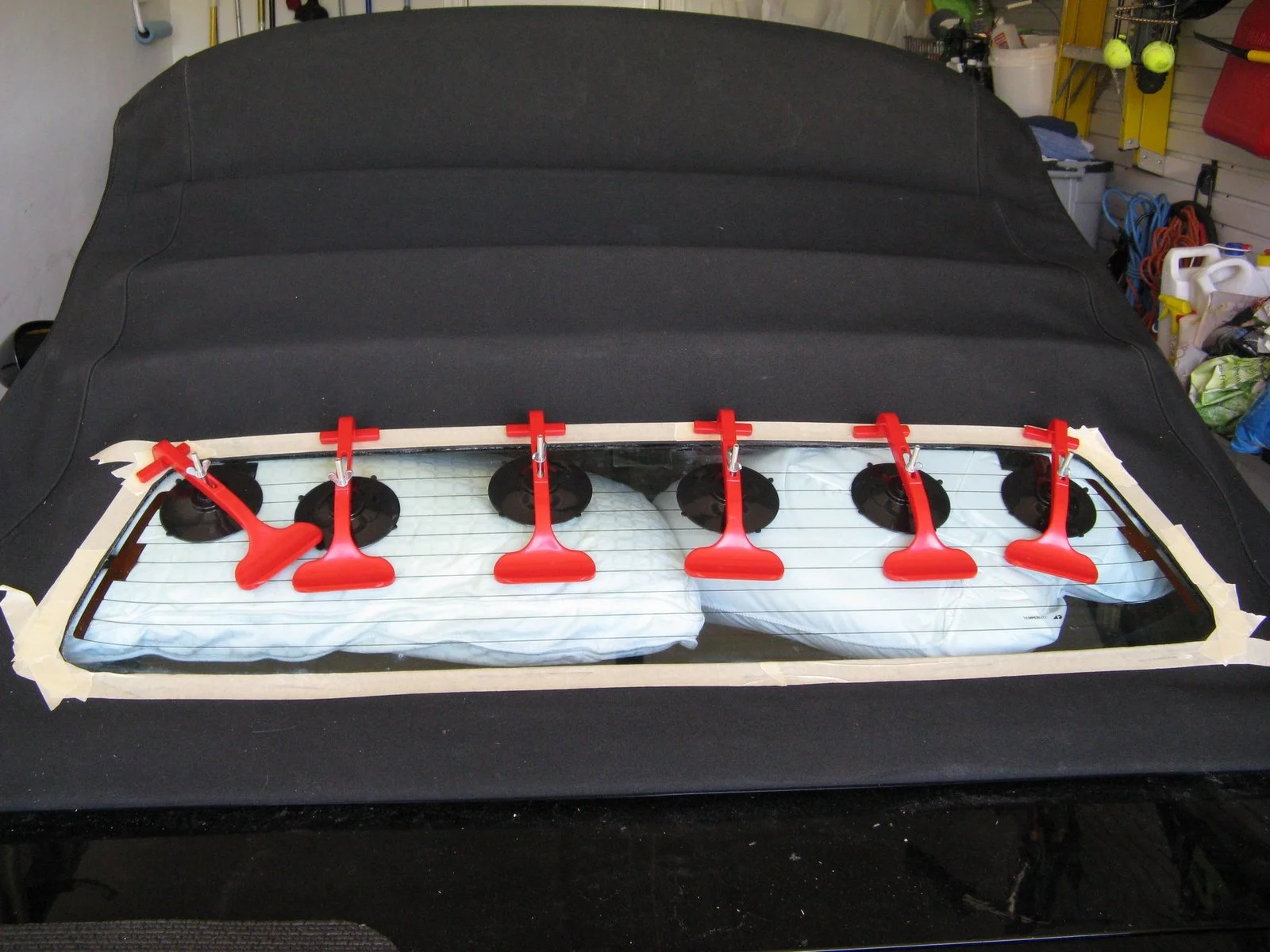

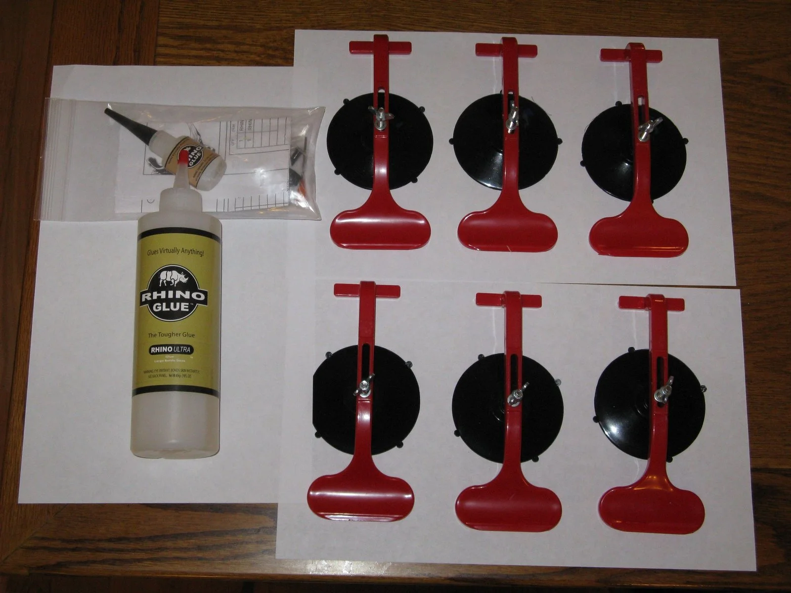

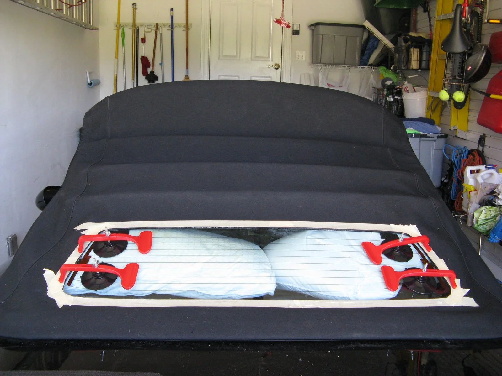

Here is what I did over a year ago and it is still holding.
Bought Rhino Ultra Glue and “Universal Vacuum Clamps” (six in a box) on the Internet.
Unlatched the top to loosen the fabric. Supported the top with a piece of PVC piping. Stuffed pillows against the window from the inside.
Removed the old glue stuff from the glass using a glass scraper. Cleaned the fabric and glass with rubbing alcohol and glue remover. Masked the outside fabric as a protection against any glue run off. Glued glass top first using all 6 clamps. Clamps stayed on for 12 hours for each application.
The two sides were done next.
Last was the glass bottom.
Reactions: Calidude25

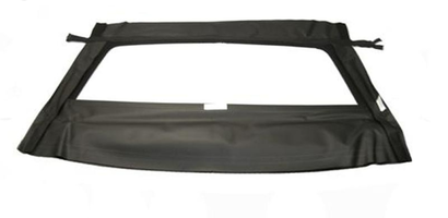

If the guy at the top shop is going to remove the window to repair it that doesn't make sense to me. If he's going to remove the window, just install a new one. Rear windows for our convertibles are inexpensive, about $150.

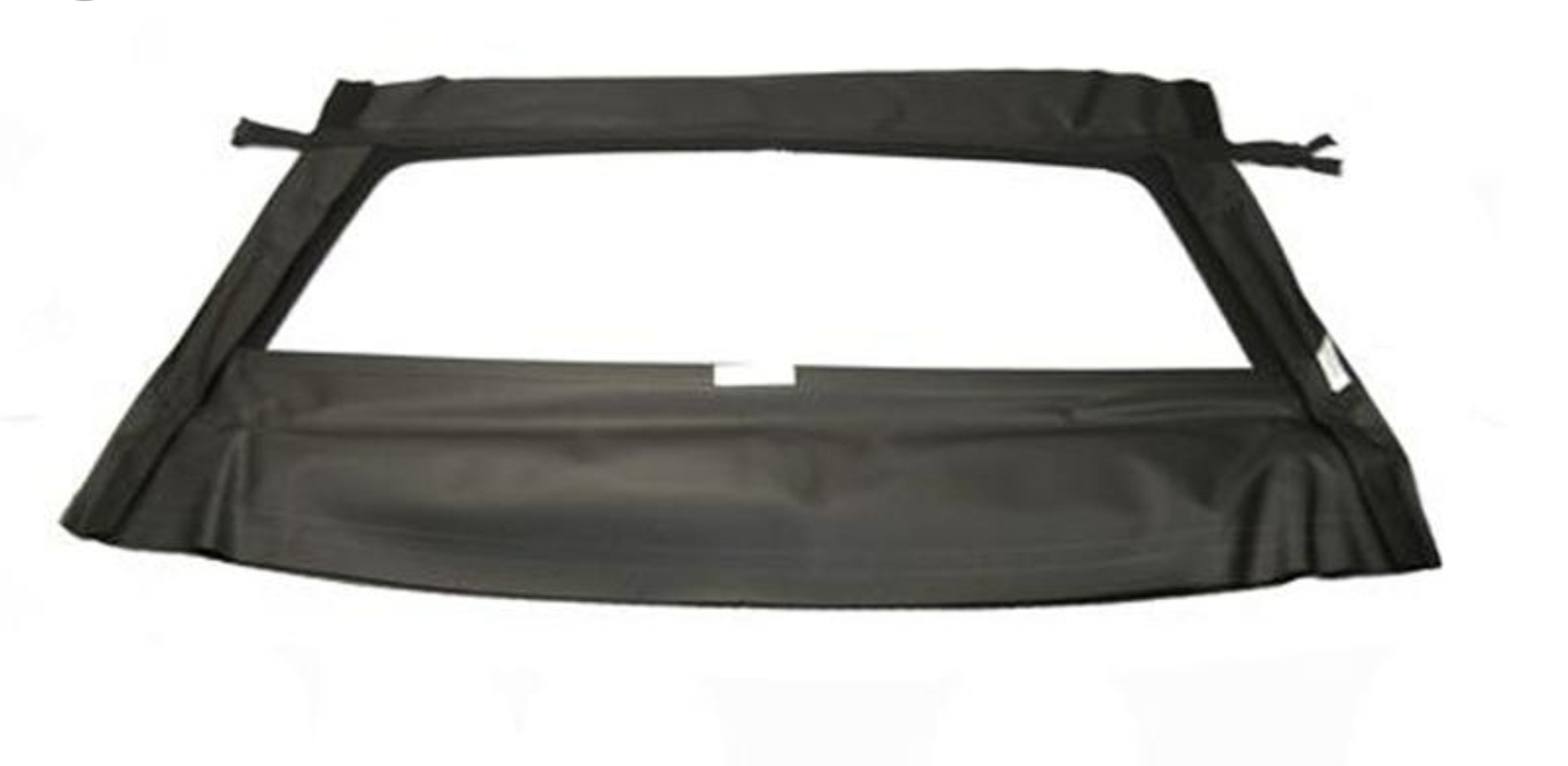

yup just replace the rear window assembly. just make sure the zipper portion (on the rear window) matches the existing one (on the top assembly)...from my experience, there are larger zippers and there are smaller zippers...when i mention size, i mean the zipper teeth. found that out the hard way.
Chances are slim that the zipper will match, and if that’s the case, you have to peel the top over the rear frame, and remove the upper zipper and staple the new one into place.
