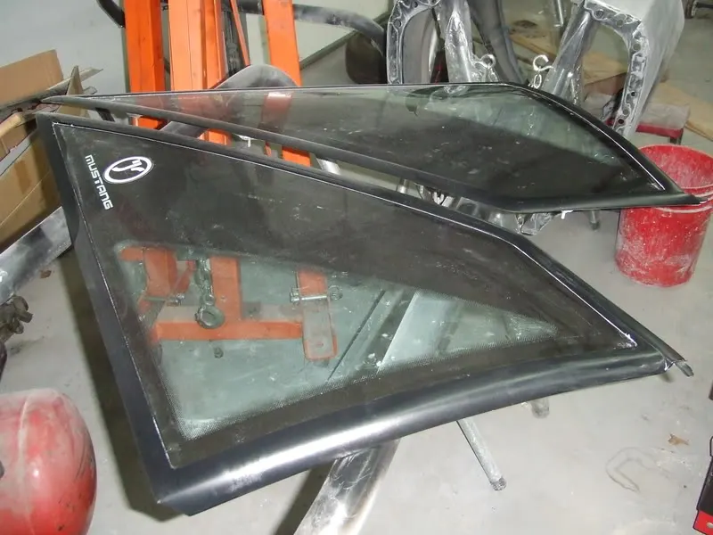

The rubber is part of the glass. YOu can get repo ones now but they dont have the mustang on the glass. YOu can fix the ones you have if they are not too bad. You use plastic epoxy filler by 3M and coats of flexible black paint.

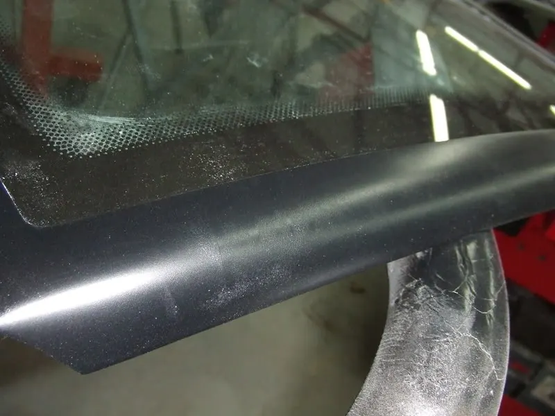

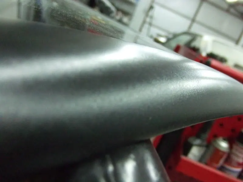

an easier way is just to spray thick coats of a high build primer. spray, sand, spray, sand, etc until they're smooth, then lay on some black trim paint. i did mine this way.
ignore all the white dirtyness, it's body filler dust...
