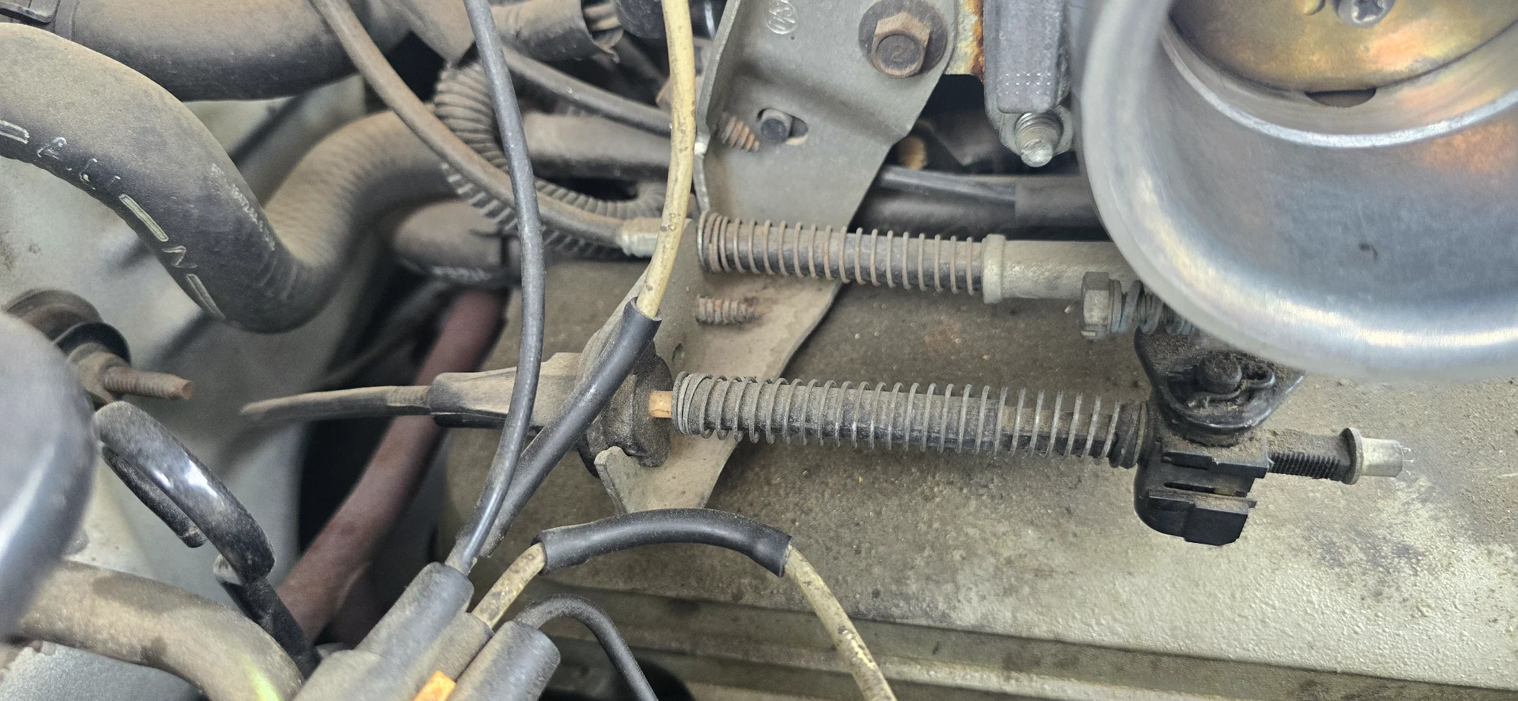

Fuel pressure check is good, I pulled the main upper intake off. I ordered the OBD1 code reader.
No aftermarket parts. It's 100% original still. After I replace the broken vacuum line the car is running smoother but I have not tested it since I was worried the guy at Ford told me it was a transmission issue. I do have a new transmission pan with a drain plug being delivered tomorrow so I can change the pan out run it through the neighborhood so that way I can try to drain the torque converter of all the previous fluid. Also I'm changing out the rear differential fluid because I'm pretty sure it's never been changed before. I am just the third owner of it and my aunt who passed away has owned it since 2001.
The white line was the broken line and I replaced it with a kit from LMR. We thought maybe that the bushing had gone out on the on the TV cable put it was intact but I went ahead and replaced it with a new brass bushing and clip.
