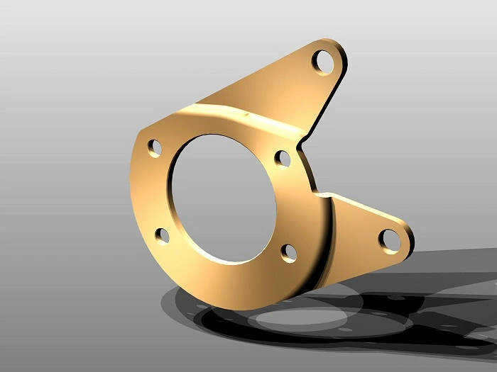

Not to highjack the thread, but I'm doing SN95 rears on my own big bearing 9".
Being a product developer by trade I looked at the brackets out there and decided to make some myself. How hard can it be? :rolleyes: :nonono: In my own defense I should mention that I'm in Denmark, so it's always a hazzle to ship stuff here it seems.
I'll be offering the brackets to others interested and will have them in quantity in approx. 3 weeks. Pricing TBD but don't expect cheap... They'll come with instructions, disc centering rings (if you're not running Moser axles), all hardware. No calipers or discs - it would be a bit stupid to ship heavy parts made in the USA to Denmark and then back again! :p
Below is a pic of the CAD model for the left side pre-production bracket (prototype all done and tested). The actual bracket will be milled tuesday and then test fitted on my 69 and a 70 with Moser axles. Can't see it from this angle, but there is a lip if you want to weld it to the axle plate. Some people here want that. It's billet machined steel, weight is 480g each.
