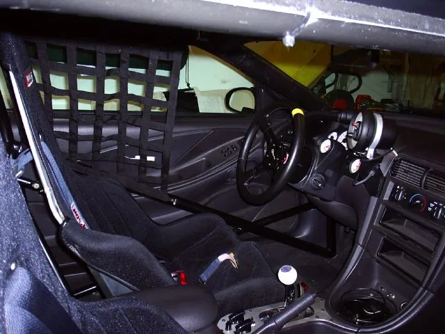

A 5 gallon fuel cell is going in this week and a Skinny Kid race wing next week. At that point, I will not drive it on the street anymore. The car weighs around 3200 pounds with me in it and is making around 750 rwhp.
Jim is your cage moly or mild steel? I didn't see what rear gear ratio you were running?
Do you know what the car weighs without you in it? I will be doing some weight reduction in the near future, so I just want to get some ideas as to what other cars are weighing.
The cage is chromoly steel. The car weighs around 3000 without me, but is in the process of losing the stock fuel tank, etc. I recently changed from 4.10 to 3.55 gears.
Thanks for the reply. Do you happen to have any pics of your cage install? I would appreciate seing some.

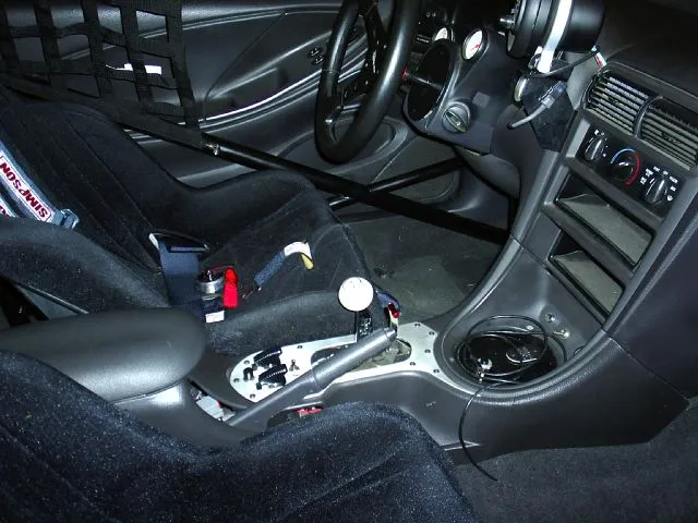

Here's some pictures of the cage installed. I don't have any of the install itself...
http://i43.photobucket.com/albums/e373/jimfitzgerald/PIC_0642.jpg
http://i43.photobucket.com/albums/e373/jimfitzgerald/PIC_0644.jpg
http://i43.photobucket.com/albums/e373/jimfitzgerald/PIC_0646.jpg
http://i43.photobucket.com/albums/e373/jimfitzgerald/PIC_0647.jpg
