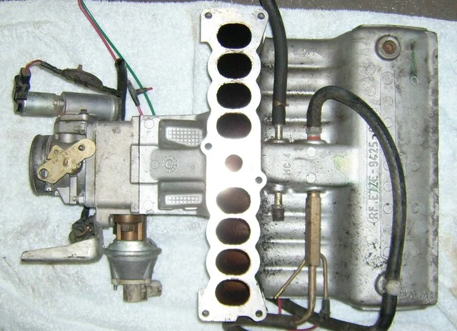

attachments\58191
It does not weigh but a pound or so and helps richen up the cruse mixture. It draws no HP & keeps the car from smelling like gasoline in a closed garage. So with all these good things and no bad ones, why not hook it up & use it?
The purge valve solenoid connector is a dangling wire that is near the ECT sensor and oil filler on the passenger side rocker cover. The actual solenoid valve is down next to the carbon canister. There is about 12"-16" of wire that runs parallel to the canister vent hose that comes off the bottom side of the upper intake manifold. That hose connects one port of the solenoid valve; the other port connects to the carbon canister.
The purge valve solenoid should be available at your local auto parts store.
Purge valve solenoid:
The carbon canister is normally mounted on the passenger side frame rail near the smog pump pulley.
Carbon Canister:

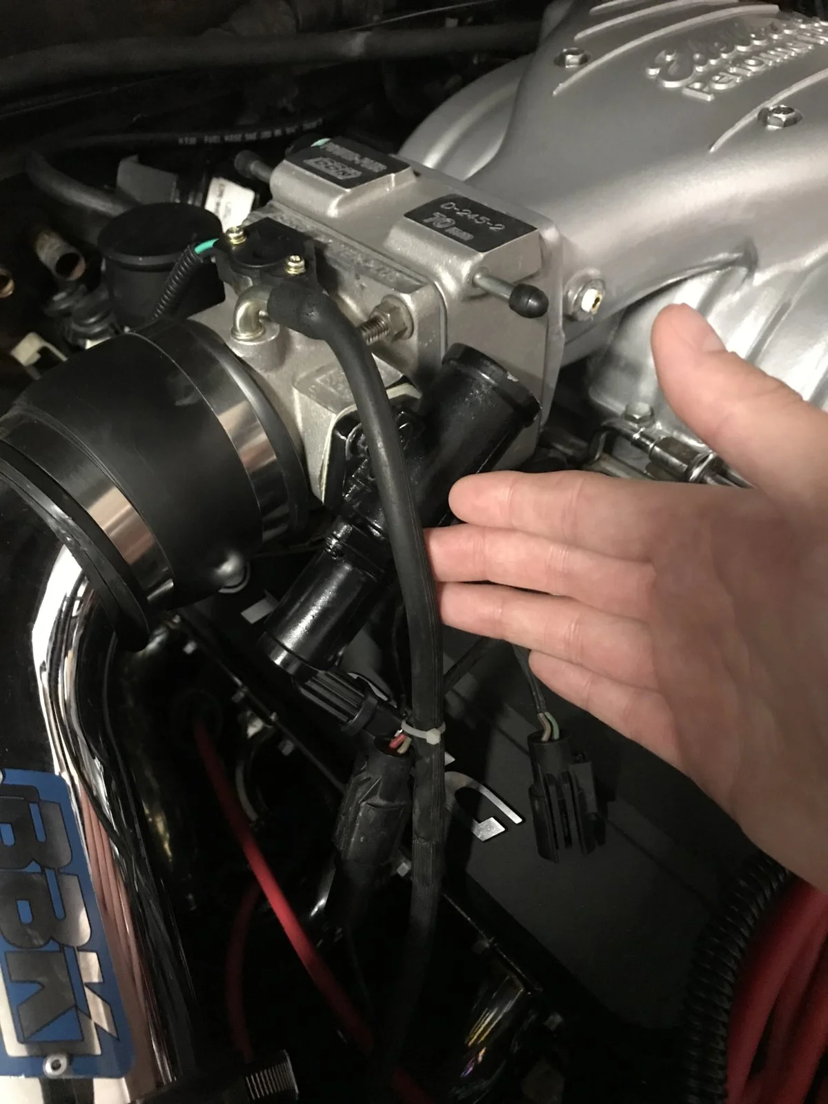

The charcoal canister is there. I have an Edelbrock Performer RPM 2 intake, I removed the plumbing to heater core as it is cracked and I don’t need heat. The vaccume tube is connected to the throttle body.. is that okay? Or where should I route it?
I noticed I only have the canister purge solinoid plugged in. But the engine coolant temp sensor is not as it would have plugged into that metal piping that would run into the heater core.

That's odd the canister purge is connected to the PCV port on the throttle body. That port is before the throttle blade and doesn't provide vacuum. The canister purge should going into intake where that little plug is to the right of the EGR spacer. Do you have a PCV system?
That's not where that vac line should be routed to. It should run to the manifold itself and there's a port on the front of the stock intake where it ran to. Unsure if your manifold has an identical port.
In the picture below, it would be the vac line running to the 12 o'clock positon at the top of the photo.
The throttle body port vac line should connect to the oil fill port
You need the ECT hooked up. Without it, i'm surprised your car isn't running pig rich. Find a threaded bushing to install in the port where the heater pipe was located so you can thread the ECT into that port. You need the end of the sensor to see coolant flow to be accurate.

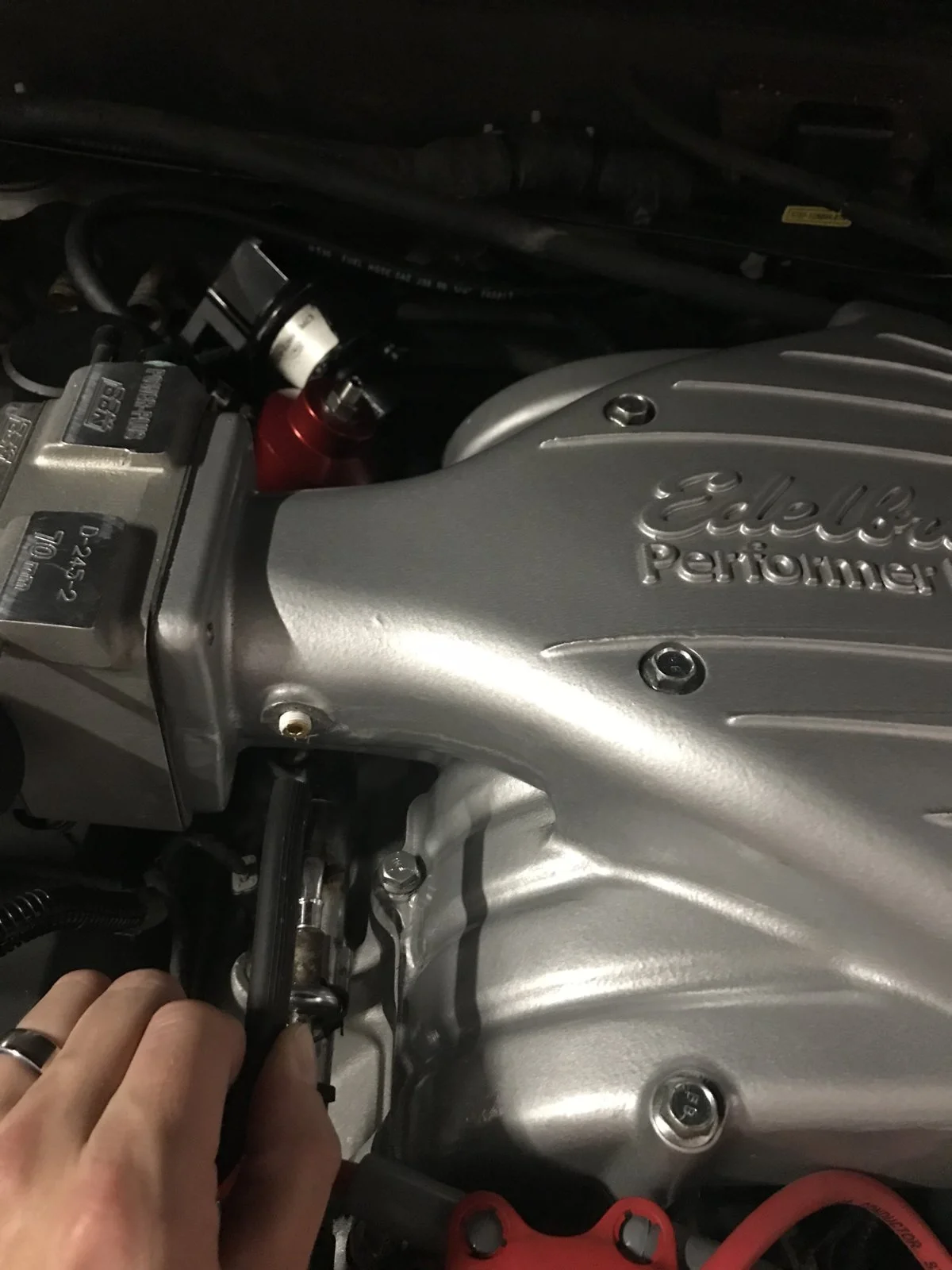

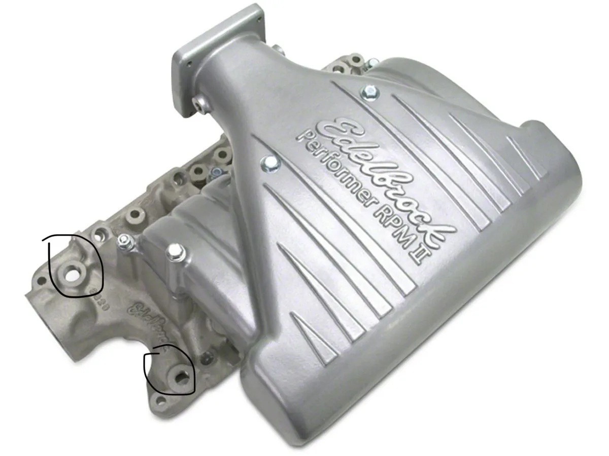

In the photo of the intake manifold I have marked up what’s plugged.
The left plugged hole would be where that coolant tube running to the heater core would plug in, then the sensor would be on that rail as well...
- I will get that sensor plugged into that hole.
The bottom right hole that is plugged.. looks like that should be the coolant tempature sender.
Not sure why I blocked that or where else the sender is plugged in.
I also don’t have the stock filler neck with that vaccume connection. So should I just plug that PCV port on the throttle body ? (Yes i have a pcv system, plugged in the back of the lower intake then up to the upper intake)
Can i plug the canister purge vaccume onto one of the connections on the EGR spacer or one of fhe plugged holes on the heck of the upper intake right after the EGR spacer?

Just cap that port on the TB then. You want to run that charcoal canister vac line to a dedicated vac port in case fuel gets drawn up the vac line.
Bottom right port is the temp sensor for the gauge in the cluster. Single wire hookup, and that's the only function of that sender. The coolant temp sensor in the tube is for the ECU, so you want to get it installed in that left port.

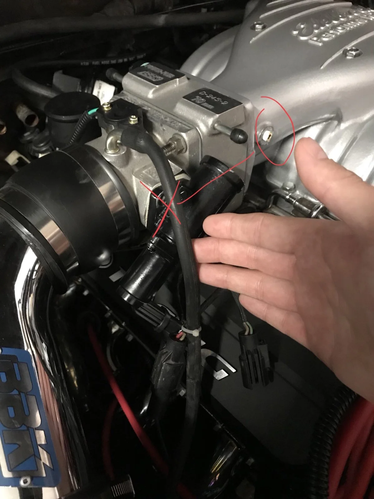

Maybe I will plug the purge line in the location in the attached photo
Thanks for your help

Of course the stock ECT sensor off the rail would not fit in the Edelbrock manifold... gonna need to figure out an adaptor that will still get that sensor end to dip in the coolant.
- edit: doesn’t fit there because that hole is for that metal coolant tube to screw in
Should I just hook that tube up and cycle the hose back to each other as it can’t plug into the heater core?
Does the EGR spacer need coolant? (Disconnected the EGR, and blocked it off)
Oh and i do have the bottom right port hooked up for the temp sensor already. Second guessed myself when I was circling holes. (Don’t we all when 2 are in front of us.. ha)
Should I just hook that tube up and cycle the hose back to each other as it can’t plug into the heater core?)

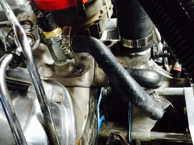

easiest thing would be to install the metal heater tube again and just loop the two lines in the back together since your not running a heater core or if you want to get ride of that mess you would have to find a reducer to fill that whole from the heater tube that you cant thread the sensor into. If not then verify what size the opening is on your intake for that heater tube. I believe this one has worked in the past. You just have to have the top tapped for the sensor to screw into. https://www.cjponyparts.com/5-8-hea...ign=shopping?gclid=CKyD1P3znr0CFTBgMgodTXcAEw
You want a bushing
problem with bushings is they place the ECT away from the main flow of coolant, so your readings may or may not be 10% accurate.
I believe the ECT is a 3/8" NPT, but unsure what size the port is in the manifold. You'd have to see how far into the coolant flow the ect actually sticks.
Or put the stock pipe back in and loop the coolant lines at the end
