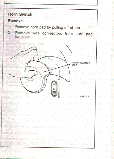

The horn button uses a thin foam rubber pad the separate the switch contacts. Over time, heat and age will cause the foam to deteriorate. Take it apart and replace the foam with some from packing you may have laying around.
From the shop manual:
attachment.php
I have a '90, thats the 87-89 style that was posted. My steering wheel has two small horn buttons on each side of the wheel.
