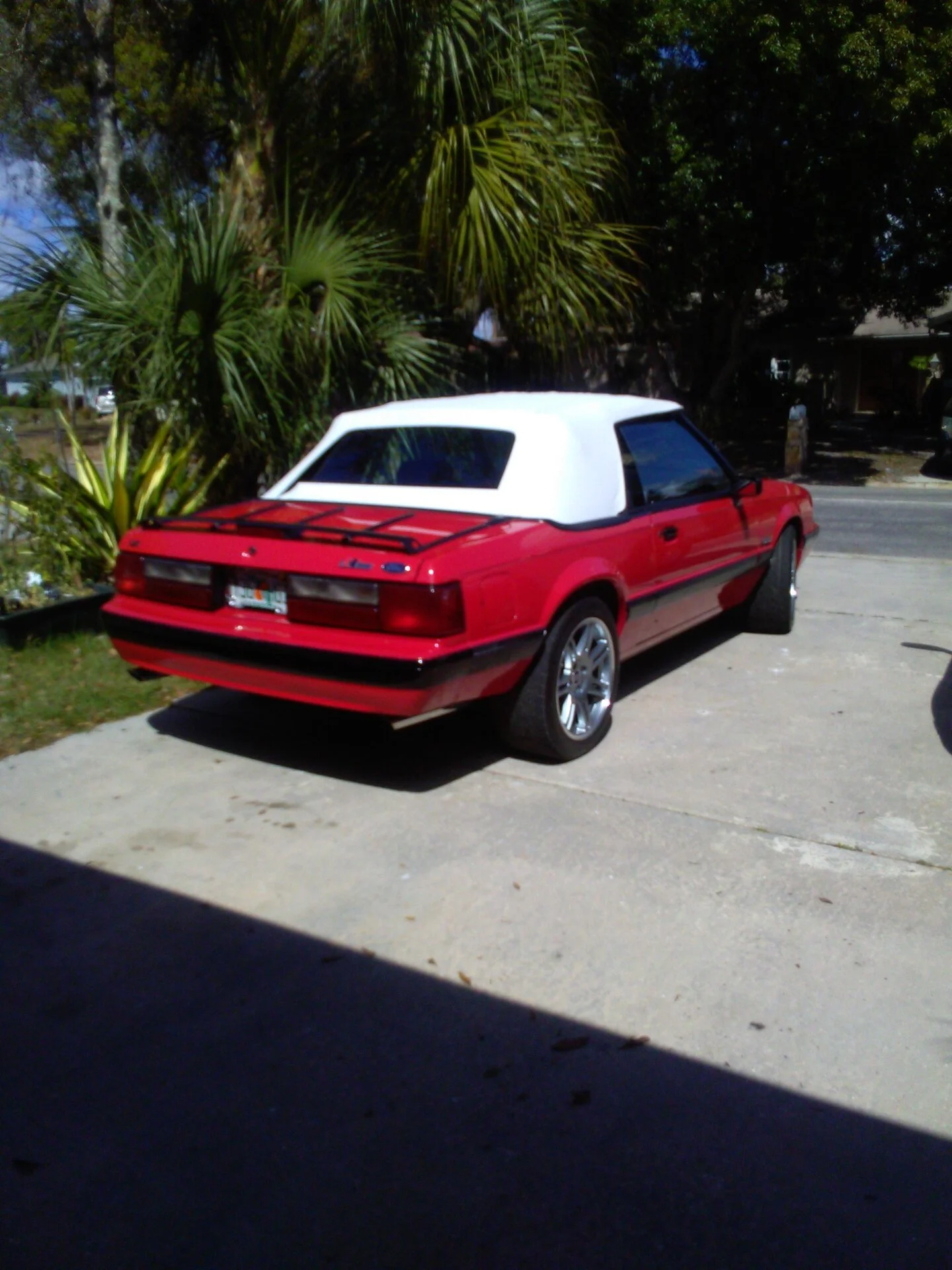

I would try to find a 91-93 top frame. They are designed a little better and as mentioned the top folds flatter. I have a 92 top on one of my 90 convertibles. Here is how it looks.
Now your just showing off..... I think my new top was 90 up

Awesome. Thanks, I will see if I can locate one I have looking online and thought I found one but it was sold. Everything else I have seen so far I someone selling the entire car and I am not spending the $2000 or higher on another one just to swap the top then have the dilemma of trying to sell that frame with no top or beginning my cycle again of no roof. I wish I knew somewhere that could re-build the frame itself without costing me a lot. (PLUS, it much easier and faster to swap an already upholstered top on) And she looks clean brother, definitely a good match.
