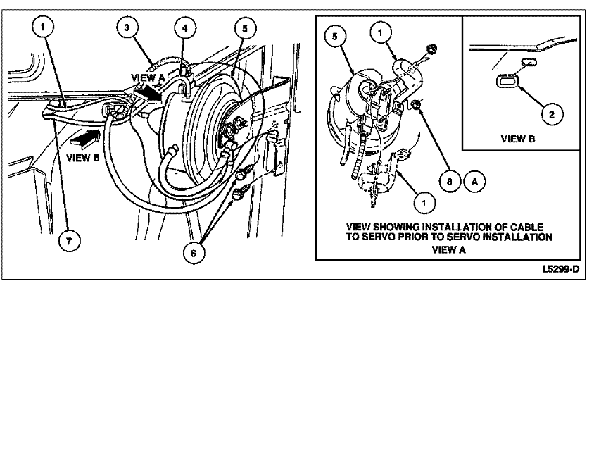

Speed control servo installation – located in LH door pillar under fender

Speed control amplifier – located on driver’s side under dash between the steering column and the inner body panel
