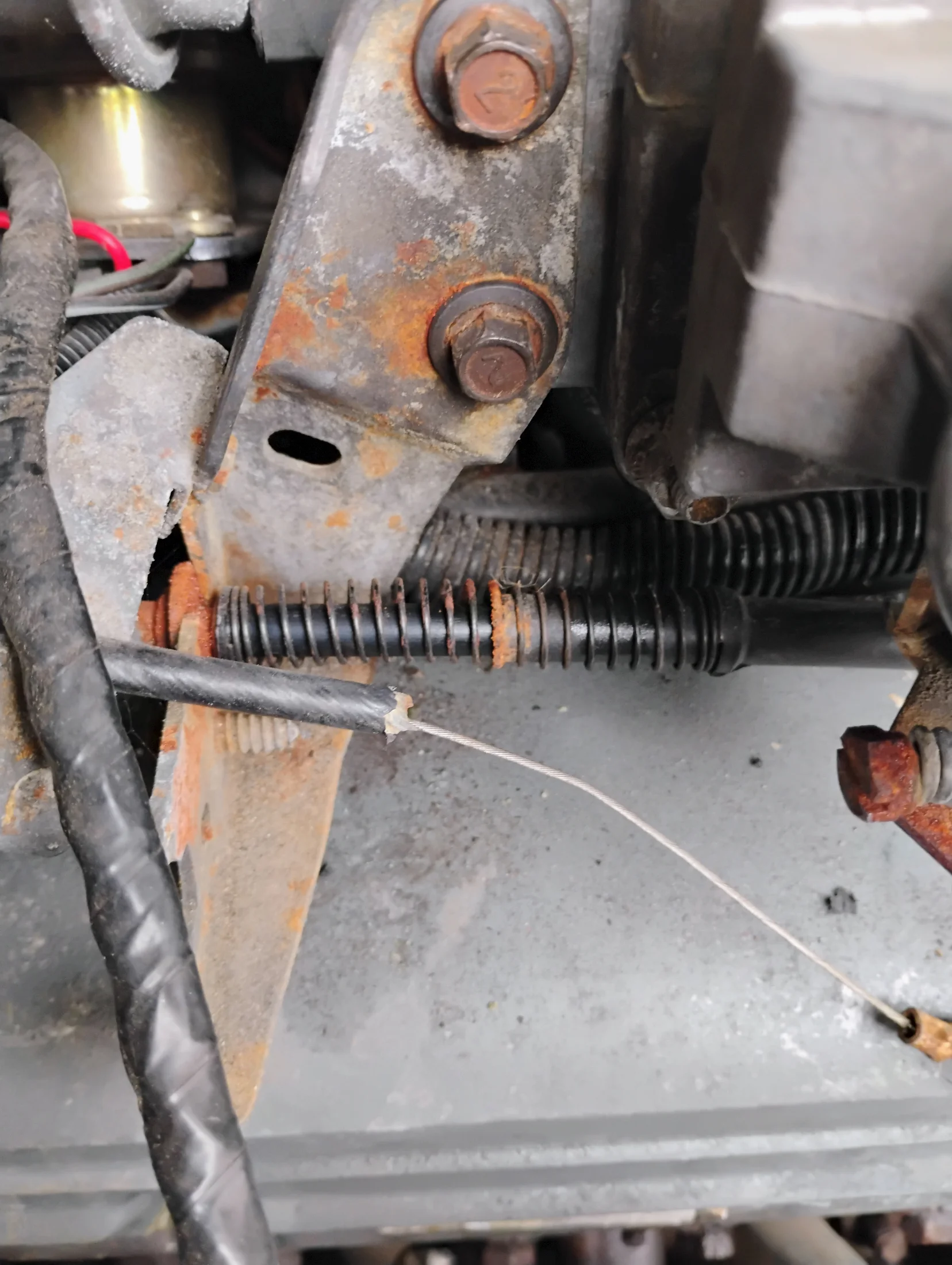

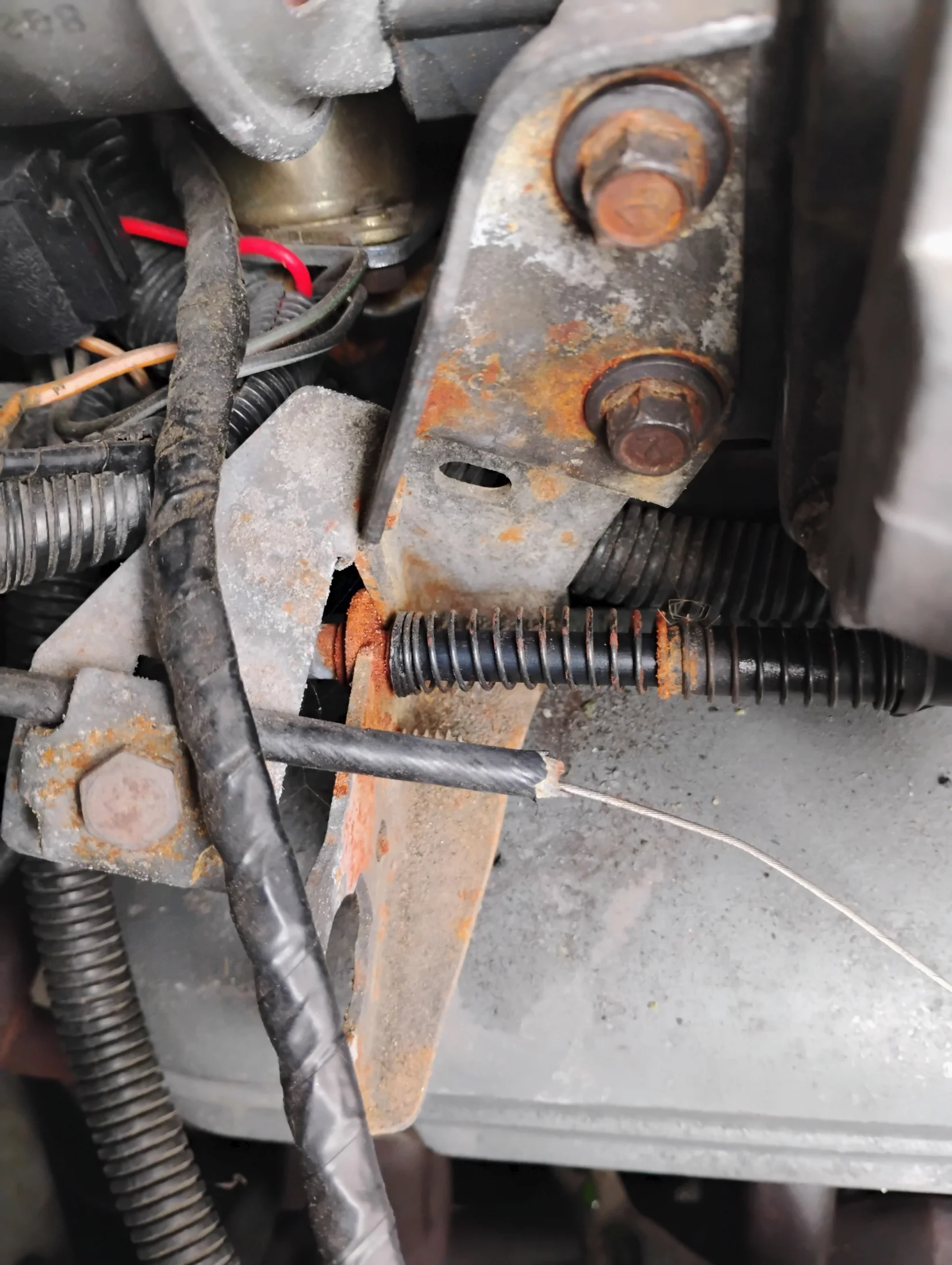

Here are two photos of the cable. It almost appears to be two springs; plus the insert seems to be the reason for the sticking. There's lots of motion when I work the throttle by hand. Plus its worse when connected to the throttle bracket.

I’m pretty sure the throttle body should snap back closed without the cable attached. If it’s not doing that then you need to replace it.
Also, that does not appear to be an OEM throttle cable so I would suspect it to be contributing to the problem.

Its not an OEM cable. Can't find one. When I had the throttle body off the car it closes easily on its own. There is actually a decent amount of tension in the throttle return spring. It appears the cable is binding but I'll check again and if needed, I'll put the old one back on. The connection to the throttle body was weak and that's why I replaced it. But maybe I can get it to stay on better. Definitely prefer factory items.

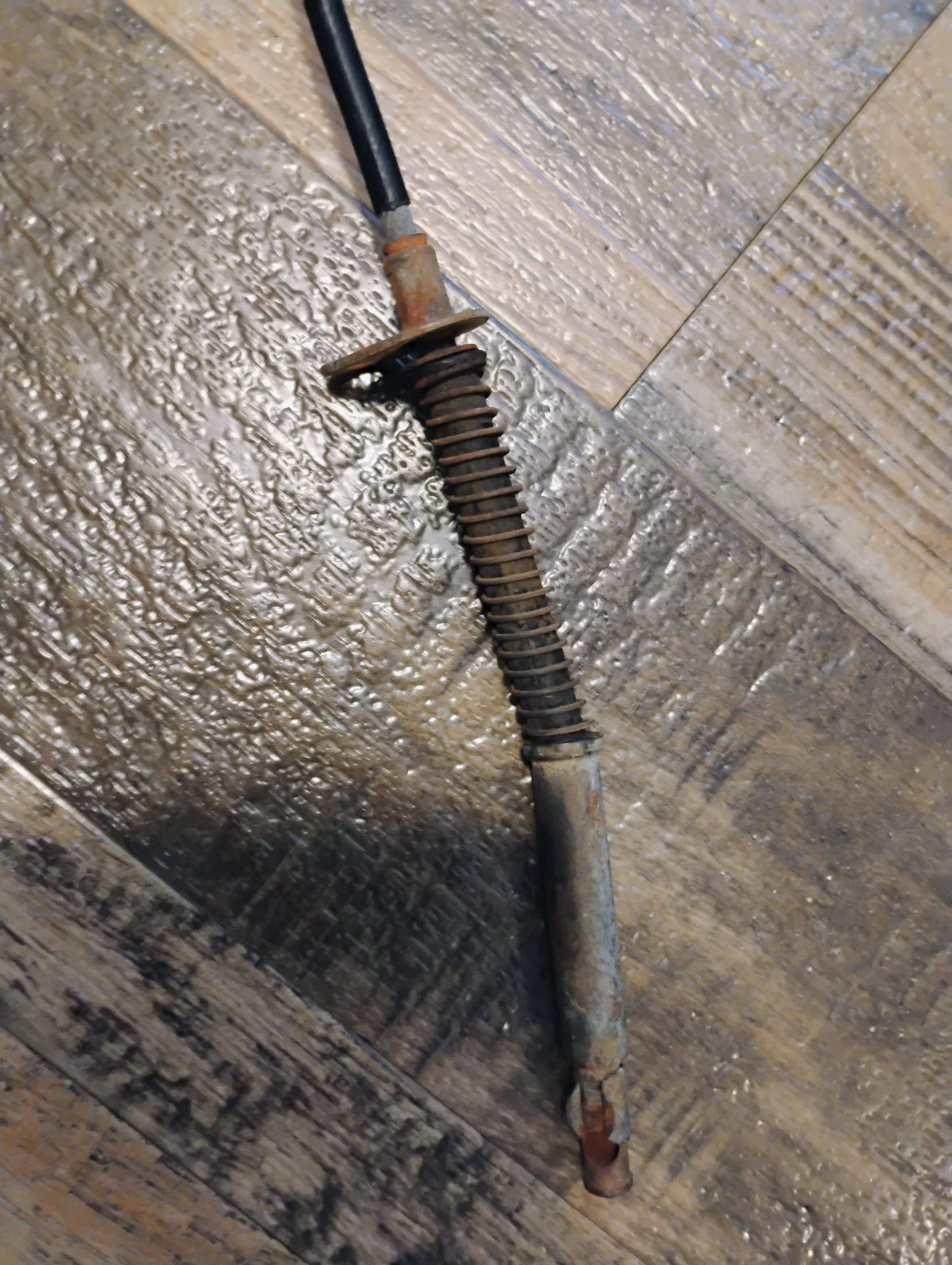

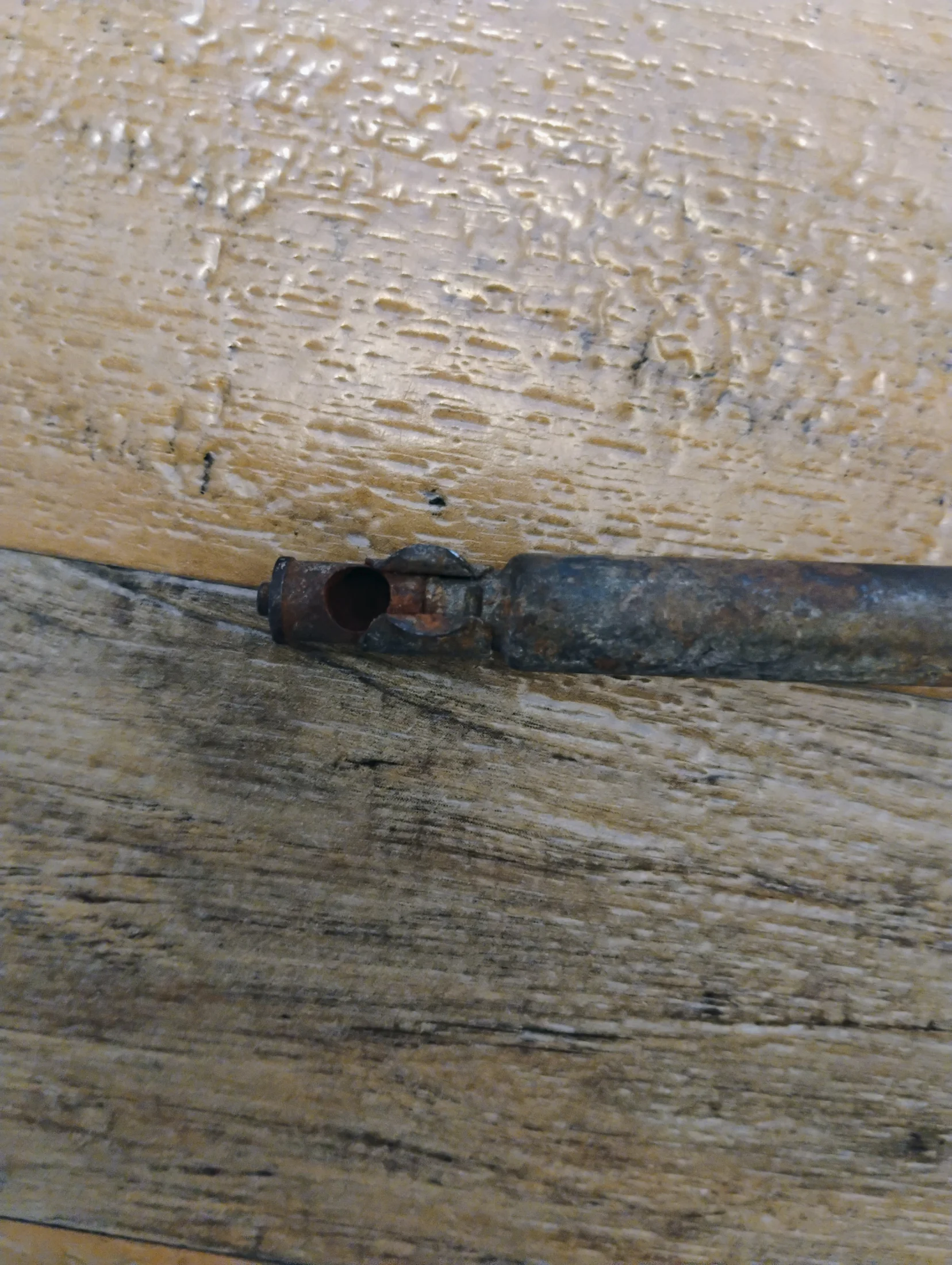

I did manage to see a few used cables but wonder what condition they might be in. I dug out my old one and there are two photos of it below. The only problem is the attachment point- a little rusty and somewhat loose. Definitely think I need to change the cable. Maybe it can be repaired. Seems to work well.

Replaced the throttle cable with the original. Works much better but the attachment point under the throttle is loose. Likely will fall off on me while driving. Is there a way to make it tighter without really altering the set-up? I'm thinking fine wire or maybe I can squeeze the 'grip' part of the connector. Don't want to damage it.

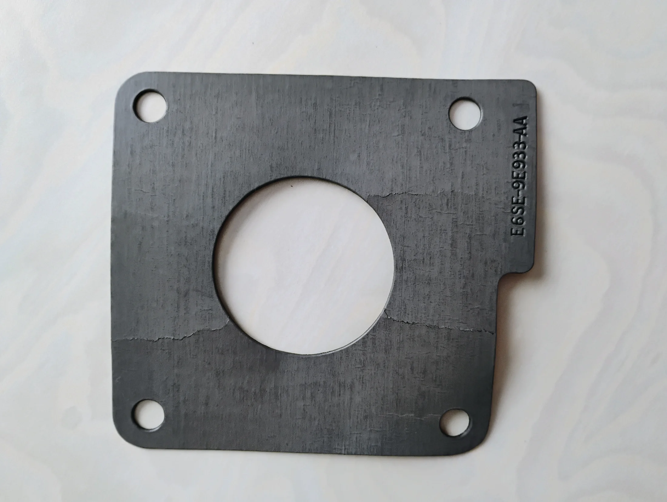

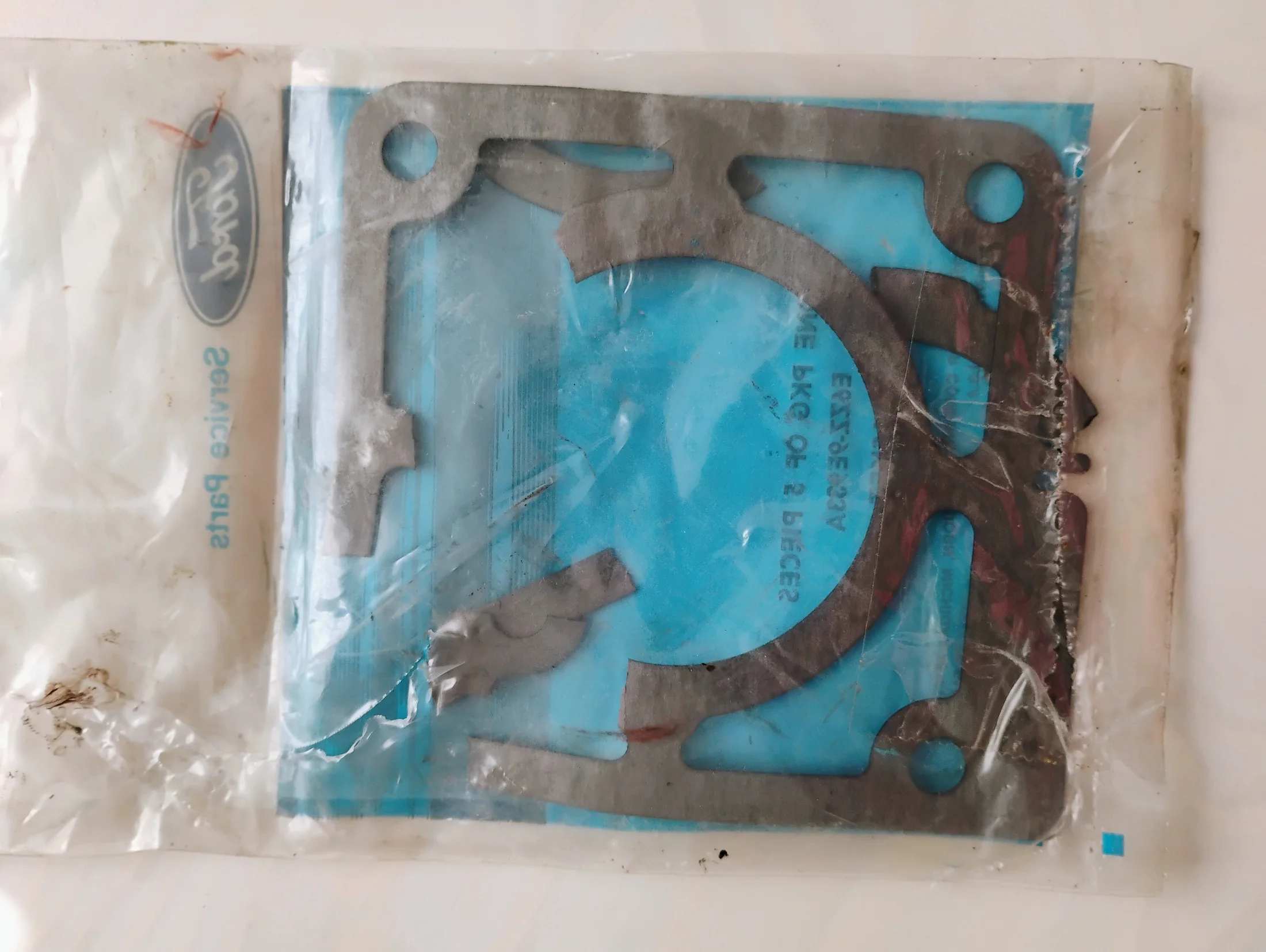

All good ideas, thanks much. Ran into another problem. Seems the gasket is leaking slightly. It might be the wrong one. I ordered a few factory NOS gaskets but they don't seem right. Does anyone know the correct Ford part number for the throttle body to EGR spacer gasket? The shop manual lists part # 9E933 but I've seen a few prefixes and now have two that I can't use- one is slightly bent and the other is in numerous pieces. One prefix is E6SE, the other is E6ZZ. Knowing Z is the code for the Mustang, I'd guess that's the one I need but right now I can't find one. Not sure if the T-bird had the HO 302 or not, I would think both shared the same throttle body and the same gasket for 1986 but not sure. Not a T-bird guy. I'll keep looking. Thanks all.

You should be able to pick up FelPro gaskets at any parts store that will do the job nicely unless you are just wanting OEM gaskets. 83-88 T-Birds did not get the HO motors.
I just went with the Fel-pro gasket. Worked fine. I found a NOS throttle cable. It arrived the other week and since today's weather here was decent and I am off work, I had at it. 90 minutes and the new cable is on and looks great. Much better quality. My concern is the throttle body itself. I removed it and cleaned it again and the pitting and wear on the mounting surface really stands out. I used my Dremel tool and a fine wire brush to clean up the surface and it did look better. Maybe machining the thing someday will help? So with the new gasket I applied a small amount of thermostat housing sealant. Since that is what it is sealing against I thought it should do alright. I'd prefer to install the gasket dry but doen't want any leaks. All back together, I just haven't started it up yet. Probably should but time for a short break. Thanks all.
