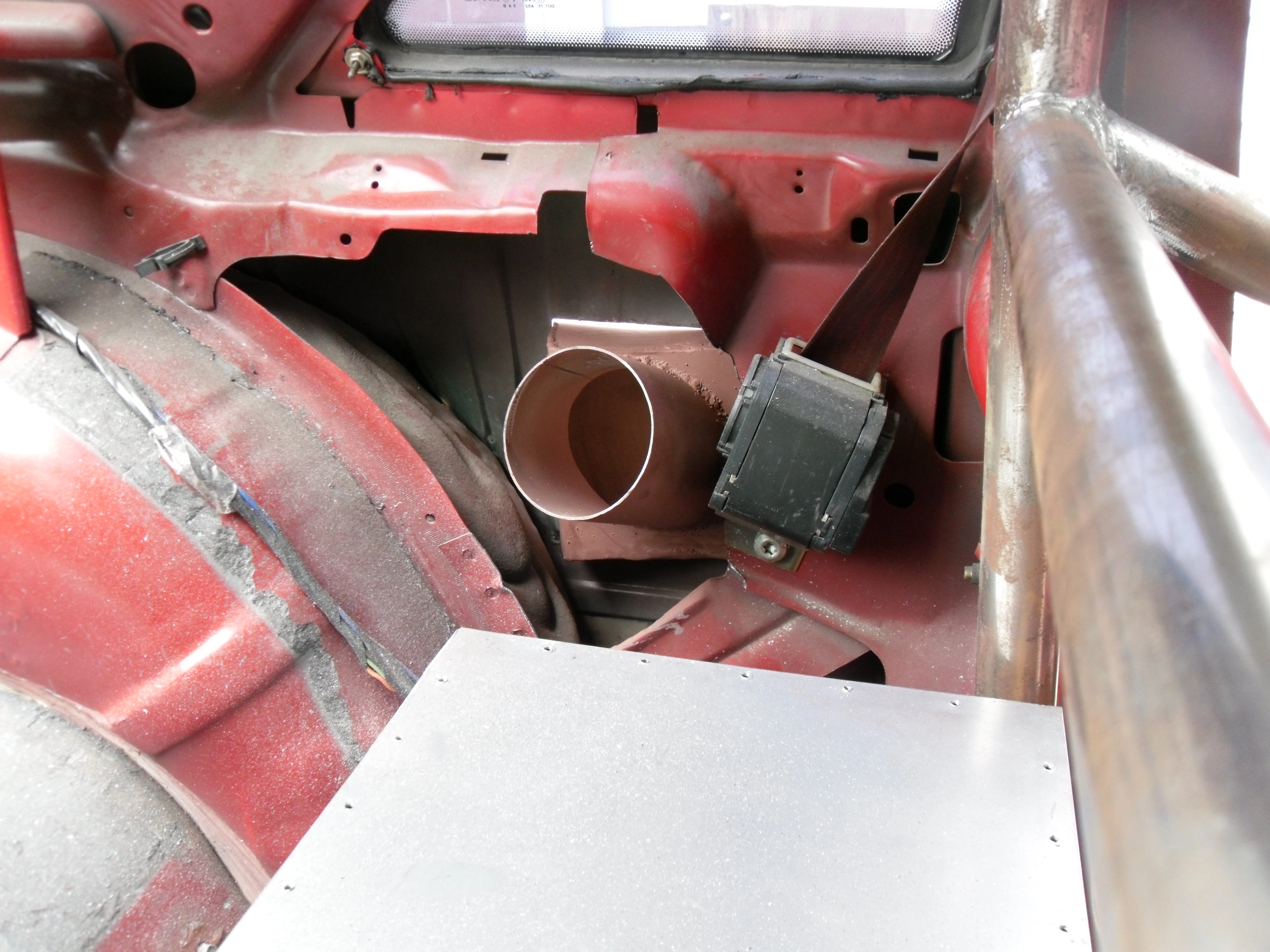

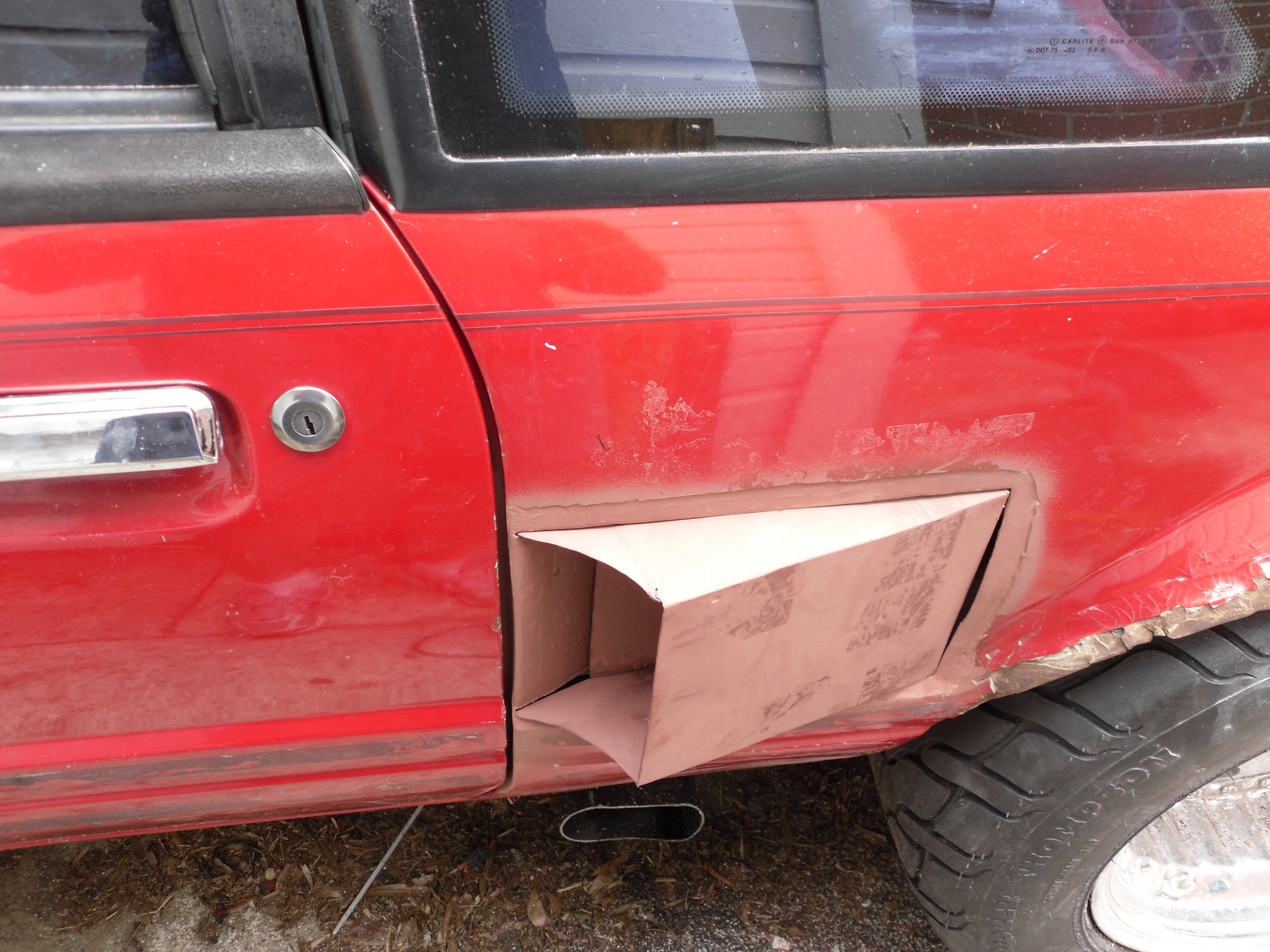

The Point Of No Return

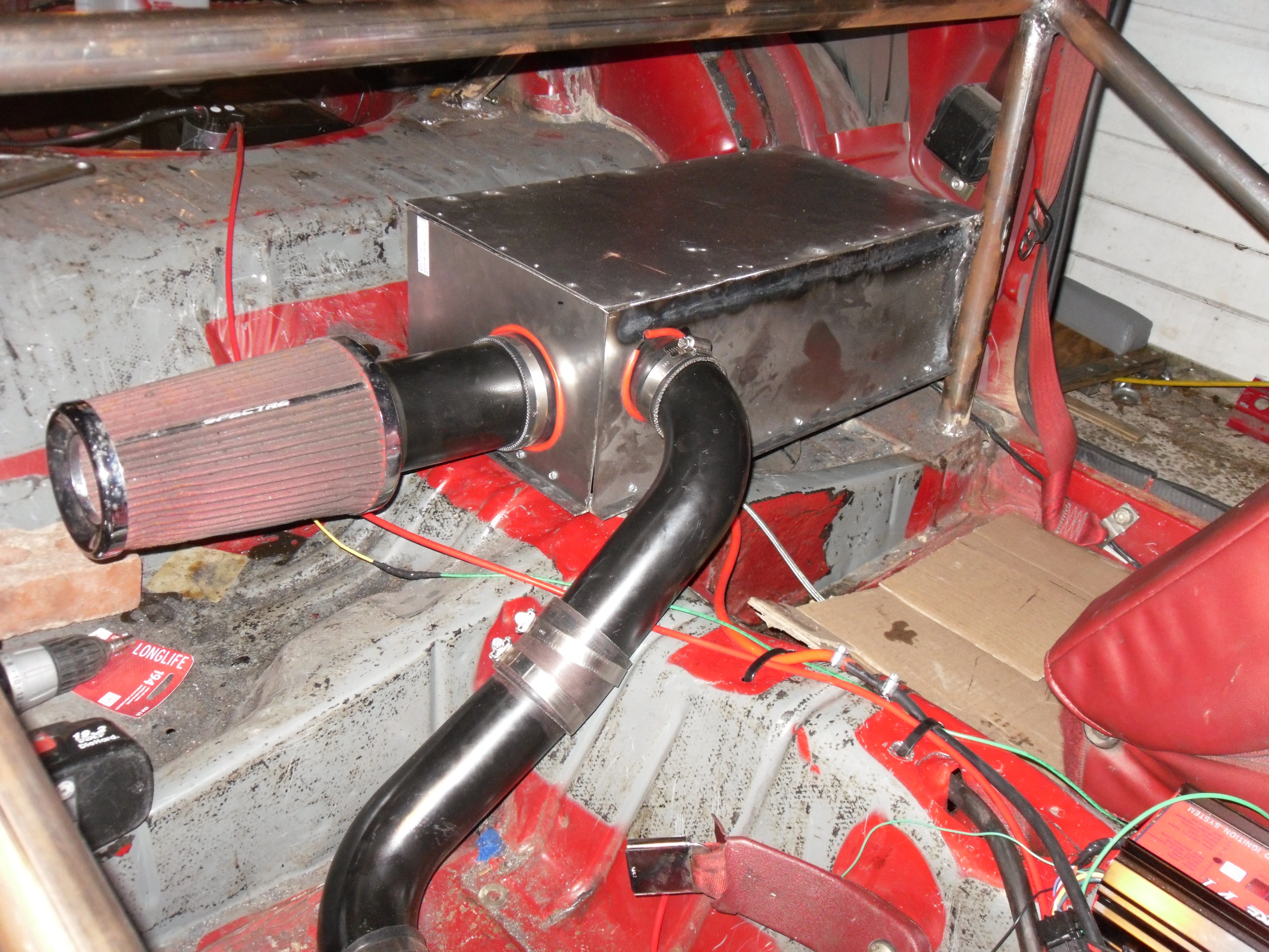

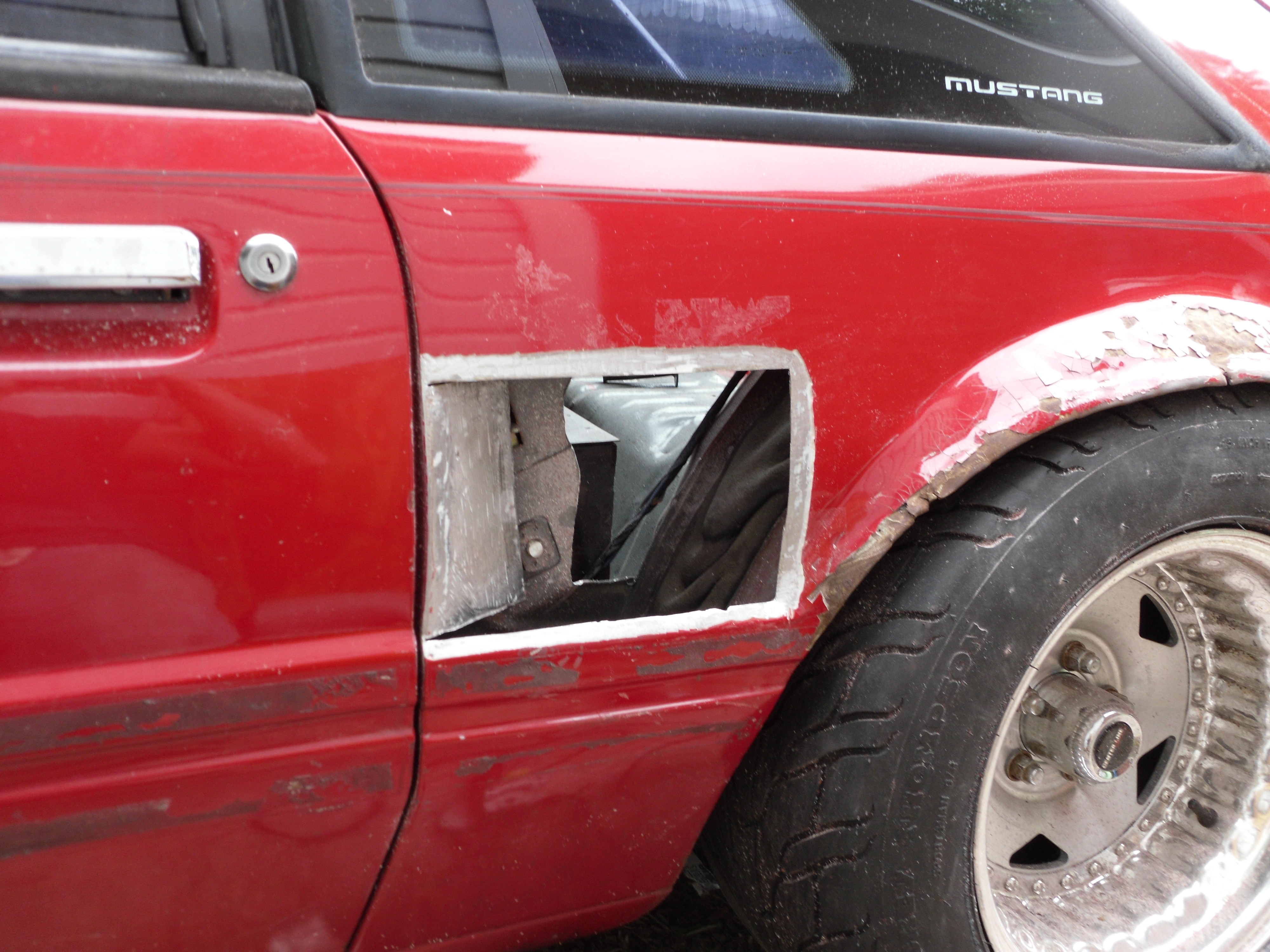

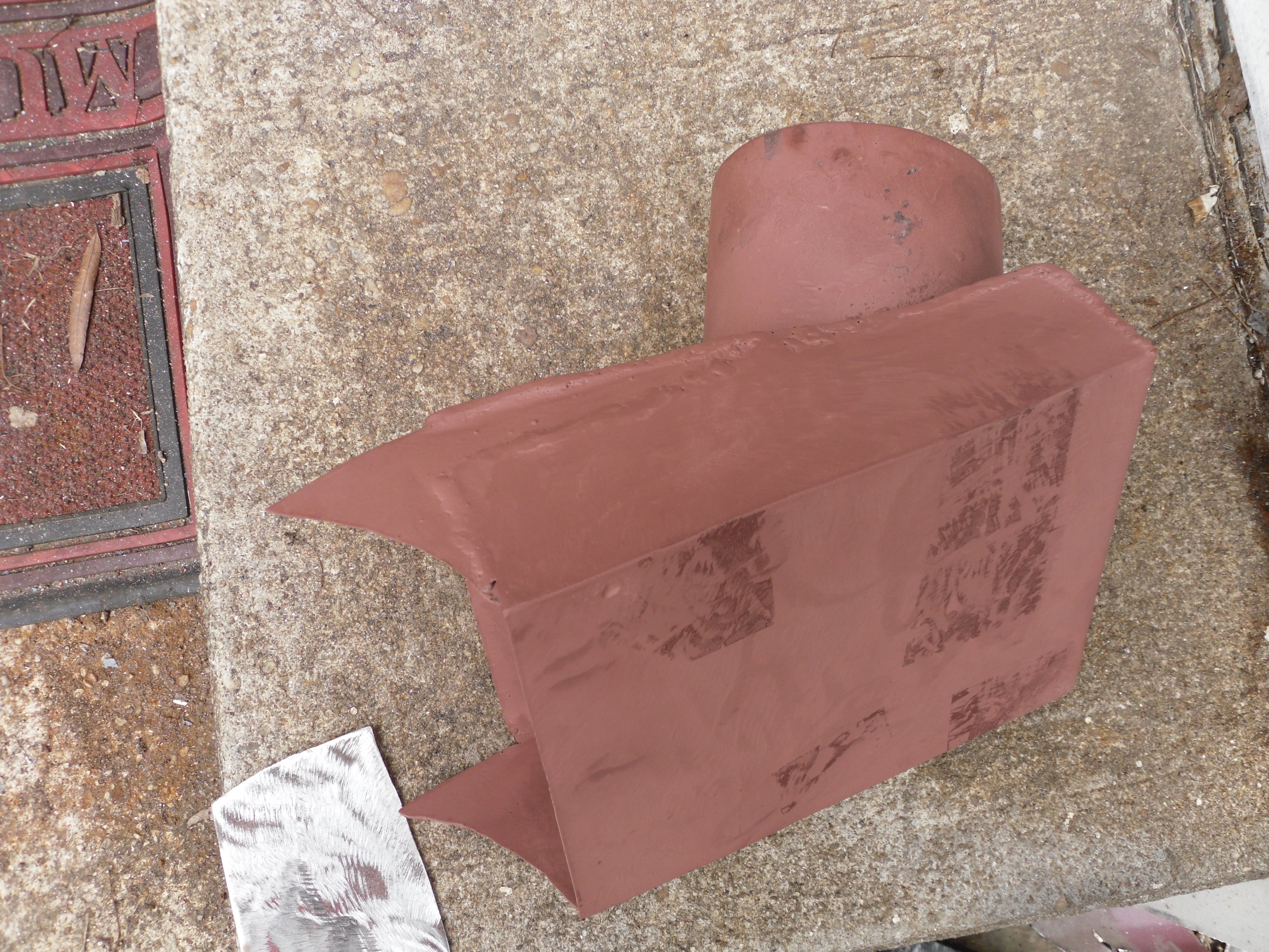

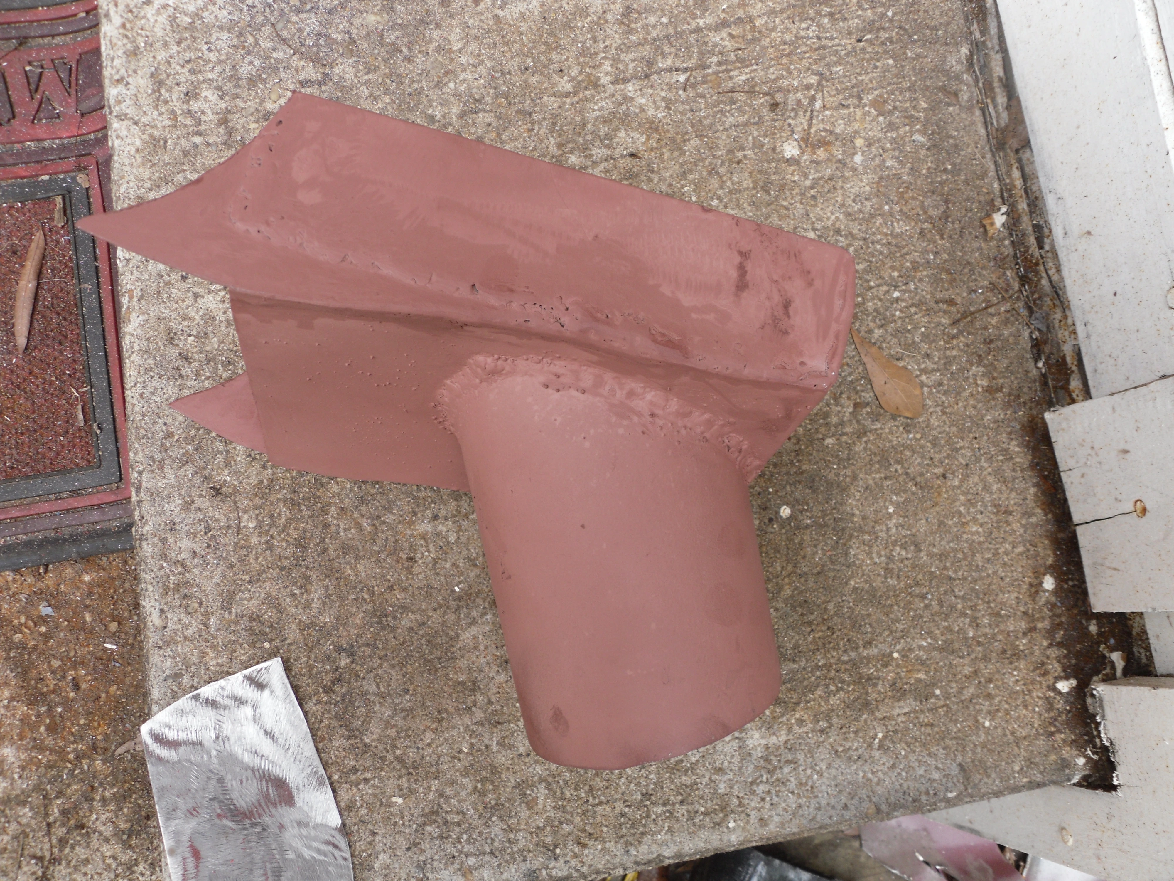

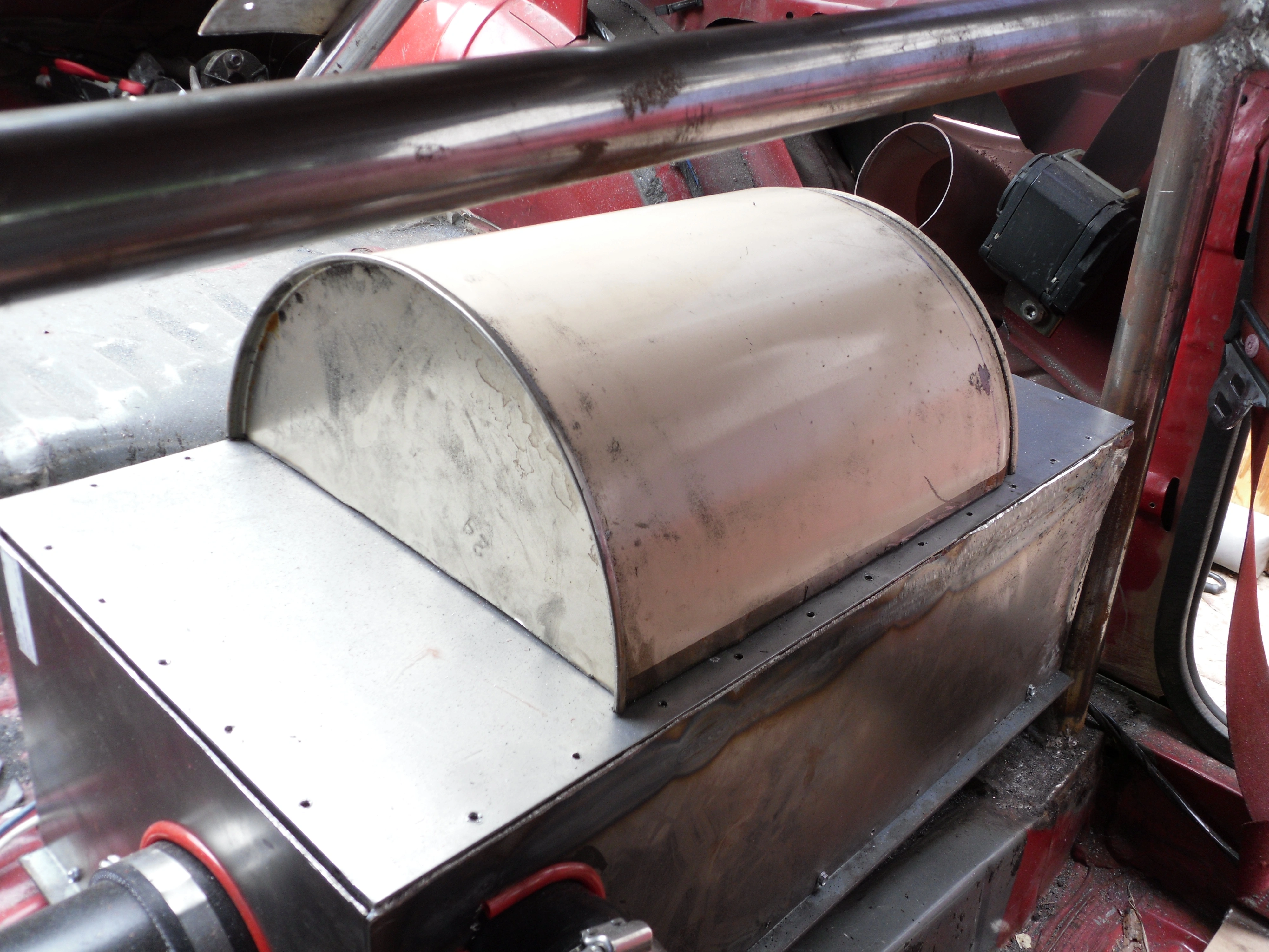

I got a little work done. The point of no return has definitely been crossed. I have the Scatter shield / heat extractor box built. I used 5/8” angle iron to build a frame to attach the plates to. The top of the box is removable to access the turbo or the whole box can be removed if needed leaving only the lower frame attached to the car. I still need to make templates & cut sheet metal to enclose the area under the box. I’ve got the driver’s side scoop fabbed up & the 4” pipe to connect the ducting is welded to the scoop. The hole has been cut for the side scoop & I found a layer of bondo already on the quarter panel that’s about 1/8” thick. With the way the wheel well looks, that shouldn’t have been a huge surprise. I also mocked up the fan shroud for the top plate of the box. I don’t have the fan yet but, I decided to go with an 8” trans cooler fan over the 4” bilge blower. The bilge blower pushes 240CFM where the 8” fan pushes 800 CFM. Because I’m trying to push heat down, I thought more CFM would be better. Nothing in the pics has been hard mounted to the car yet. It’s going to be a while before I can do much more to it so I just sprayed some primer on to try to keep the rust down.
The scatter shield / heat extractor
The hole cut for the side scoop
A couple pics of the side scoop with the 4" pipe welded on
The side scoop sitting inplace
The inside view of the scoop & duct
The mock up of where the fan shroud will go
Still no sound clip yet but, I might have to work on that this weekend. I’m all out of wire for the MIG and I haven’t ordered the fan yet. I still need to talk my financial advisor (AKA the wife) into the funds to buy supplies.
