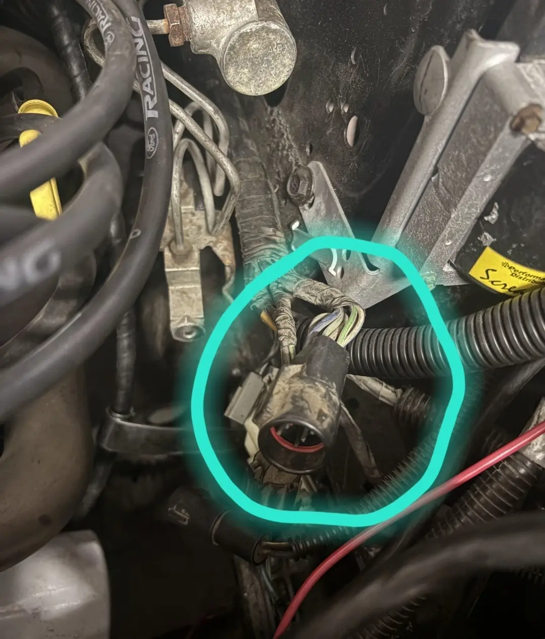

Hey guys, just put a new to me of off road h pipe on(last one didn't fit correctly to the cat back) and put the cat back on. Also I recently learned the 02 harness plugs into a 8 pin connector I believe on the passenger side under the maf, so while the car was in the air I switched that from the driver side 8 pin connector near the strut tower coil area I had it in, to the other by the maf. Now previously with it running out of the h pipe and the 02 sensor harness on the wrong connector the car seemed to run fine. I started it up now with the cat back on and the 02 harness plugged in where it should be it surges like crazy and then eventually dies and won't start again without help from the throttle. Does the connector I moved the 02 harness from go to anything important that is now not plugged in? Here's a pic of it
Disregard the 8-pin connector I found the other end it was under the battery tray hooked it up I could see it's something for the dash setup all good there. Just don't understand this problem didn't start happening until I reconnected the o2's to the other side and put the H pipe in. Could I have put them in backwards? Also to know when it does start and surge till it dies it has a strong smell of fuel

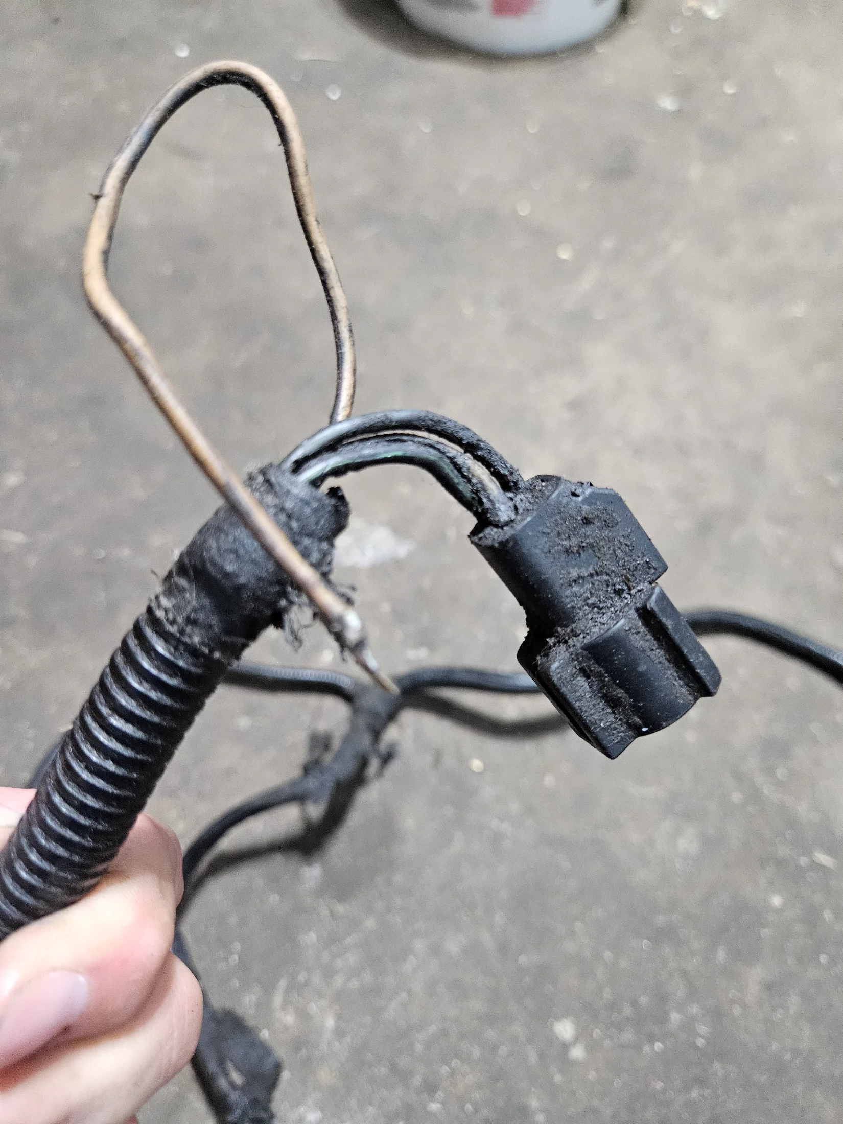

Also one thing I did leave out is when I re-ran the oxygen sensor harness I noticed that it obviously had two plugs for each sensor but one of the plugs had a thinner wire sticking out of it that was frayed at the end? Would that be my problem what does that go to?

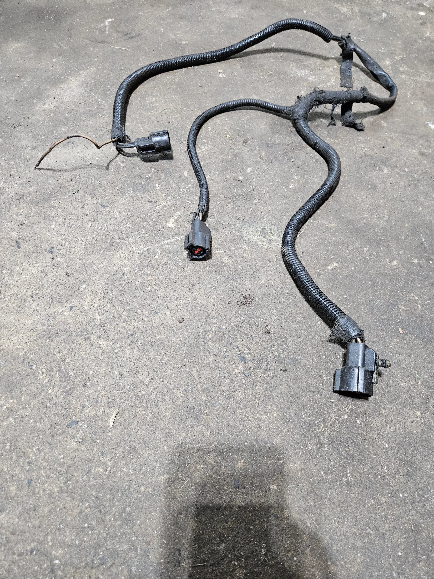

That's the single wire there. Any research is telling showing me it's supposed to have a plug on the end and go into the oil pan? Not sure though, if that's the case then would that cause any issues or is this just a coincidence that the wire is frayed and it's making me think that it's causing an issue?

That wire is for your low oil level in your pan, once it goes down a quart that light should come on,i dont understand how the o2 harness can be plugged into some random plug and be working fine before but now that its were is supposed to be its not?
You are correct about the placement of the harness, its plugged in under the mass air and runs around the front of the pan to both banks where the o2s plug in,have you owned the car long? sounds like someone monkeyeed with it and didn't do things correctly, if you are going to keep the car you might want to invest on a INNOVA code reader (part number 3145), they are cheap and beats that counting flashes and beeps scenario.

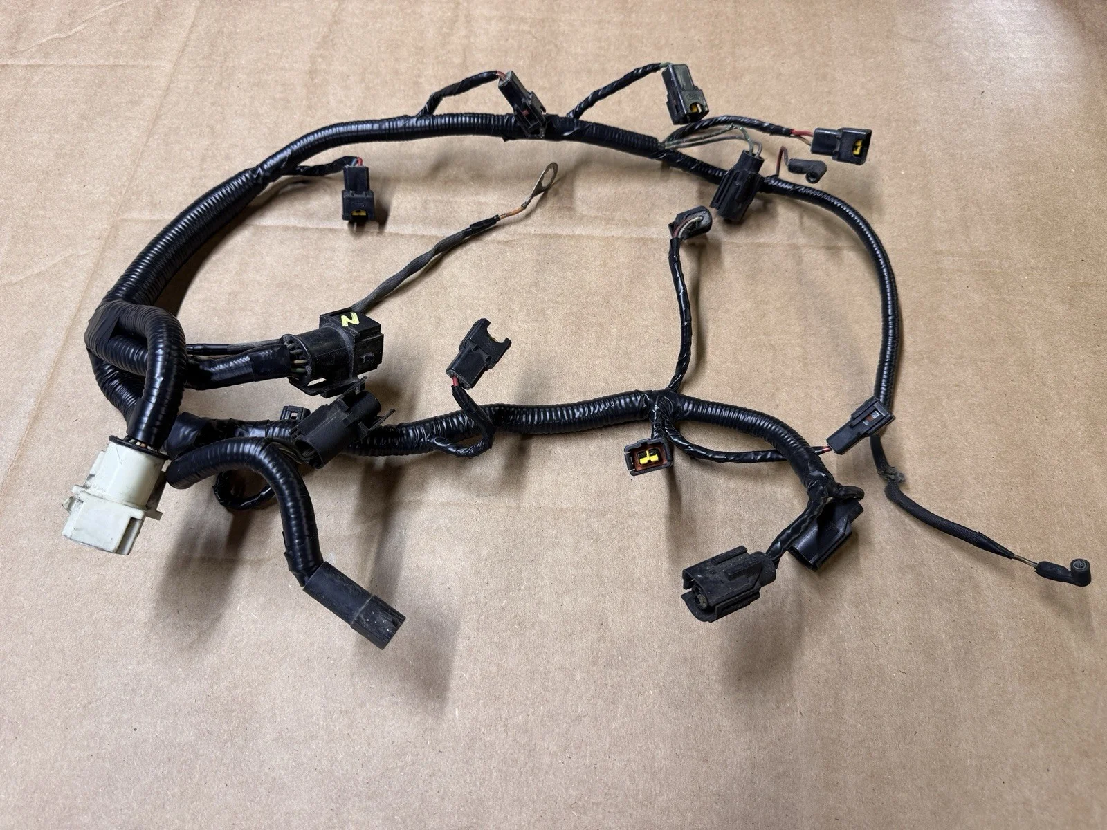

Make sure the ECU ground behind the battery is in good shape as well. There is also a ground wire that is part of the injector harness that is typically grounded on the back of the passenger head or bell housing or on the intake. Make sure that one has a good ground as well. Believe this wire is orange?
Yes, like Aerocoupe said,your injector harness should have a orange wire coming out of it around the drivers side towards the back, this wire needs to be grounded, its usually grounded to the last intake bolt or behind around the bellhousing like previously mentioned, in the picture im sending you,see that lone wire around the middle that has the eyelet ? thats the wire you are looking for, needs to be grounded, its not easy to see, look at it from the passenger side, just lean in and you might see it bolted somewhere.
