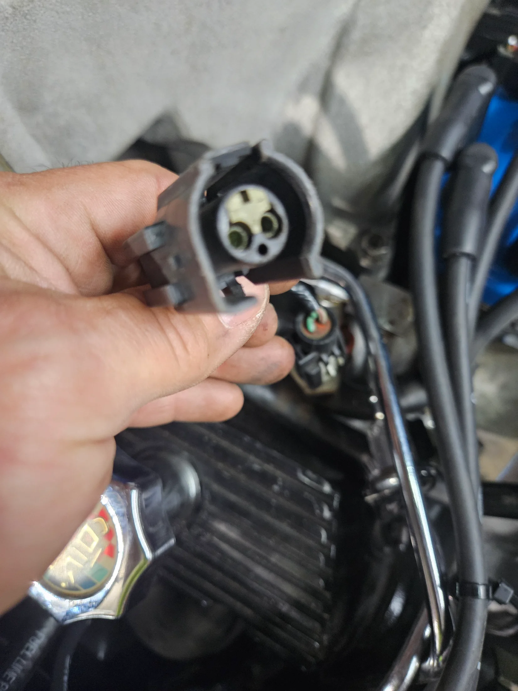

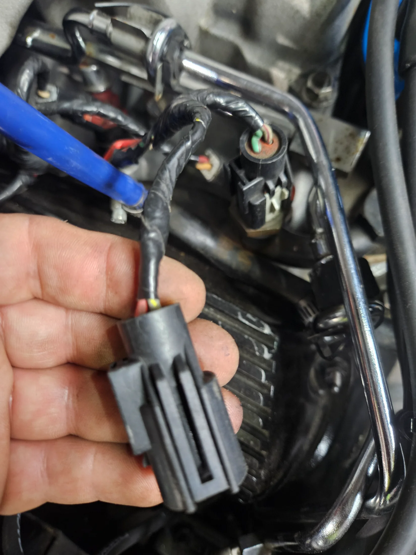

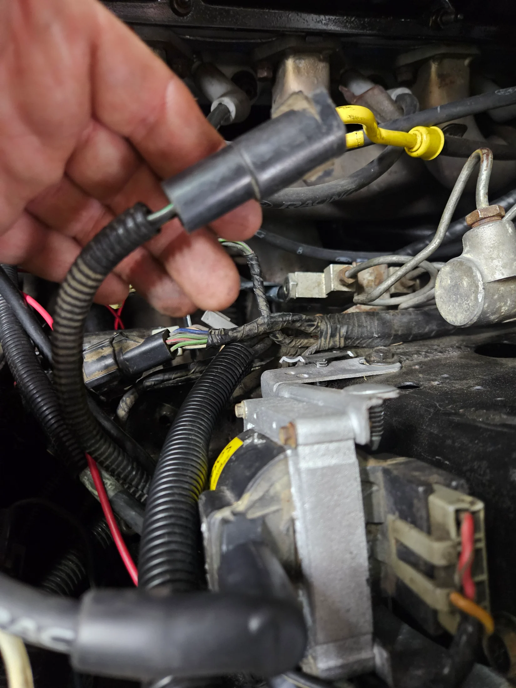

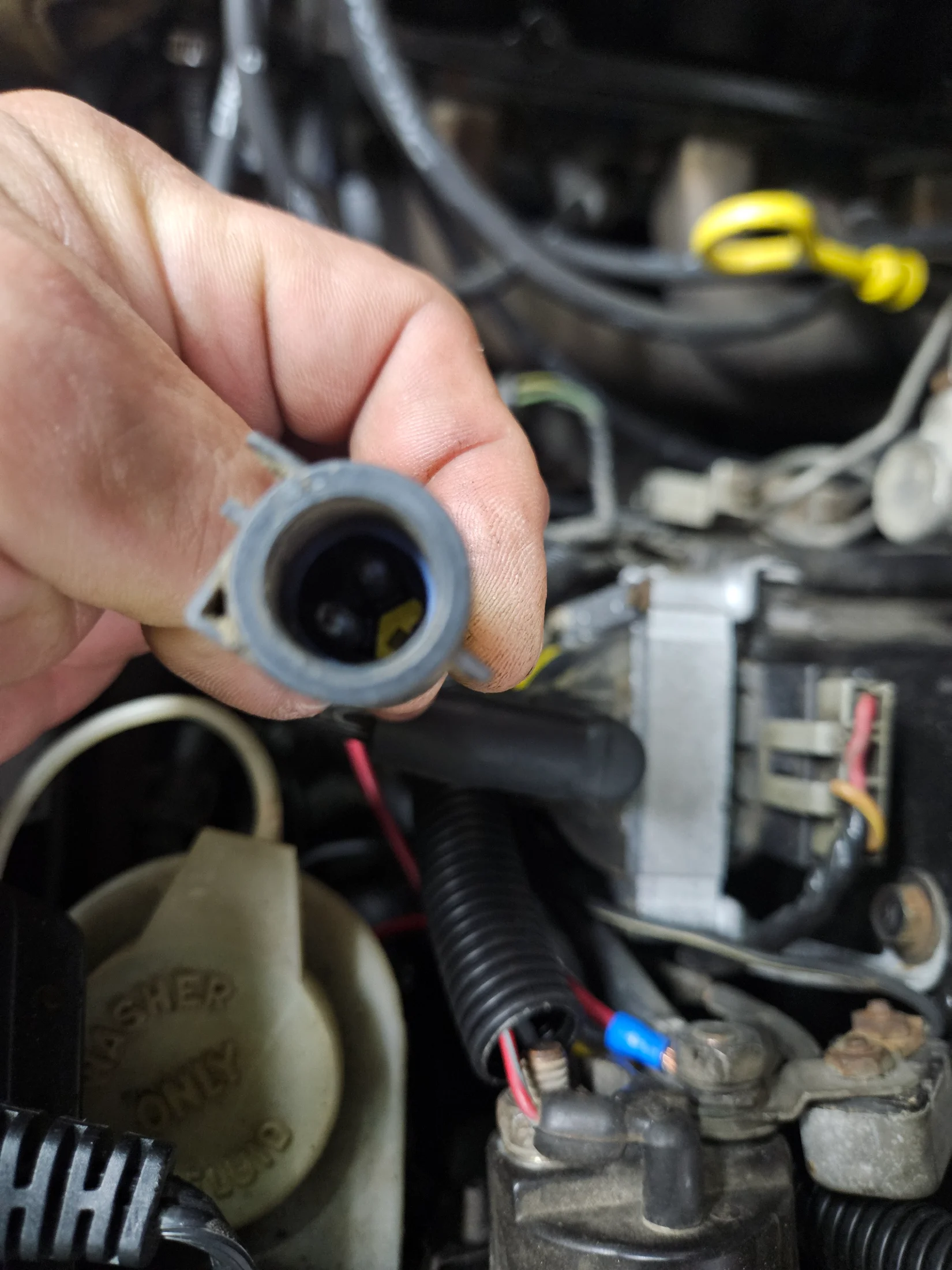

Can anyone tell me what these connectors go to? The first pics are of a plug with a 2 wires green with black and black with yellow, it's near the coil area. The second plus is also 2 wires grey with yellow and red and it's near the passenger side fuel rail attached to another 2 wire plug. Just wondering if one of these not plugged in might be a culprit or not.

Those are the plugs for your charcoal canister (emisions), i believe they should be plugged together , unless the system is not there anymore, on my 91 last year i put all that stuff back on,it had been off for decades and i just got tired of the smell of gas in my garage and while driving.
Reading your comment a bit more carefully I'm certain picture number 3 is for the charcoal canister because that connector and the one for the temperature sensor for the PCM are wired very close to each other and it plugs in to a plug identical to the other pictures you show.
Yeah, thats what those connectors are for,no worries there, thats not your problem, that was a great idea Aero suggested, clean that mass air meter, its a simple procedure, i can take mine off without taking the mass air system of the car,just unplug it,take your screws off, i believe they are torx and VERY GENTLY pull the unit up and out of the housing and spray a Qtip and gently clean the sensors and put it back together, those sensor can get pretty dirty.
