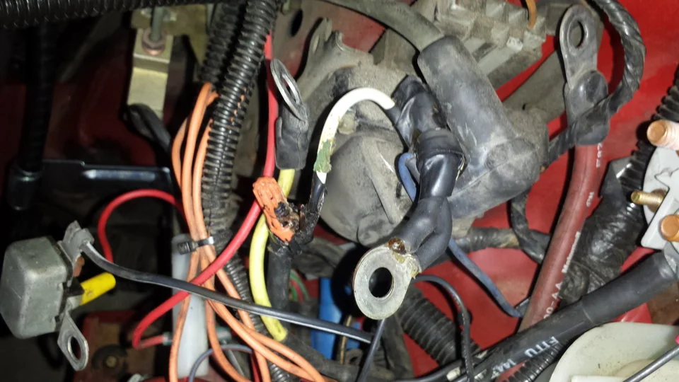

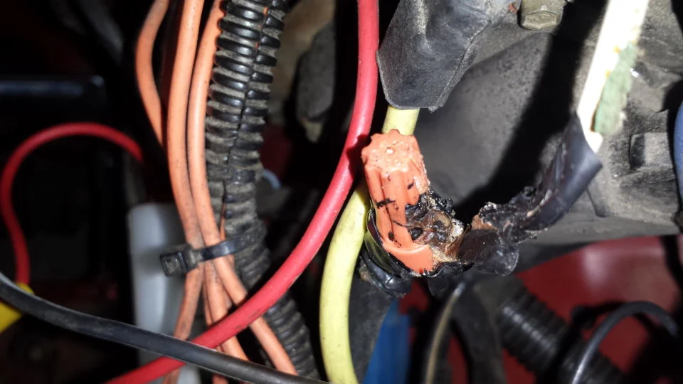

This is the b/o wire that runs to the solenoid. Doesn't look good does it?

So.. I fixed it. I am lead to believe that when whoever decided to put plastic butts on top of the wires rather than soldering them, caused the problem. I will have to go through and take some readings I guess to make sure there are no other issues. Thank you all for your help, I greatly appreciate it. 2 days of work for a novice, but I figured it out!

koala33 said:
Also wanted to post a picture of the power cable with b/o wires.. As I said before,
"Is it safe to assume that at this point that because the w/y wire on the voltage regulator connector has 12v, then the rectifier connector with the 2 b/o wires is doing its job (i.e. the connector is not faulty)?"
Can I rule out a faulty connector? The insulation that you see is gummy. I am able to pretty easily poke a pin inside of it.
I did buy the fusible links at AZ just in case. Looks like I am going to have to unwrap the entire b/o wires to check for faults? These run all the way to the solenoid near the drivers side/firewall correct? Is that where the fusible links are?
Thanks,
Shawn
The fuse link is the green wire that connects the black/orange wires to the starter solenoid.

Jrichker, I most certainly couldn't have done this without you, so thank you a ton. Also the other guys in the beginning of the thread (too tired to look), thanks for all your help as well. Here are some things I will pass along. Make sure to follow the steps posted, one at a time from the beginning. This really made things easier, and gets you acquainted with what you are going up against.
What I don't quite understand is why someone put plastic connectors attaching the 18 awg fusible link + b/o wire to the 14 awg fusible link. The problem was that the plastic melted and created 3K ohms worth of resistance. Once I cleaned everything up, I soldered all three together and covered with heat shrink. My resistance dropped to .1 ohms I believe.I will say, I only replaced the 14 awg fusible ink. The existing 18 awg fusible link connected to the w/y wire from the voltage regulator tested good for continuity, but did have some stretch to it. I was going to replace this also, but no one in town had 18 awg fusible link.
