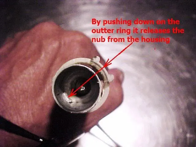

5.) The speedo cable is secured in the speedo head by a white plastic clip. Depress the clip or squeeze it and pull the cable out of the speedo head. This can be tricky, but it will come out if you have the white clip depressed enough.
Speedo head cable clip
