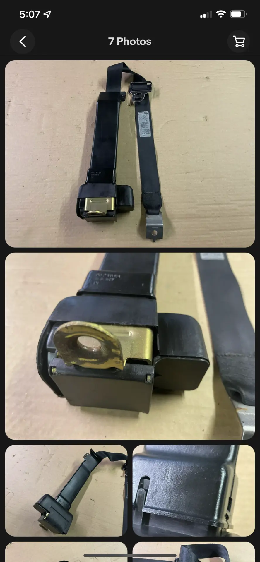

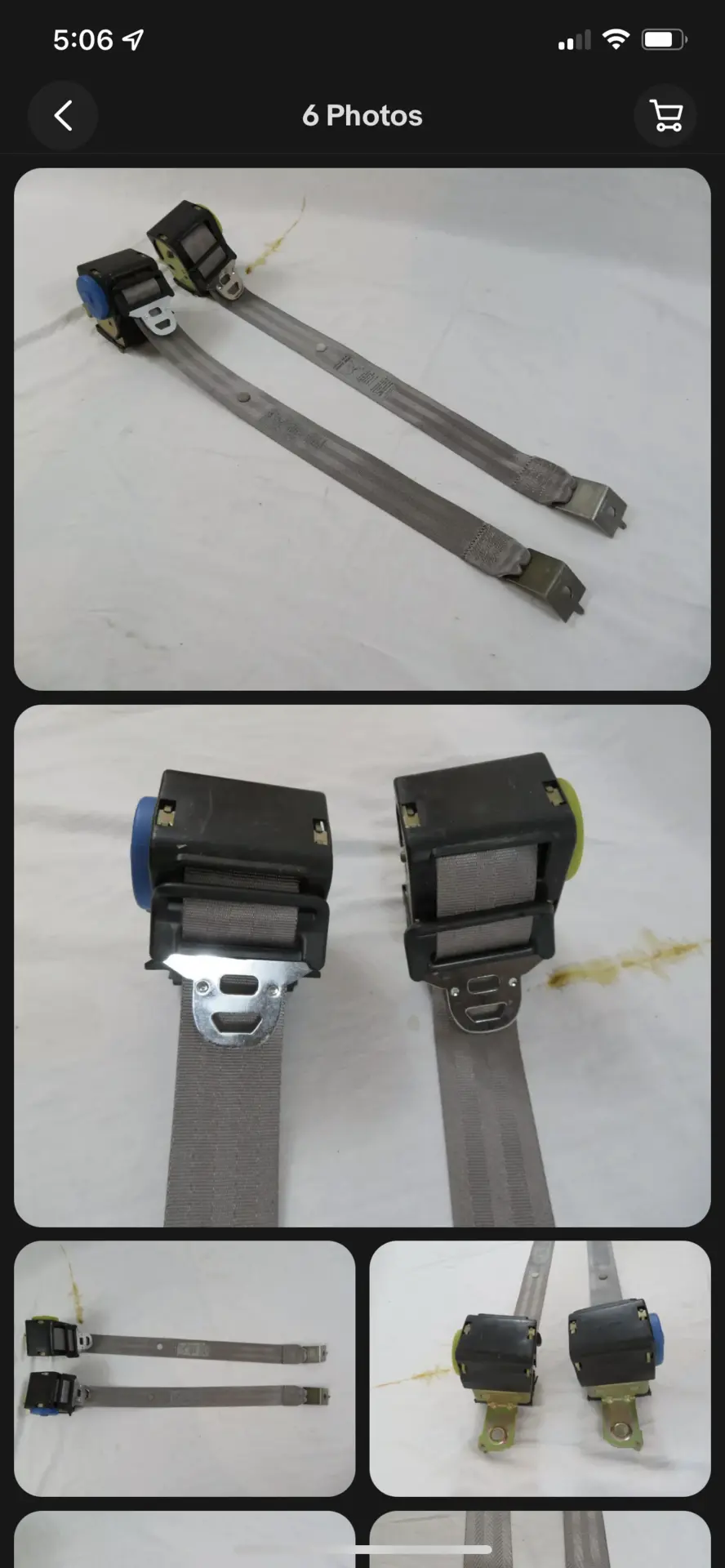

I found safetyrestore.com in my search this morning. I sent them an email to see if they can help me but havent gotten a response yet. I do know that the convertible foxbody Mustangs started out as coupes and the roof was then cut off to make them convertibles. During my used search if that is my only option, can I assume coupe seat belts will work or are the rear seatbelts completely different from coupes and convertibles?
Looks like the convertible rear belts are unique, just like the front ones are as well. My search turned up coupes and hatchbacks sharing the same rear seat belts. Probably because the convertible top forced them to be mounted in different spots. Not to mention the exposed plastic trim around them in the boot area so they look pretty. :rolleyes:
My rear belts are practically like new, but my driver's belt feels worn and looks tired. Thankfully no locking/mechanism problems yet, knock on wood. But I wish I could find a new OEM driver's belt or a place to replace/repair so it feels and looks nicer.
They are completely different for 90-93 due to the fact the coupes have solid structure over the shoulder and the convertibles dont to mount the top point of the 3-point rear belts Coupe belts mount up top on the package tray in front of the rear window, while the convertible belts mount down and go up over the rear seat.
90-93 coupe
90-93 convertible
