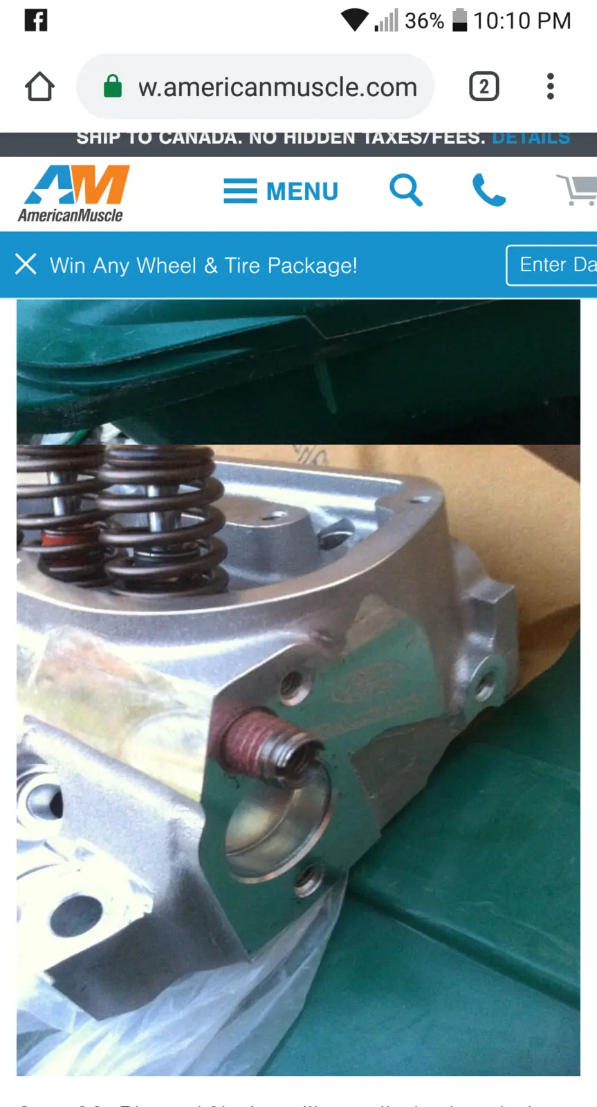

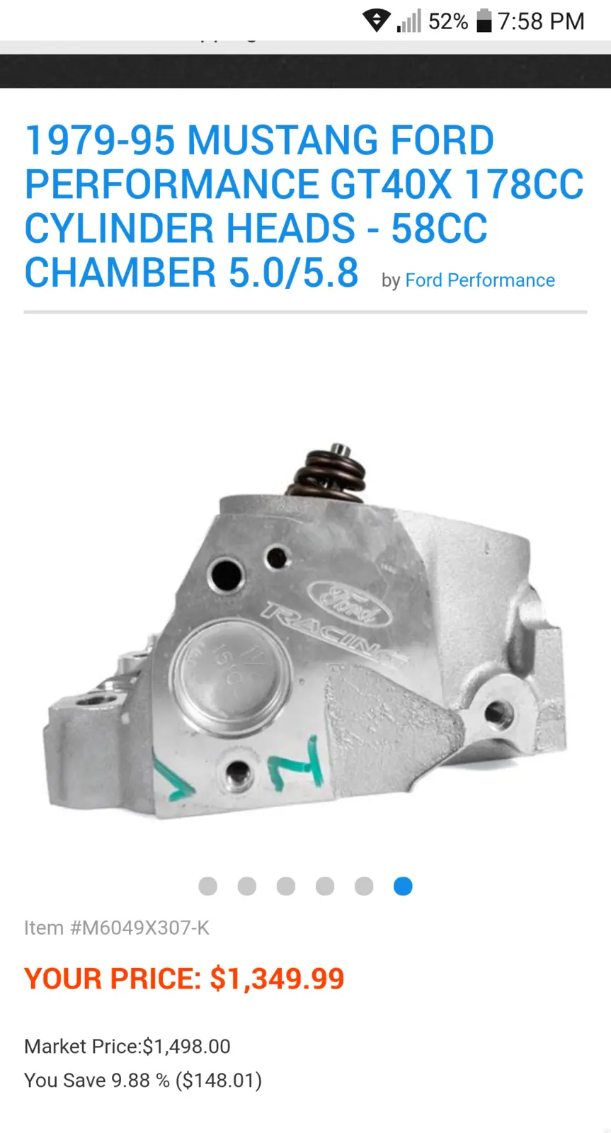

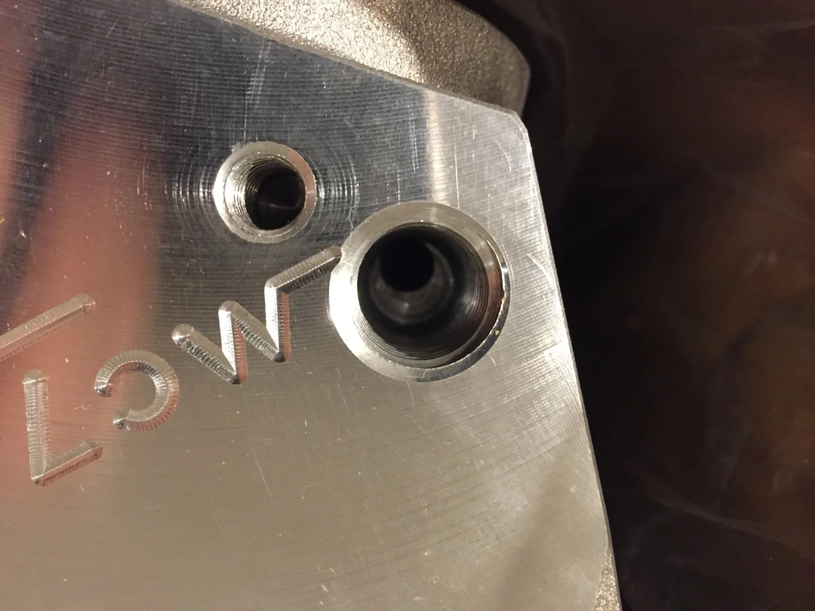

Well so many people aay that the gt40x heads dont have air injection provisions. But every picture i look at shows different.. If the gt40x turbo swirls dont have air injection then why do u need thermactor plugs ??? Also what are the holes on the heads that are in the same spots as the trickflow heads and even e7s?? Lmr says they dont have the holes for the air injection. But every picture ive seens shows different. Im far from blind and to me they look like the thermactor ports for air injection... Can anyone who owns a pair of these heads tell me if those holes are infact the injection holes? And if they arnt then why do u need thermactor screws for them???

The three wholes are for the accessory brackets. Not sure what the smaller whole closes to the valve cover area would be fore but my tfs heads don't have that whole and I wouldn't assume it is injection port.

You would need to actually look in the exhaust ports of the heads and see if they are actually drilled through. The inserts are needed because the heads are machined to be mounted on either side and you need them to install accessories.

Well i kno the trickflow 170s have the air injection and egr. Same with afrs. But ive also seen a set of gt40x heads on a car with the air injection tube attached. Thats why im asking. Im just tryin to figure out on why a thermactor plug is needed if the hole isnt drilled... I duno im just tryin to figure this out cause im in the middle of shopping for heads. And id like to have the gt40xs instead of the afrs or tfs... Im even debating on deleting the tab/tad and just running my diverter valve to my cats and have the air injection vent to atmosphere. Emissions where im from just got scrapped so my build plans have changed..

Also if u look at the two holes next to the valve cover. They are perfect match for the air tube
If you dont have to deal with emissions, just ditch the air pump and related tubes, plug the back of the heads and port on cats if needed. Keep the EGR if you can.

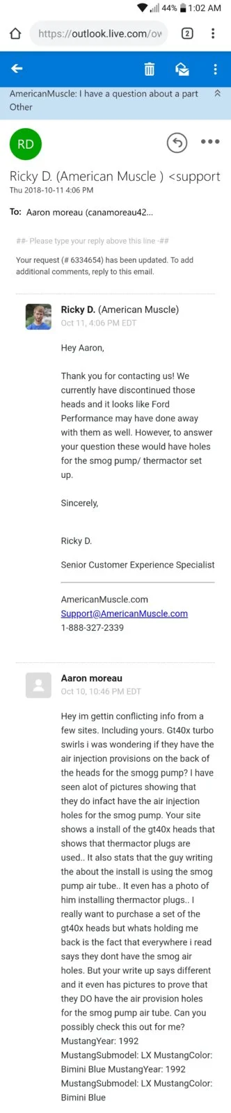

I called lmr. Since they are the only site that sells them. But theyre tech dept is dumb. Thry think a t5 is a m50d lol. And i honestly cant get a straight answer from them

I have a FRPP crate engine with GT40x heads and can confirm that they do have the thermactor air ports on them.
I know this because I assumed they didn't, until I fired it up for the first time and exhaust/smoke was pouring out the back of the heads :doh:
Thankfully I already had plugs in the old engine so I just swapped them over and all was good.

Oh and according to larry at ford performance. The reason that the gt40x heads are labeled as not havin the air injection ports when they clearly do is because ford performance didnt pay to have the "emissions legal" lol. Stupid enviromental protection agency charges head makers to put the CARB sticker on them which classes heads emissions legal.... How dumb is that. Just like the jd power award for cars. Cars dont earn it. The makers purchase that award hahaha

Well according to lmr they have the provisions for egr but not the air tube. And the pictures show the accessory mount holes plus the thermactor air tube holes
