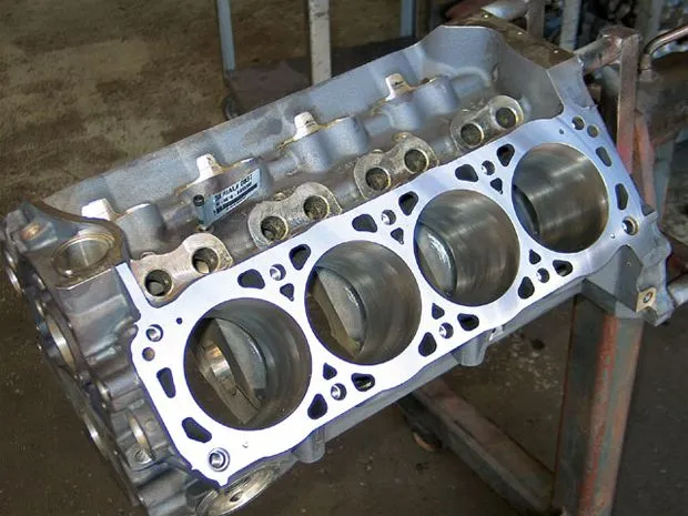

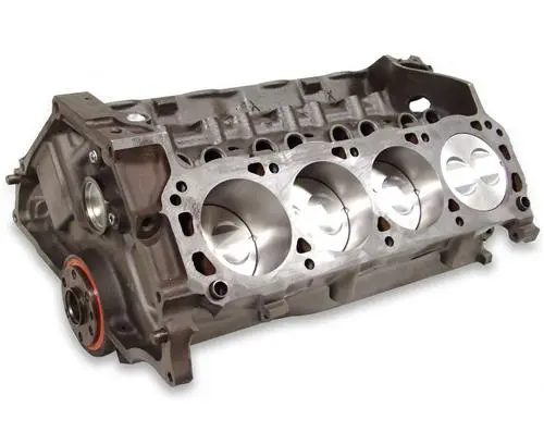

Standard 302 block

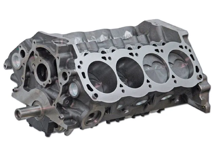

FRPP "Boss" block
Note the additional coolant passages. One upper right, and two at the lower portion of the block compared to the production 302? In the FRPP catalogue, their only footnote states...
