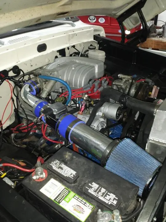

Hi Guys, I'm new here but have been using your site for info for a while. I have a 73 F100 with a 351W with a 93 5.0 EFI system with an AOD and can't ask the truck forum because it got a stang drive train. Here is the question it was run bad so I took it to the Dyno and had it tuned during the run it had a miss though the all rpm ranges. It also would cut out and come right back on. On the way home it got worse and then started to die and i would need to switch the key off and it would restart. So I replaced the Mallory TFI and coil for a new Ford one. After the replacement it now dies and dies and dies... I watched the fuel pressure and it was 39 to 40 psi steady. So any ideas.

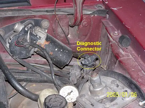

Here's the way to dump the computer codes with only a jumper wire or paper clip and the check engine light, or test light or voltmeter. I’ve used it for years, and it works great. You watch the flashing test lamp or Check Engine Light and count the flashes.
Be sure to turn off the A/C clutch depressed to the floor, and put the transmission in neutral when dumping the codes. Fail to do this and you will generate a code 67 and not be able to dump the Engine Running codes.
Here's how to dump the computer codes with only a jumper wire or paper clip and the check engine light, or test light or voltmeter. I’ve used it for years, and it works great. You watch the flashing test lamp or Check Engine Light and count the flashes.
If your car is an 86-88 stang, you'll have to use the test lamp or voltmeter method. There is no functional check engine light on the 86-88's except possibly the Cali Mass Air cars.

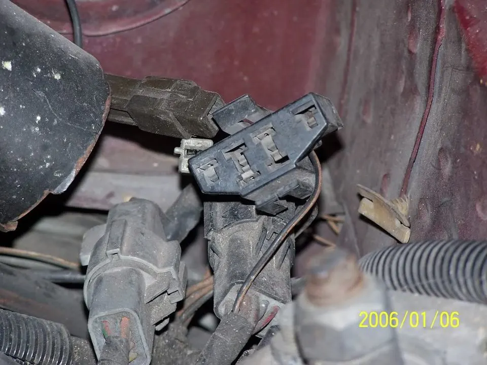

attachment.php
The STI has a gray connector shell and a white/red wire. It comes from the same bundle of wires as the self test connector.
89 through 95 cars have a working Check Engine light. Watch it instead of using a test lamp.

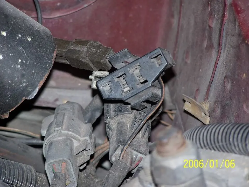

attachment.php
WARNING!!! There is a single dark brown connector with a black/orange wire. It is the 12 volt power to the under the hood light. Do not jumper it to the computer test connector. If you do, you will damage the computer.

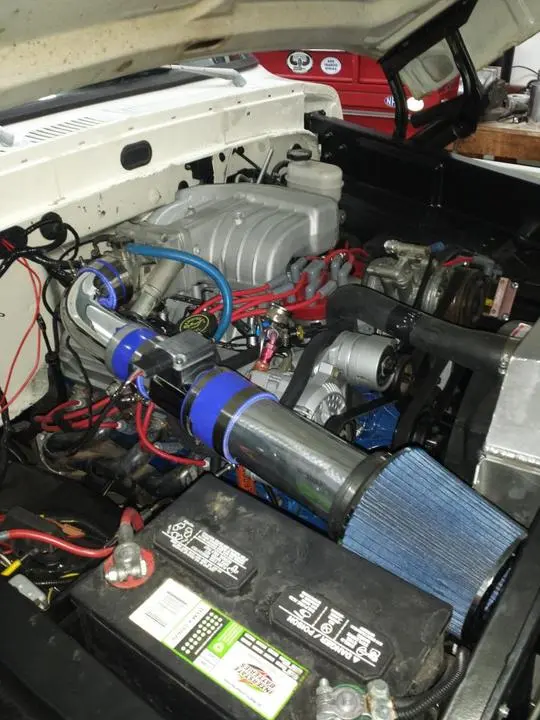

Did you remove the ground battery cable before you did the work? Also did you make sure the distributor was marked before you replace the TFI to make sure the timing would be correct when the new stuff was installed..your timing could be too far advanced.
When it was run on the Dyno the computer was removed so it did lose its ground then and the timing was verified with a timing light 10*.

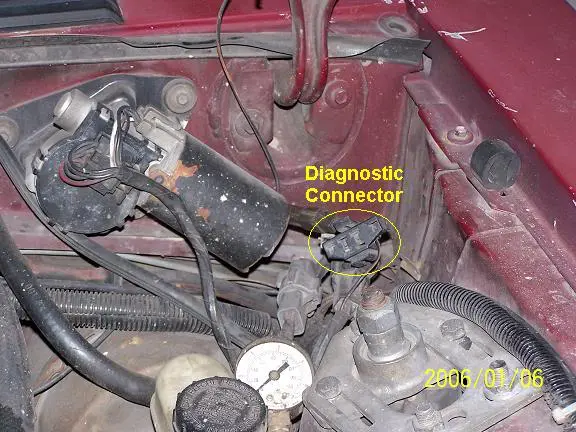

Thanks for the info but it runs smooth now after the TFI it just quits like someone turned the key off.
