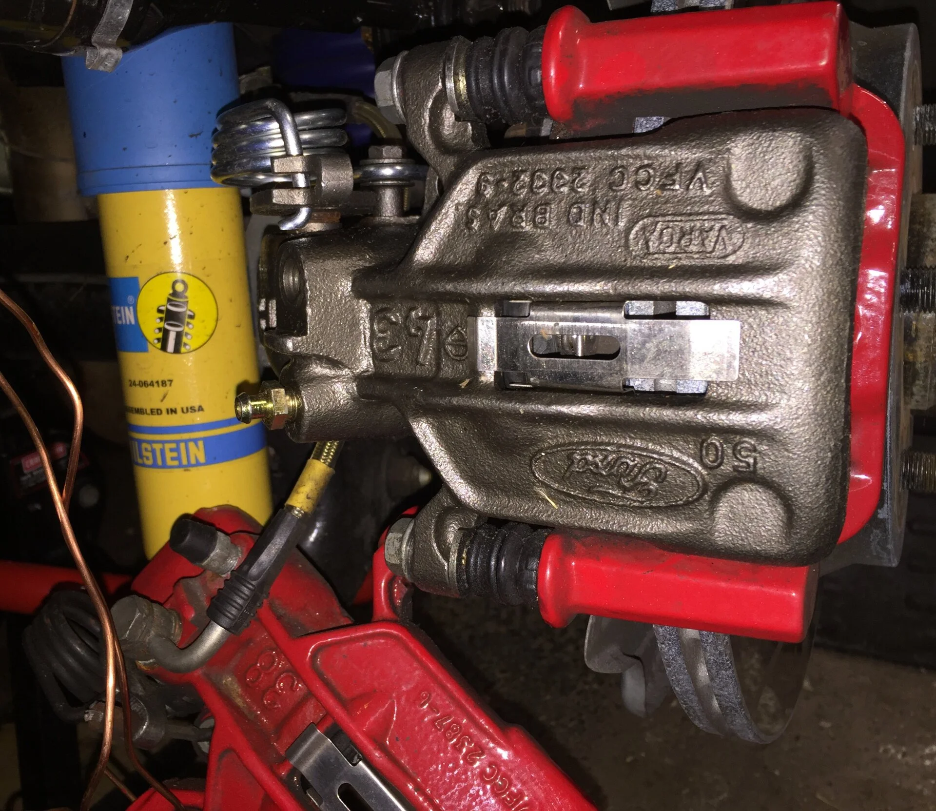

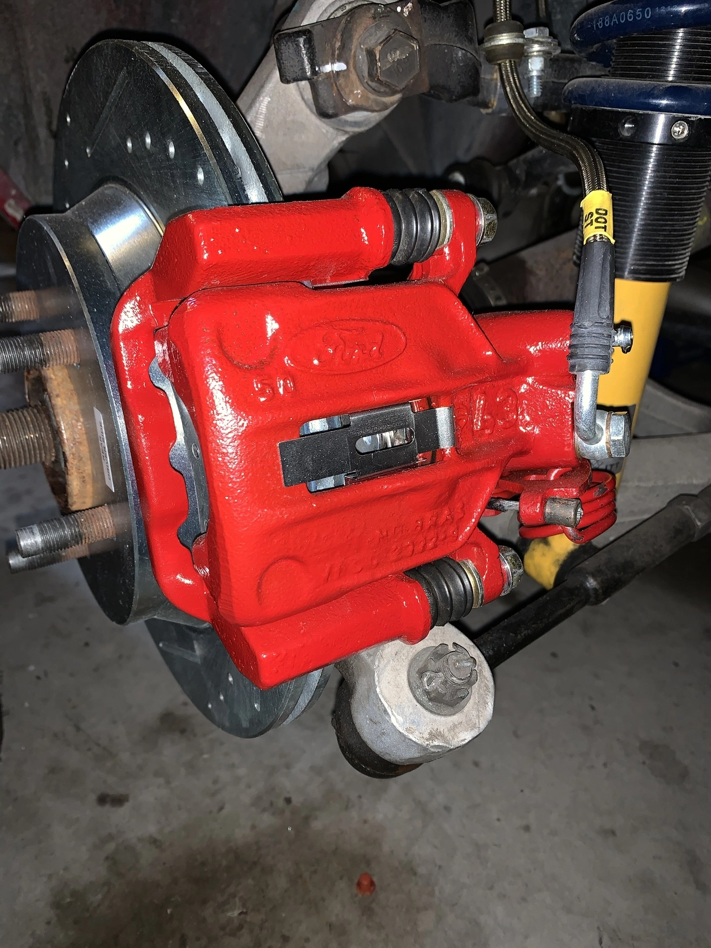

Here's mine on my 04 IRS brackets.

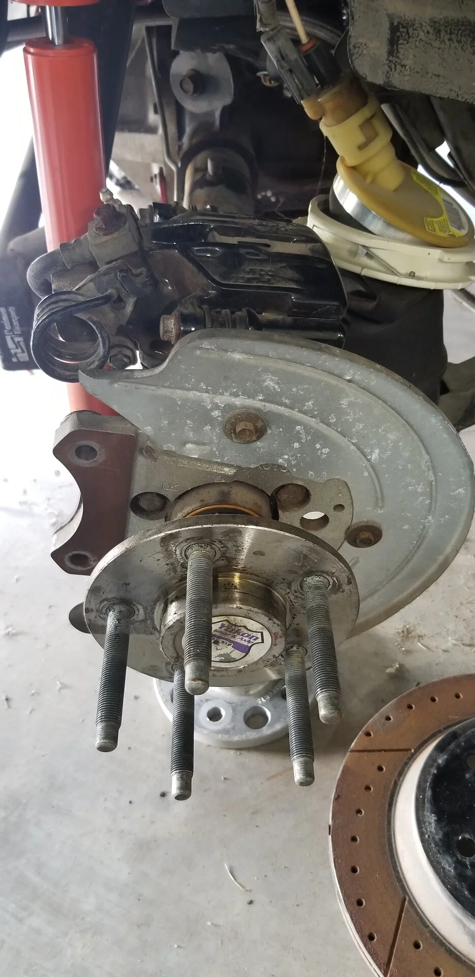

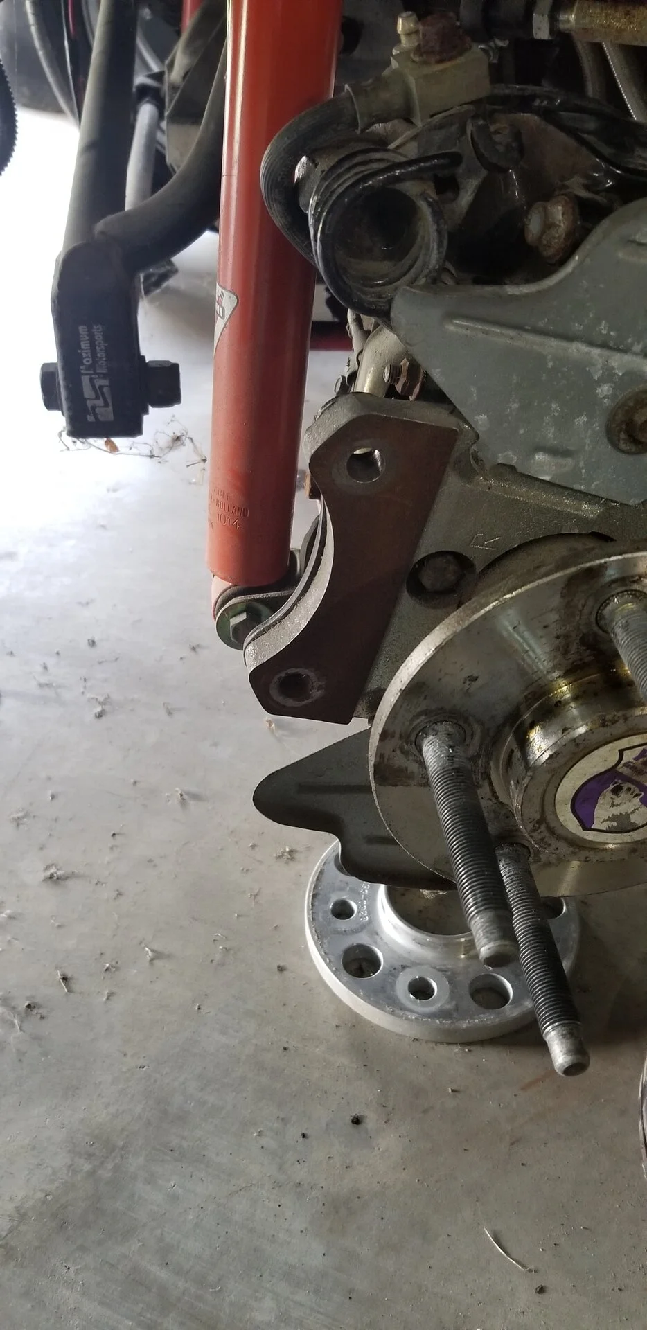

Sorry for the slow reply guys. work and life sideswipe me way too often. Guess that's why this and the others have been 16 year projects. Anyhow, some pics that will hopefully give you guys and idea of what I'm working with.

What’s the bracket on the caliper look like that’s holds the pads? I was using the mustang bracket, but putting the 43mm caliper in that.
if you are using the Taurus pad bracket, that might be the reason why.

Yes, I am usiing the SN95 bracket. When it comes to comparing the holes on both brackets the Taurus unit is further spaced apart. I have gone back to O'Reily's and compared other Taurus units, and it's the same. Not sure why. I ordered the exact same parts from the list in you guys threads.
