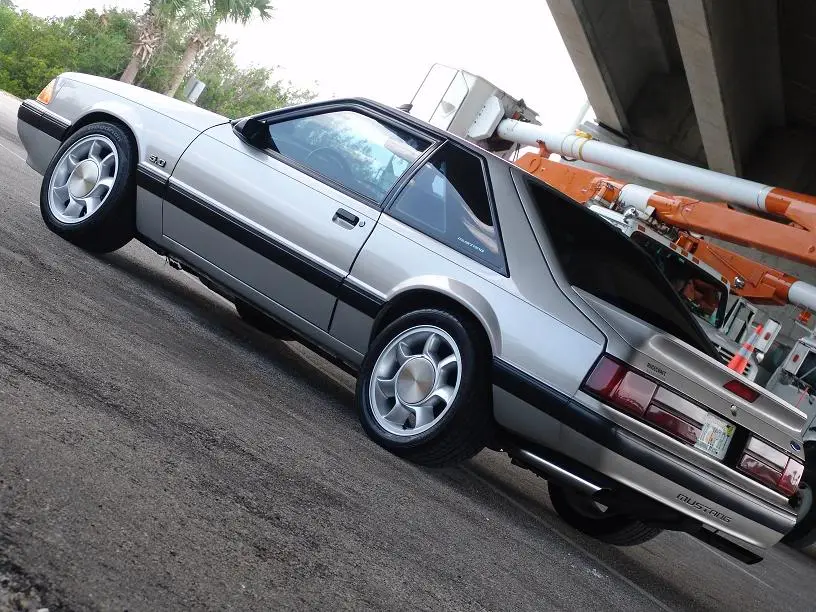

first, does anyone have any pics of the silver 93 cobra turbine 7 bladed wheels on a convertible LX or 86 or older GT? I cant find any....
secondly, has anyone used these on a 79-93 mustang? how is the fitment? what tire size are you running? any interference issues?
My car is an 86 GT convertible with 87 front brake upgrade
thanks!
any LX pics with these wheels would be appreciated!

I have them on my '90 LX... I love them! I run 275/40s in the back and 245/45s in the front. The front wheels hit the control arms when at full lock and going up a steep incline... And the rears I had to take off the quad shocks and massage the inner fender on the passenger side, but no more rubs at all.
