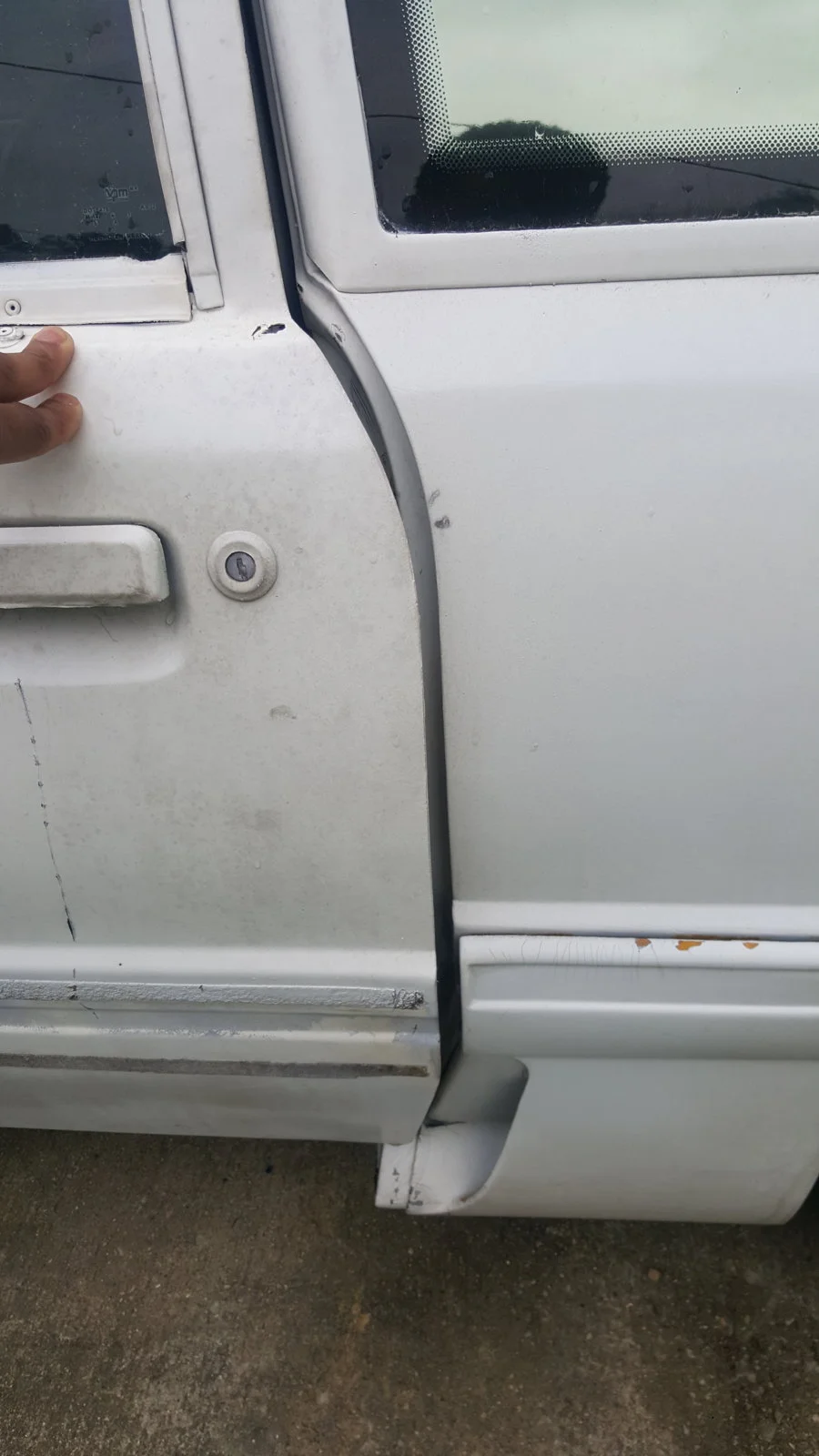

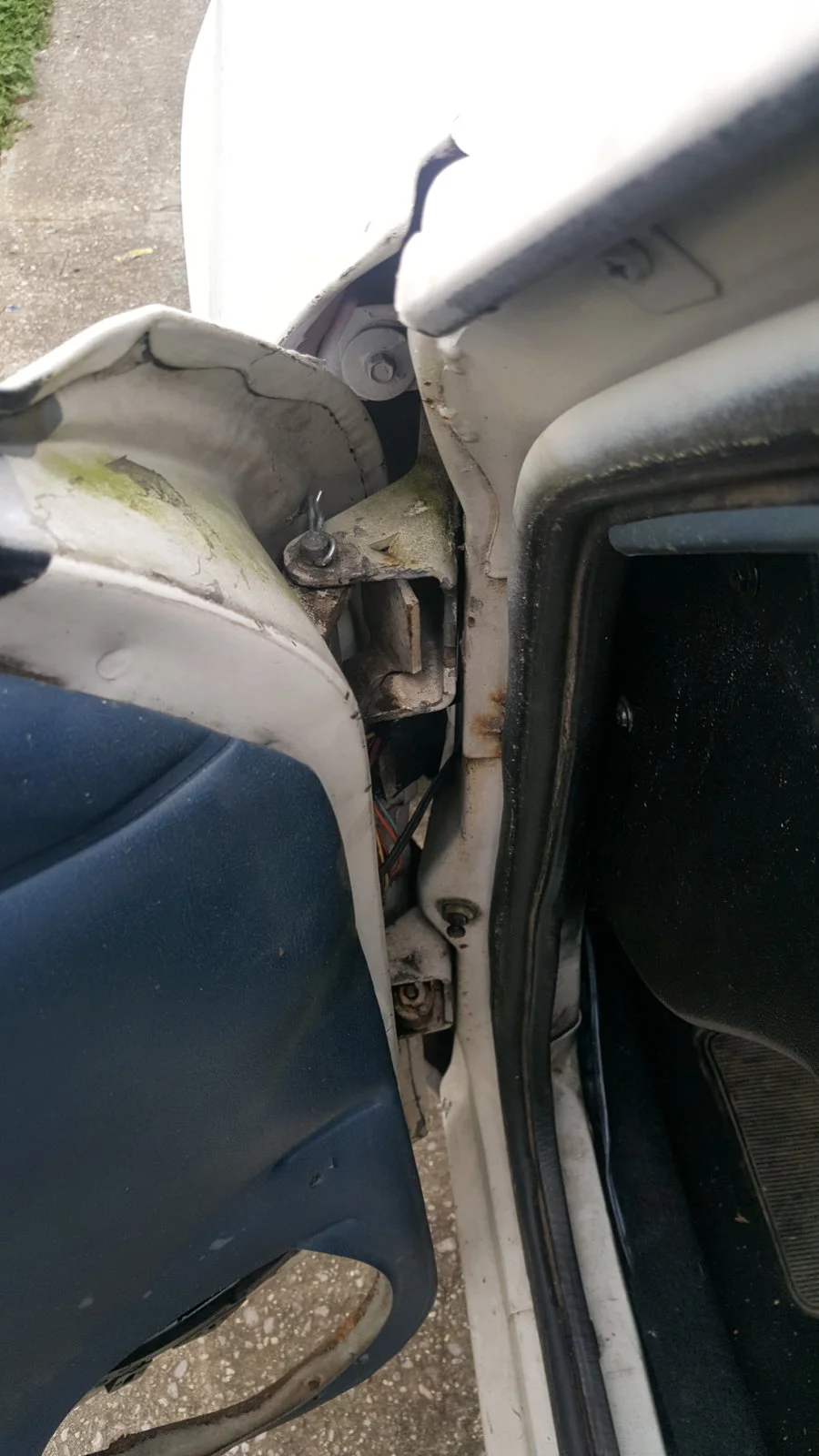

Here's the pics sag is very noticeble

If the actual hinge pieces themselves aren’t moving, then the holes where the bushings go in are wallowed out.
Depending on how bad they are you might just need that hinge pin set I posted above or, if they have become elongated, you might need new hinges.
Still, a fairly easy fix.
This picture looks like the hinges aren’t bolted to the car tightly. I see a gap between hinge and body. I’d check that if it were mine.
